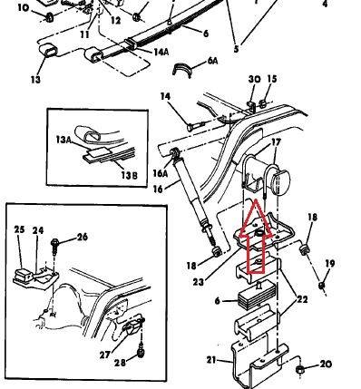

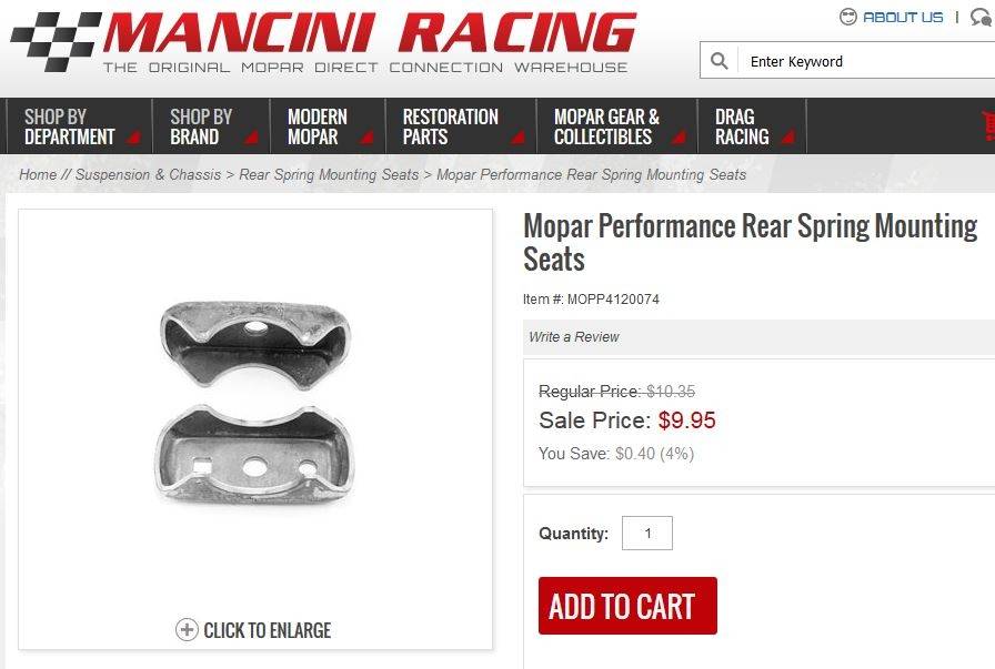

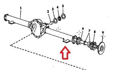

    Most Chrysler rear wheel drive cars, the perch is on bottom of housing. Most pickups and Jeeps the perch is on top of the housing – for more ground clearance.
    The perches are clocked to the differential yoke. If they are welded on wrong, one can get angled shims to correct the pinion (yoke) angle.
    Perch.JPG This company calls it a Mounting Seat.
    Did that answer your question?

    I'll get those measurements..I've not seen any concrete swap info yet, so whatever I can do to help I would like to be a part of. All I've seen is the perches needed flipped..I didnt know you could buy new ones though..let alone for so cheap.

    For $10-15, it is not even worth saving them.
