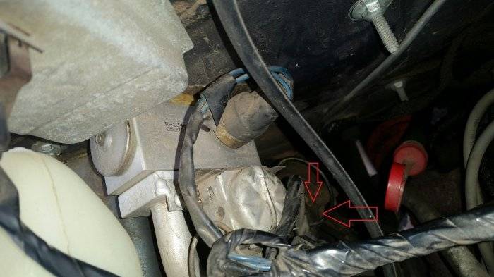

I “believe” all ’80 through ’89 FMJ’s ignition coils are located on the passenger side rear corner of engine compartment, just above the frame rail.
I used two red arrows, sense part was dirty/oily when picture was taken and it's kinda hard to see – but both arrows point to same item (ign coil).
NOTE: Do not touch an ignition coil during or shortly after engine turn off! It will be hot – too hot to touch! 150’ F or hotter (my guess – not measured one to find out).
There is also a small chance of a (voltage) shock.

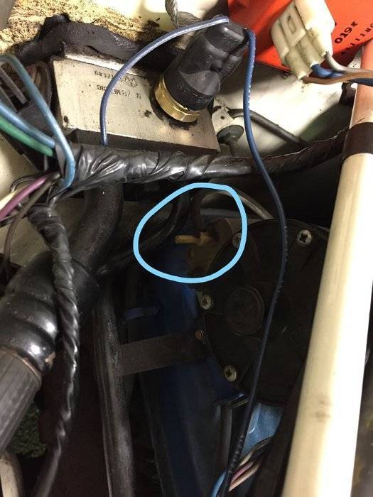

A small question: on the side of the vacuum amplifier is this pipe sticking out - see picture.
Is this supposed to be open, blocked or connected to something ? I can´t see any loose tubing anywhere.
The “missing vacuum hose” is not what you think it is.
That is the “vacuum exit” for an electric solenoid. The Lean Burn/SCC controls the EGR valve on your car, and in this case, that solenoid is what the Lean Burn uses to turn EGR on/off. What appears to be a vacuum hose nipple is actually where an approximately ½" x ½" (13mm) square piece of open-cell gray foam is, to use as a mini air filter. The foam is nice to have but is not required. If Lean Burn/SCC is removed, then that solenoid will be disabled (as well as EGR) so it won’t matter anymore.
My opinion – don’t worry about it.
