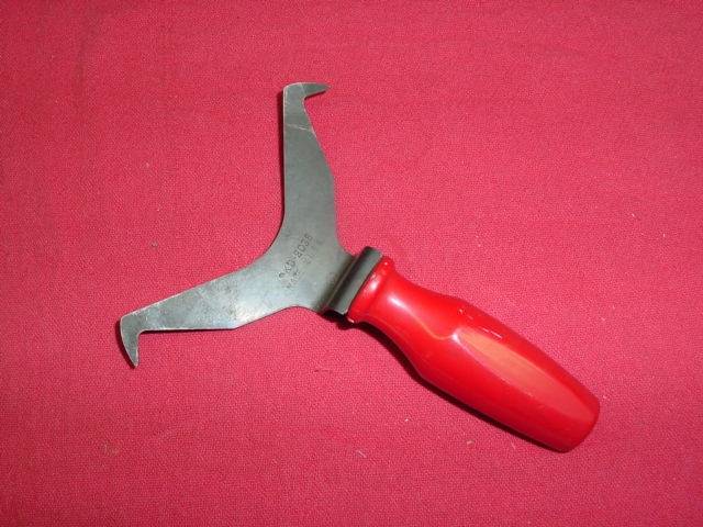

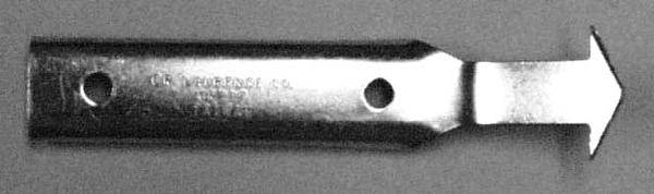

Here is a couple of examples of windshield trim tools. There are other examples out there as well.
