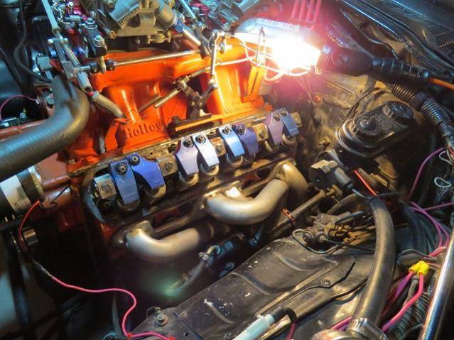

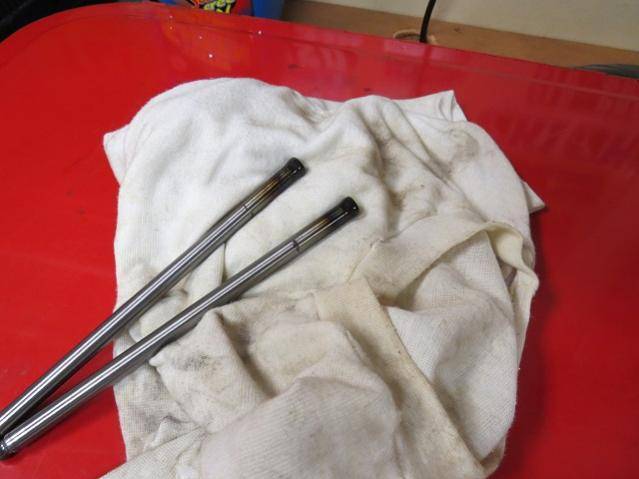

out of curiosity I decided to check my valve lash this morning. it sounded a little off the other day. good thing I checked. 2 pushrods had blue tips and valve lash moved a bit. replaced the pushrods and put new adjusters in the rockers.
I think I know what cause this. no oil on cold starts. it sat for 1 month. I usually pull the valve covers and squirt oil on the push rods but this time I didn't and it cost me.

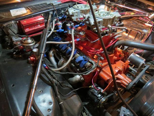

it's back together and next week it's drag time!
