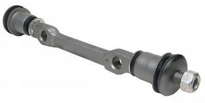

    Who has made use of this kit to compensate for excess negative camber that cannot be adjusted out? Anyone? Were results desireable? Any sources for the kits other than Rare Parts?

    If your shaft isnt rusted out or wore out,
    Then you could just put new upper control arm bushing on your shaft.
    while the control arm is off.

    I did that & then some! But, while only a few degrees, my camber couldn't be adjusted any closer. I used urethane bushings, & other than the shafts, control arms, & centerlink, the entire steering was replaced. No accident damage, the shafts are merely at the end of their travel. Luckily I always get lifetime alignments, so those look like they'd give me the needed adjustment. Moog offers adjustable upper ball joints for other Chrysler vehicles w/o adjustable upper wishbones. This looks like a better solution.

    Rare Parts & RockAuto websites said the parts weren't available. AutoZone said that part # is for a sway bar end link. Are you positive on that part #?

    Yes, I am positive on the part number. The shaft in the package is an offset design. It seems to be an item no longer available from Moog. At least until they decide to make another production run of them. I have had inquiries out for some for a while. Incredibly, I just got some brought to me. Some guy had found some in a load of old parts he had acquired. I am elated because my car needs them for correction of an alignment problem.

    Found what appears to be a TRW version. Item #220712292101

    Moog #K7190 or MevoTech #MK7195 will get you offset bushings that go on the OE shafts. Don't expect the shafts to be reintroduced; the bushings essentially replaced them.

    Does that TRW part look like it? It lists our year cars. At $79+ shipping a side, it's still cheaper than tires! Not to mention that the alignment would be spot on!

    They look almost identical to the Moog units, except for finish. Wish I'd known about those before I buttoned it up! Goes against my credo; " Do it once, do it right, weld the hood close!"

    Why do you think these are offset bushings?

    This item fits B and R bodies 1973 and up. Looks the same but has different dimensions.

    Whoops, my bad. The MevoTech number is actually for the lower bushing.
    Standard Moogs are K7084s. K7190s are the Problem Solver bushings. The Problem Solvers are offset for exactly the reason the offset shafts existed.

    If you examine the K7190 bushings, I think you will find they are not offset.
