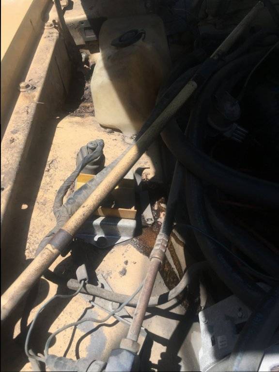

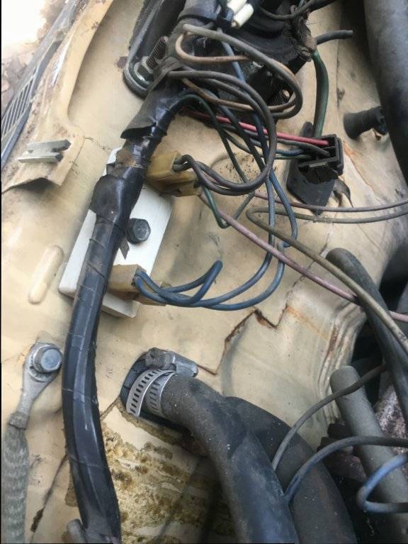

    That's the ceramic rectangle on the firewall, yes? If so, I had a spare in the glove box and that didn't work either. Thanks though!
    --- Post updated ---
    this little guy?
    I had to do that once before. Is it supposed to melt the wax to the inside of the car???

    I can’t see the pictures, at work (for some reason).
    The ICU and voltage regulator (and few other “electrical modules") have a steel outer case and has epoxy on backside of it.
    I have seen two reasons for the epoxy to melt out.
    A) environmental reasons (ie: temperature) (the more common reason I found).
    B) part overheated electrical wise, which melted the epoxy out.
    Generally if one of these modules fails electrically wise, it will not melt out the epoxy.
    I have seen modules with the gooey sticky like stuff (epoxy) melted out that still worked fine. BTW, that “stuff” is a bear to clean up afterwards.
    Eauledoit11 likes this.

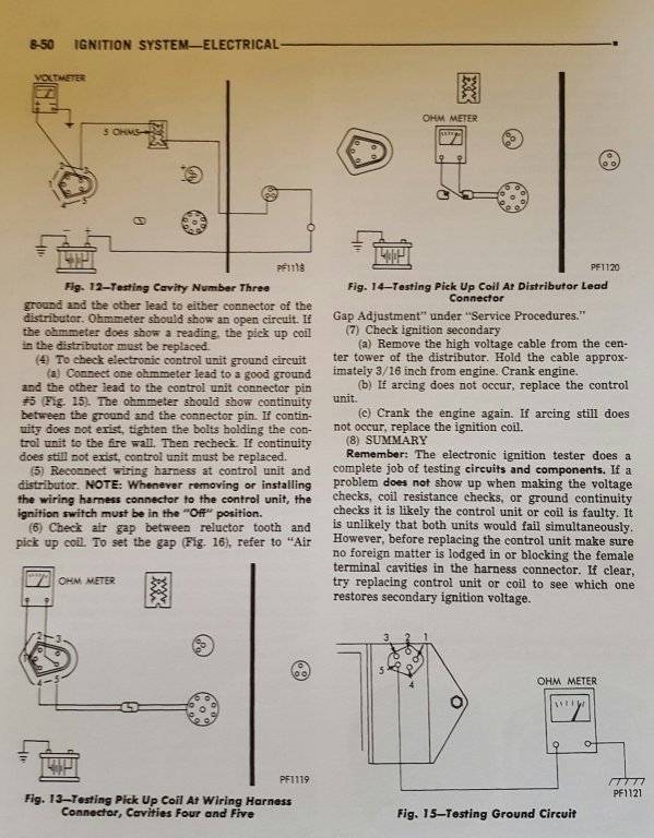

    Here's some reading material just for fun. (click on the pics to make them larger)

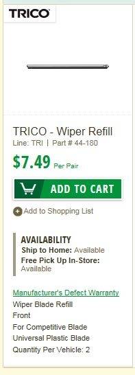

    Wiper Refill

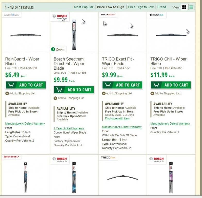

    Wiper blades (13 to choose from)
    Tip,
    Anytime I go to an auto parts store, O’Reilly (which is where I took these pictures from). AutoZone, Advance, etc., I always go to their web site first.
    In this case it is List: Wiper Blade - 1984 Plymouth Gran Fury | O'Reilly Auto Parts
    It tells me if they have it in stock and I have the part number(s) in hand – which means I can get out of there 10 times quicker (also it increases the likelihood I get the correct part).
    Edit: I got the year and car wrong - but wiper parts didn't change.
