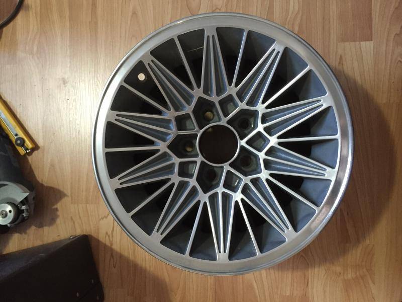

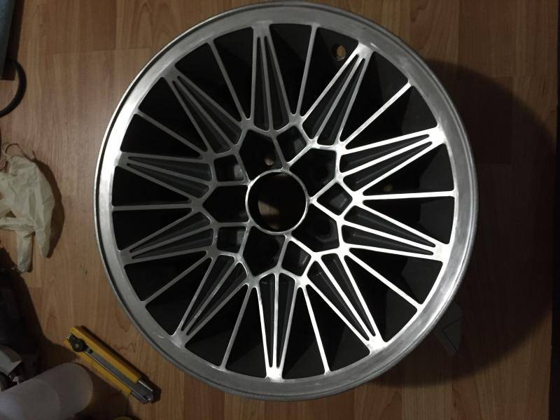

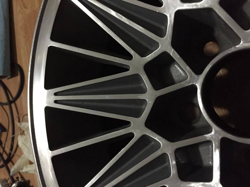

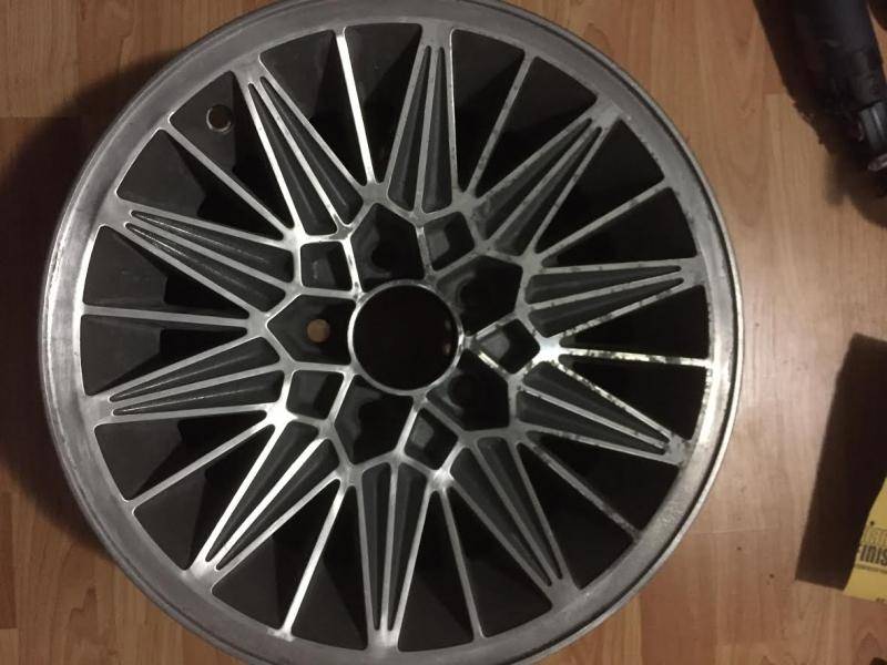

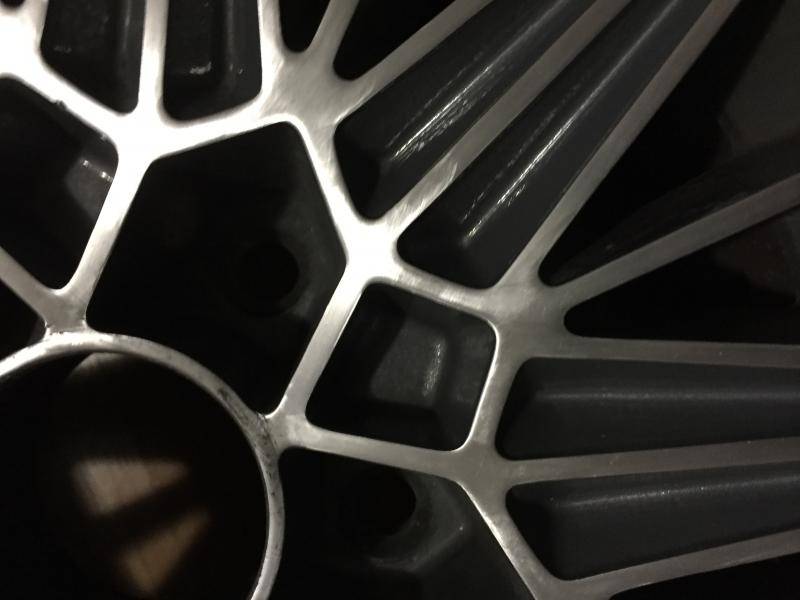

Meanwhile, I have started the polishing process on a set of Snowflake wheels that I also own. What I want to do is to polish out the 'ribs" or edges only, leaving the original dark grey paint in place. As background, I got a set of 4 wheels locally (off of Kijiji, the Canadian equivalent of Craigslist) for $150. They were cheap because the owner didn't have any centers (which I have subsequently bought ) and the clear coat was in really bad shape.

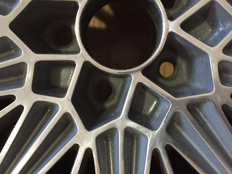

The wheel looks like this right now (about half is polished outm should be obvious):
A close up of the polished edges and the way they looked before the sanding out:
This will take longer to do than the 5 on 5s. I cannot use the crushed glass abrasive blasting process on this wheel due to how narrow the edges are, and I actually want to keep the original paint intact. So I have begun to sand the edges out using 320 grit wet/dry sand paper. The 320 seem to be a good comprimise between speed, and keeping the sanding scratches from being too deep.
The edges are really complex, they are NOT flat from the rim edge/flange to the center hole (a broak flatish curve actually) and the points where the spokes meet are also not flat, they are sort of depressed in the middle, futher making the sanding process more difficult.
P.S. I now see what JasperJacko was talking about regarding getting the machining marks out. The crushed glass abrasive blasting process eliminated the machining marks, so I only noticed them on the narrow 5 on 5 spokes. There are a lot of machining marks on the edges, and they take some time and effort to get rid of.
I have posted some pictures of the 5 on 5 wheels that I have started to clean up and polish out in a previous post. That is on-going, and I will finish the 5 on 5 that I have started, but I am awaiting the arrival of some Micro-Mesh sanding pads before I can continue to work out my process.

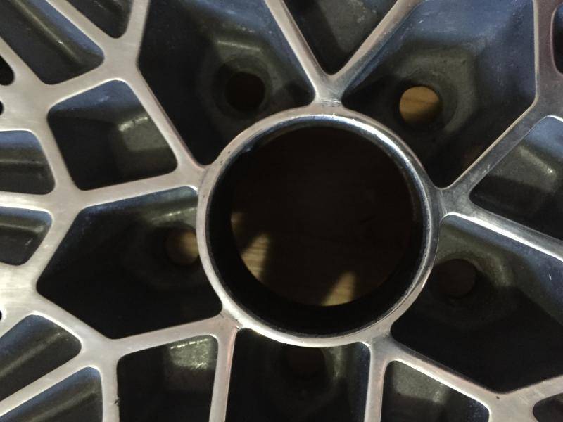

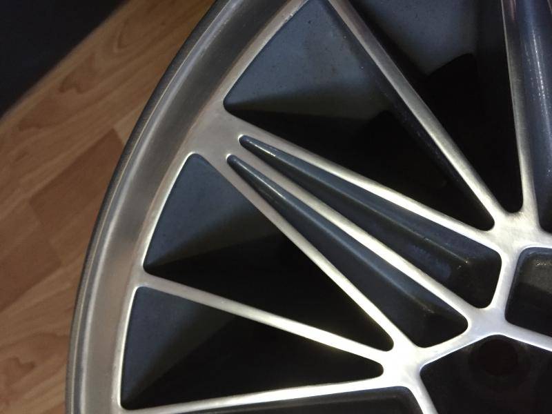

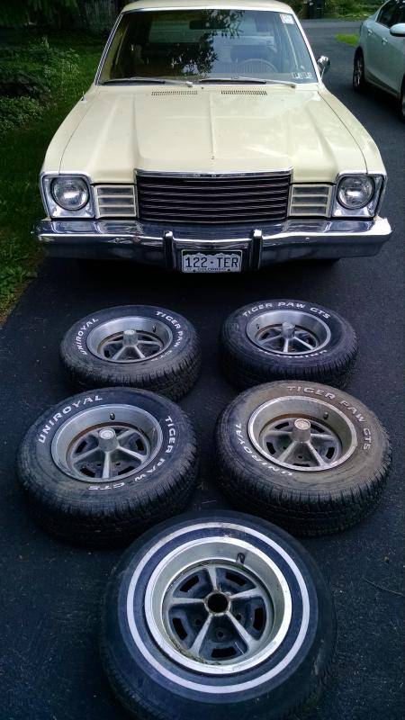

Wow! That is really impressive! At some point I have to figure out how to restore my wagons Road Wheels. For now, they are just cleaned up from when I bought them, but still pretty decent. I guess the aluminum wheels would be easier to work than the chrome and steel.

Update:

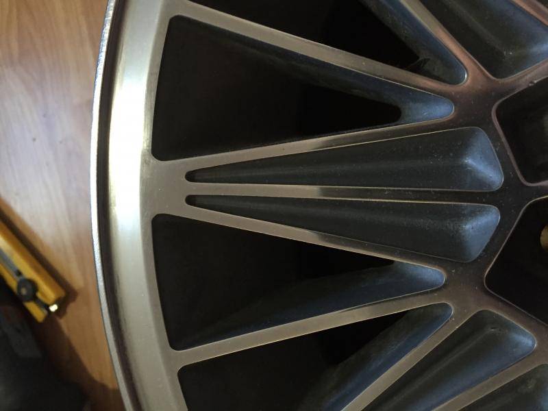

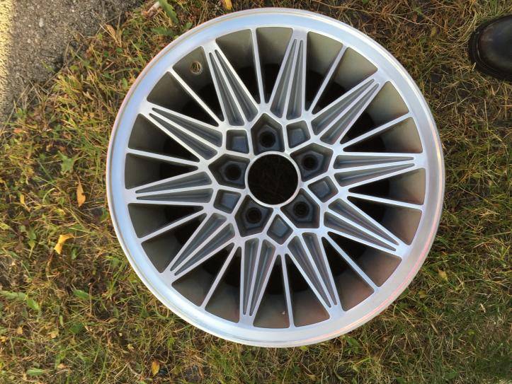

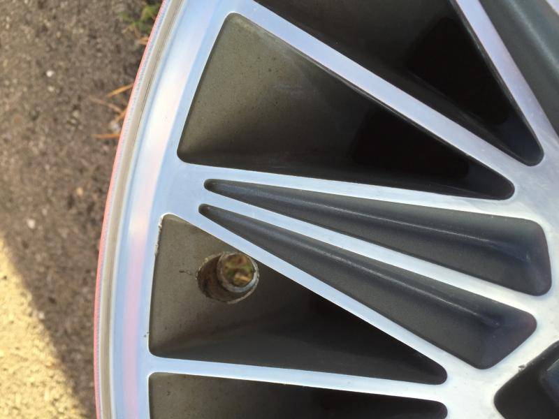

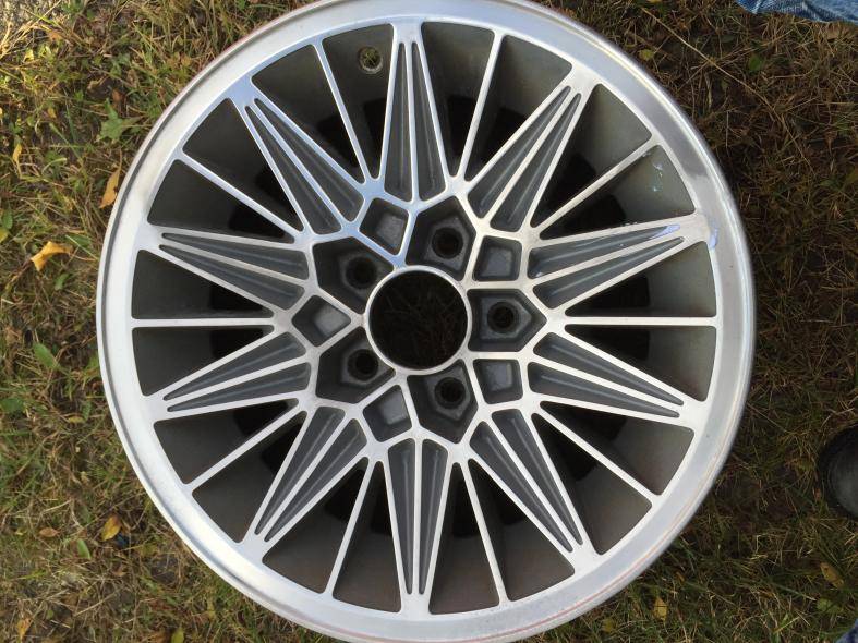

Just finished the first wheel to 320 grit. The original wheels looked like this:

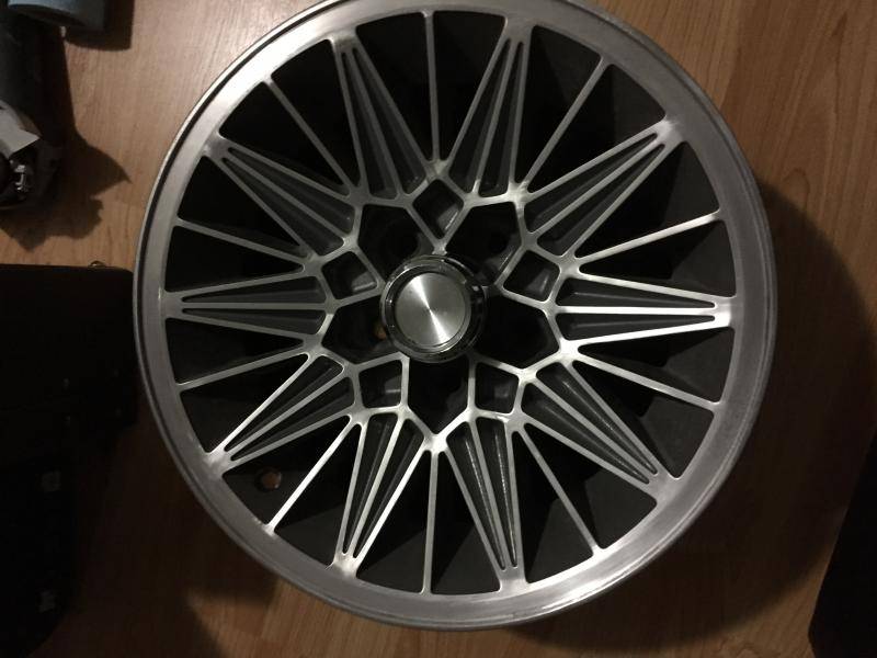

The sanded wheel looks like this:
The sanded wheel with its center cap:
The original wheel picture (first pictue) is not the same wheel, but another wheel of the same set. What looks like road tar is actually dirt build up underneath the clear coat. The original finish is probably shinier, as the exposed mahining marks and clear coat probably looked really good when new. The sanded wheel looks duller right now because it is only sanded to 320 grit. The intent is to take it to 1000 grit, at least. I don't know about taking it higer than that, as the edges/ribs have a very small area, so getting them to a mirror finish may not be a good use of my time, considering the minimal end result improvement.
I have about 10-11 hours of work into the wheel at this point.

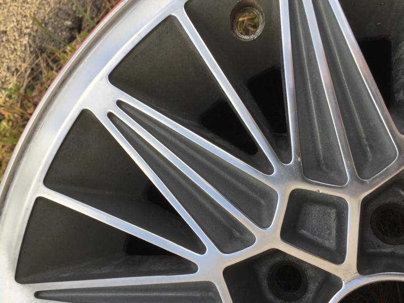

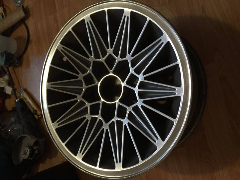

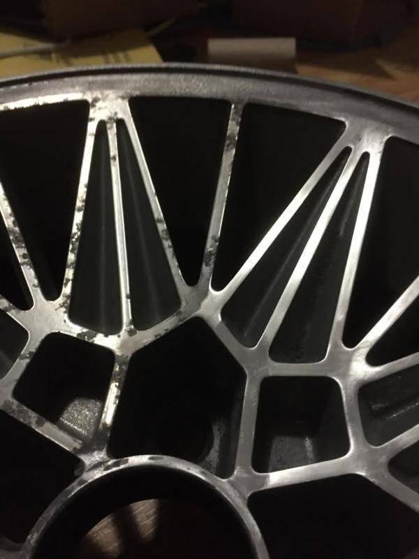

This is the same wheel as above, taken to 1000 grit:
Close of where the edges meet, you can sort of make out some of the concave shape:

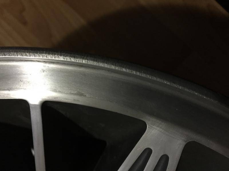

Close up of some of the defects that I found as I went along. I don't think I can take them out without seriously affecting the shape of the area, so I am going to leave them. The rolled outside edge was curbed at some time, and it is chewed up; I will be leaving it as well.
And a closeup of some of the edges:
This is about 16-17 hours of work. As suspected, it goes much faster after the machining marks are removed. After the machining marks are gone, it only takes about an hour to do a wheel completely with the next grit of sand paper.
This wheel design has a lot of facets. It is impossible to sand it out to have all of the facets at exactly the right angle to make it uniform. Wheel looks much better than original, and I am glad that I took the time.

Take a file to the curb rash and blend it with the rest of the wheel.
1,961
419
I don't want to to that, the depth of the curb rash would require a lot of metal removal, and I am not comfortable with that. There are also a few other places in which there are nicks and slight gouges, so the wheel isn't going to be perfect anyway, unless I can find a way to add metal back so that they become invisible. The wheels are most likely over 25 years old, and came by thier nicks, scrapes, gouges and curb rash from use, so I just have to live with that. Niether the wheels, or the car they are going on are ever going to be perfect; I just wanted them to look nice.

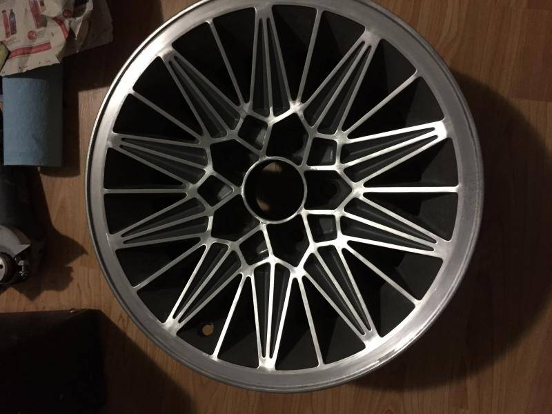

To complete this, as I did for the 5 on 5s:
Started with this (same 1000 grit as before, after washing with the Flitz Aluminum Pre-Cleaner: (just on grass):
Same status, close up of the three edge spoke:
Polishing process (Flitz Polish and Flitz Buff Ball) begins. Partially polished out:
A close up:
Polished out:
A few close ups. Looks like I ran into the 10 images per post limit.
1,961
419
A few more notes, some of which carry on from the 5 on 5 postingL
1. The snowflake wheel was only polished out to 1000 grit. No Micro-Mesh, yet the end result is identical in terms of shine and overall look. Looks like I can skip all the Micro-Mesh steps, a time and money saver.
2. Sorry about the quality of the pictures, but I am having a hard time getting the shine of the aluminum to show up in the pictures. Best reference I can make, from something that is familiar would be to say that the wheels are now about as shiny as a sheet of aluminum foil, shiny side. The colour is a little bit different, but the level of gloss is the same.
3. When removing the Flitz Polish, it is improtant to keep your polishing cloth really clean. Any polish on the cloth easity transfers onto the part you just finished wiping off, so you have to go back and do it again.
4. When you finish going over an area with the Buff Ball, the area looks really dull and grey. You will only see the real shine after you wipe off the polish residue.
5. Flitz advises that you need a drill with 2000 rpm for optimal results. My drill only goes to 1300 rpm. Results look fine to me.
