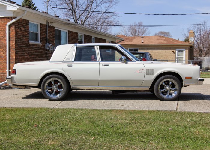

    This thread is just a chronicle of the car thus far (going to be photo intensive)...
    Here is my 1987 Fifth Avenue. I bought the car my junior year of high school and couldn't tell you the difference between a header and head when I got it. Interest in the hobby only grew after my buddy's father gave me a 360 to take apart and rebuild. Mods started out small with your typical 4bbl swap and carried on with an axle swap, two transmissions and four motors - learning a bit more with each step.
    As it sits right now:

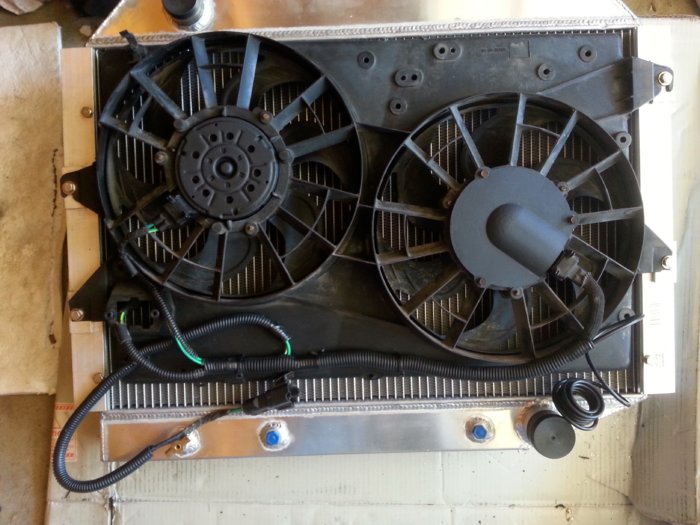

      • Ford Contour V6 electric fans
      • Dakota Digital two speed fan controller

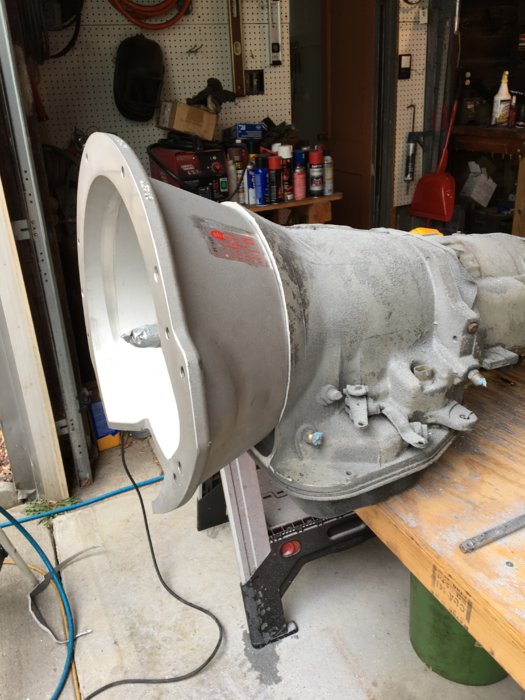

    • Transmission
      • 518 over drive
      • Ultrabell conversion bell housing

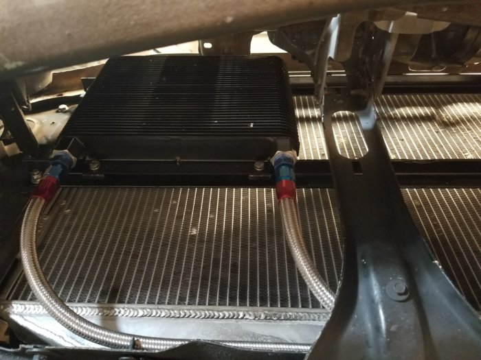

      • MP cast aluminum deep pan
      • Turbo Action 17809ST converter
      • Shift kit

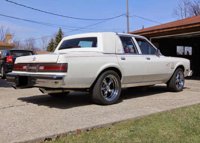

      • Front: Nitto 555 255-45-18 on an 8" rim
      • Rear: Nitto 555 285-40-18 on a 9" rim
      • Wheels: American Racing Torque Thrust VN515

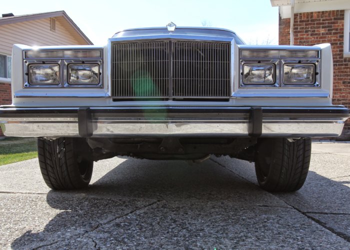

    Notes:

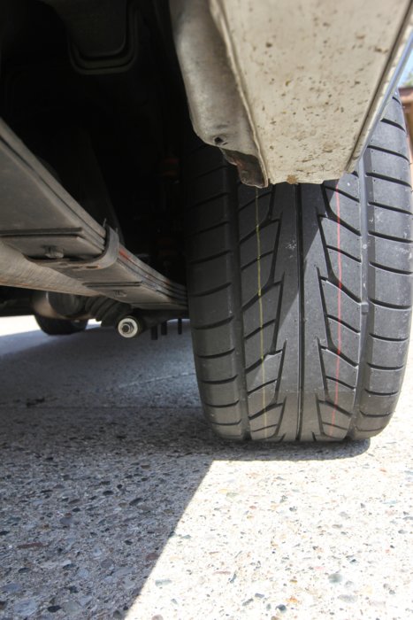

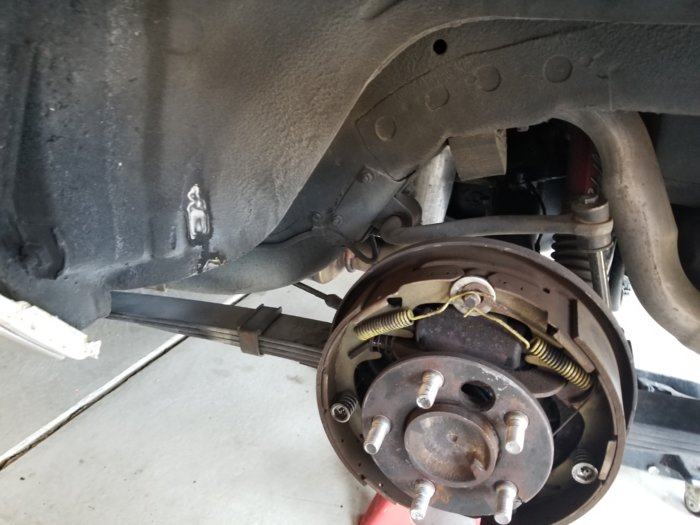

    I do have to go to a slightly smaller tire in the front and rear. The fronts will rub on the K frame and torsion bars at full lock and the rears rub slightly on the inside fender wells towards the front. Will be going to 245-40-18 on the front and 275-40-18 on the rear when it comes time to replace the tires.
    The car handles well, but I noticed a difference from going SB to BB with the additional weight on the nose. Will be upping the sway bar size to 1.25" front and 1.0" rear when the budget allows.

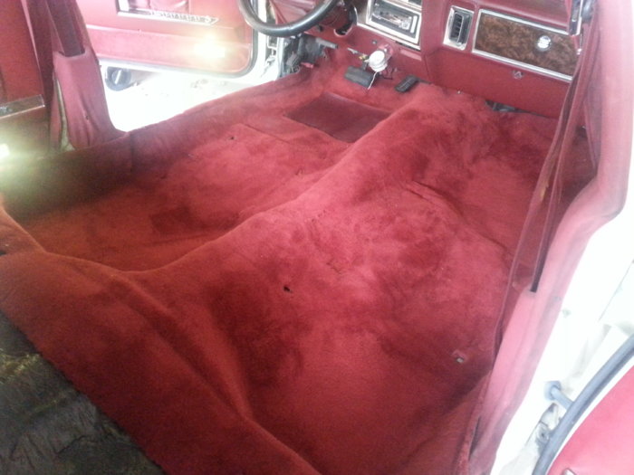

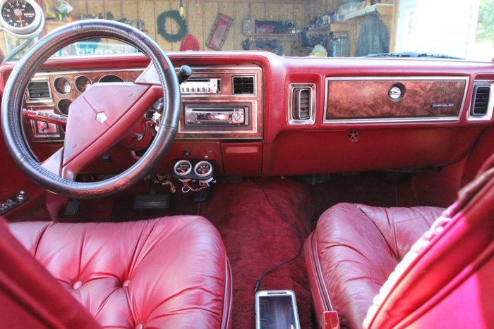

    The overhead console in the interior was pulled from an '89 car. Also hooked up the temp sensor. Wasn't hard to do and I added an auto dimming mirror at the same time.

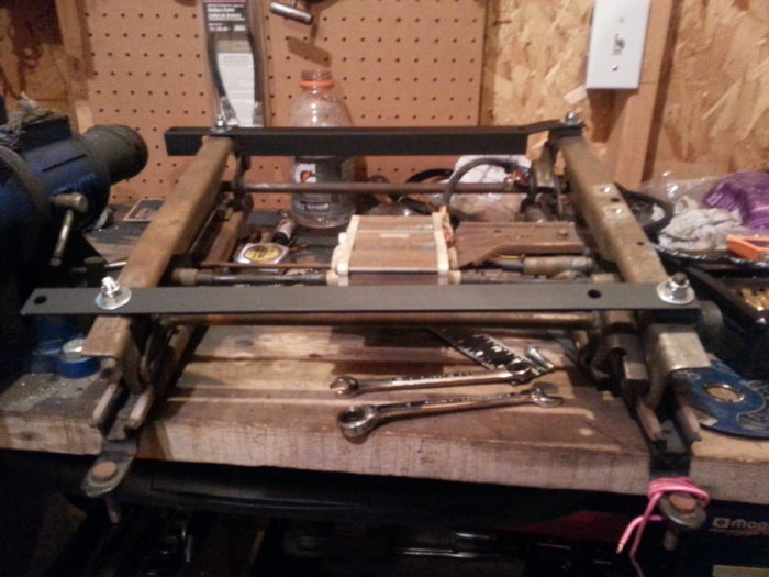

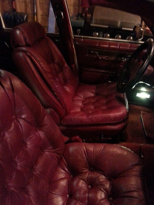

    The driver's seat is actually a passenger seat from another red leather Fifth that I adapted the rails to. It will actually bolt to the driver's power bracket, but sits too far over to the left and will hit the B pillar. Made brackets out of angle iron to shift the seat two inches.

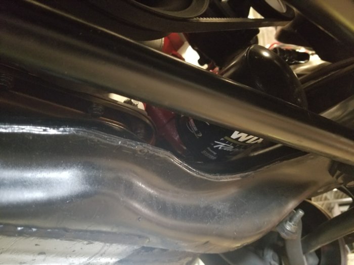

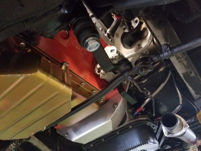

    The K frame needed a lot of clearancing for stuff to fit. Once the driver's tower was modified per the motor mount instructions the gusset on the driver's tower needed trimming to make room for the oil pump and filter. When test fitting your motor be sure to do so with the filter in place.
    Where the firewall meets the floor pan there is a considerable lip that can interfere with bell housing bolt access. Slice this in three or more spots and pound it flush with the pan.

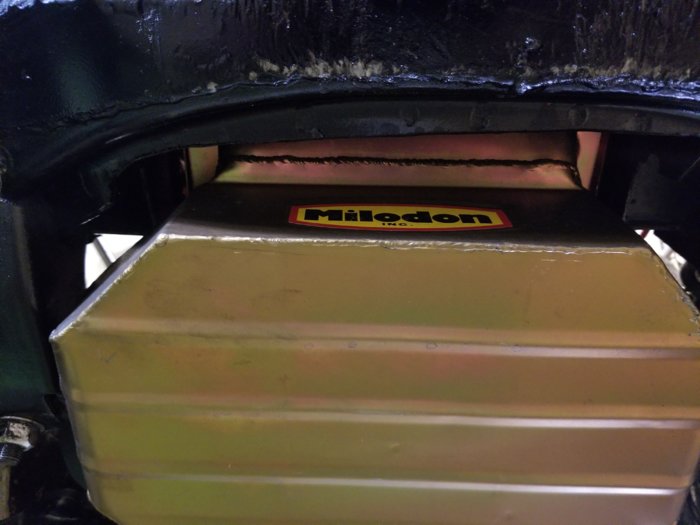

    The Milodon Road Race pan fits with minor trimming on the inside of the K.

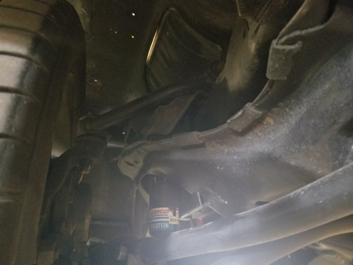

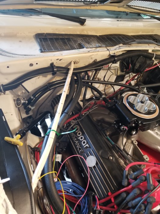

    The throttle cable if left in the factory hole in the firewall won't clear the head as the BB is quite a bit taller than a SB. There is another hole already in the firewall I was able to utilize. Just make an extension for the peddle to hook the cable up on the inside.

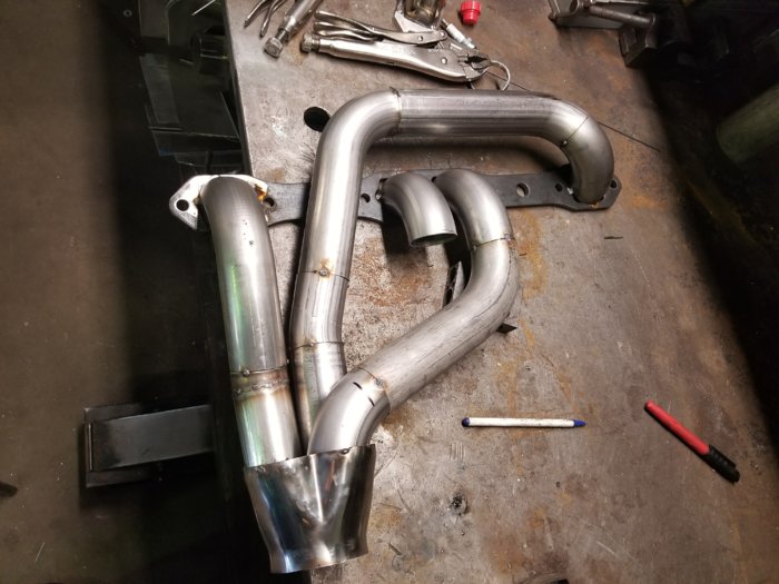

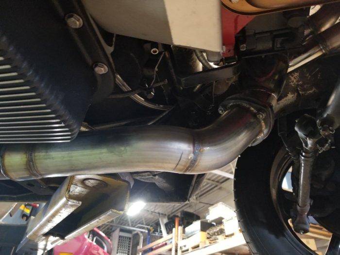

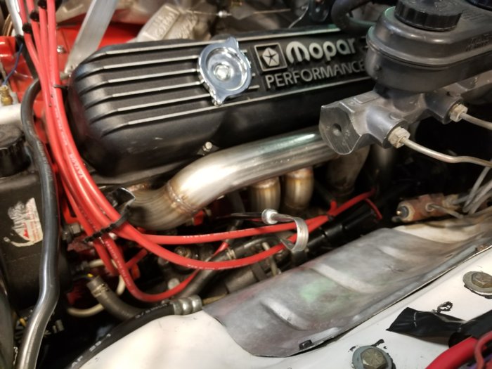

    Forget trying to find headers that will fit with power steering. I stopped just short of traveling to the ends of the world. Ended up having a set made, and if going through that expense might as well use stainless and never worry about it again. Found a shop that did it for $1400. Went with a shorty design for ease of working on the car. Both headers can be removed without screwing around with the motor.

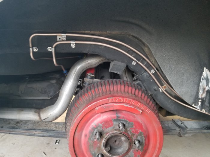

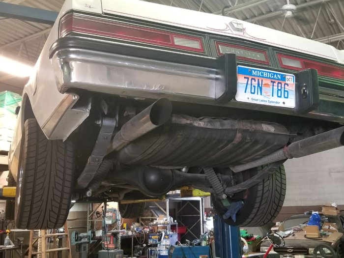

    The 8.75" was pulled from a 66-70 B body. It's the perfect width and requires no modification to fit. You can use the spring perches as it sits by drilling out the holes with a 1 9/16" hole-saw to reuse the ISO clamp setup. I ran it this way for a number of years, but this is not advisable. It pulls the spring a 1/4" inboard on each side - you can actually see it from the back of the car. You really should have new perches welded on, dump the ISO setup and go with B body shock plates. If you have a factory rear sway bar Firm Feel sells a plate that goes between the axle and the spring with mounting tabs for the bar.

    Spring clearance isn't the issue though. Here is where the tire hits.

    Same on my F body with 30 x 10.5 slicks but more severe, time for a BFH.

    I'm glad to see that Moroso pan fit, I had contemplated putting one on my 500" 440 but didn't know if it would fit...

    The Milodon pan fit really well. Didn't expect it to fit as well as it did. Mancini sells a pan rail reinforcement kit so you can actually torque the bolts down without dimpling the pan rail. I used those with 3/4" long stainless bolts with lock washers.
