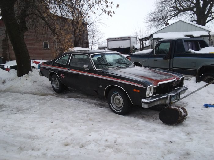

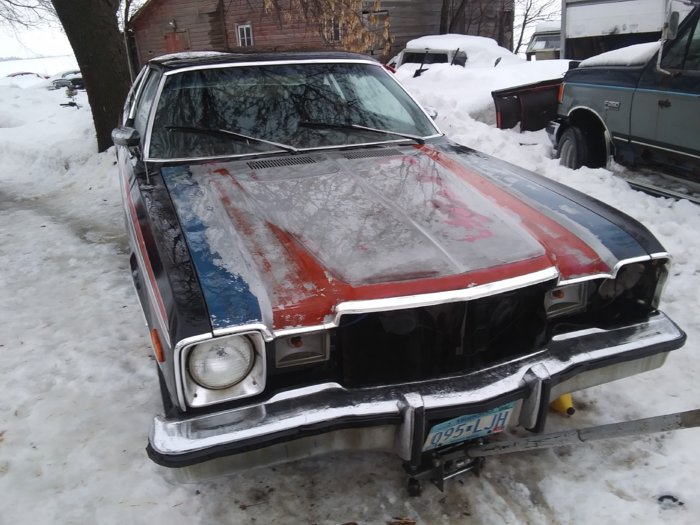

    So this is my project so far, Just kinda wanted to show everyone what I have. See if anyone has any parts they wouldn't mind selling me, And to tell the story so far.
    Its a 77 318 2bbl 3 speed auto. I assume its the 904 but I could be wrong,

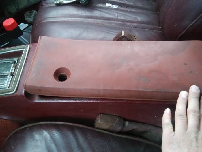

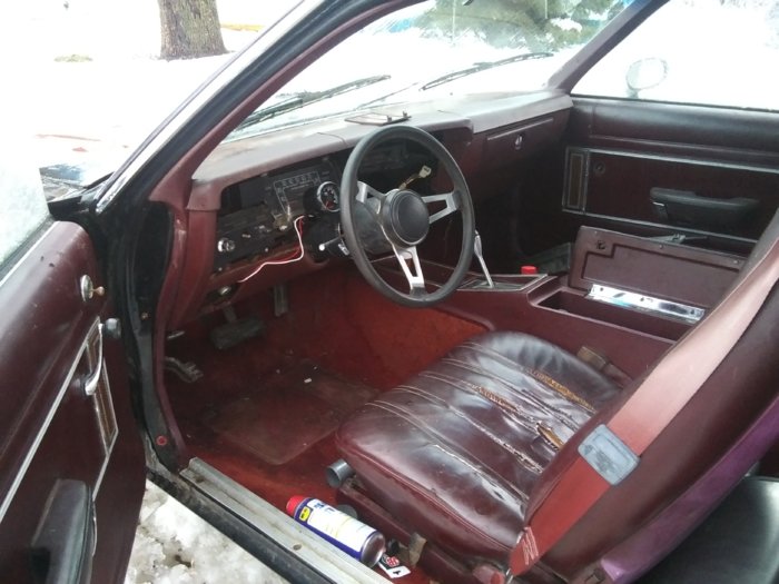

    Bucket interior and center console. I picked this up in St Cloud MN. sometime December 2018. Body seems clean for the most part, The pass door has a good hole in it but I think that's the worst part of the car. Me: I'm leaving for the U.S Army in less then 4 months, I'm 17yo worked enough to have money put away for the propose of this car. I'm proud to say none of this is daddy's money lol. Basically. I quit my job after I joined the army and now all my free time goes to this car, And my girlfriend. My goal is to make it run and drive reliably enough to make a 5 hour round trip to my senior prom. What I have done so far.
    new cooper cobra 225/70/14 tires, New Cap/Rotor, Plugs, Wires, I have Amsoil Dominator 10w30 waiting to go in. I have a 340 edelbrock intake just bought a new holley 600cfm 4bbl that's in the mail, Tachometer, New hard line/rubber line's, New plastic fuel cell mounted in the trunk, Going to have my girlfriend paint a tiger on the hood, In the midst of converting it to True Dual exhaust with 2 magnaflow mufflers, And Bought collectors plates,
    Missing parts I'm looking for, 76-77 grille, Center console lid, (Or at least the locks) and I have to find which fuse is the ignition wire.
    Thanks Guys! tell me what you think, Ill keep updating

    a little more on the car, The Guy I got it from said It was at a scrap yard in fargo for the last 20 years, Not sure why, But it does run and drive, A could things I've got to do Is check the brakes, Open the passenger door, And Unstick a valve. -X

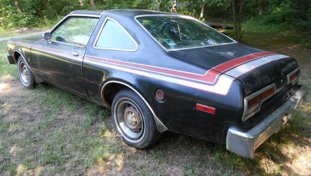

    Question on your rear stripes, are they sharp edged corners or are the soft curves like in this pic?

    Huh Their more sharped edge, I never knew they did them differently. ill post a pic tomorrow.

    They shouldnt be round, I figure this car had some made up or the owner modified them.

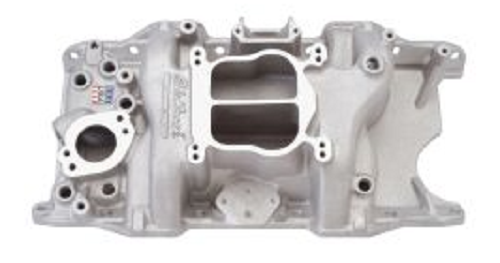

    Your “340 Edelbrock” intake could be one of a few different types. The Edelbrock Performer 2176/3776 (3776 is same as 2176 except it has an EGR valve provision) works great for most small blocks (small port 318 and big port 340/360’s) for the manifold has a cast-in lip that adapts to the small port 318’s that can easily be removed for the large port 340/360’s.
    Edelbrock Performer 2176/3776 - which is what I recommend for all but for higher performing small blocks. This one will give you the best street drivability (in my opinion).

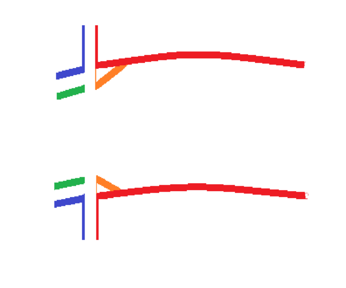

    Green represents 318 port size (not to scale). Orange is the tab to grind out if using a large port (340/360) cylinder head (on the above mentioned Performer (2176/3776).
    Otherwise, installing a large port intake onto a small port (273 or 318) cylinder head can be an issue/concern.

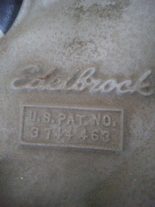

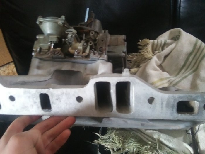

    Im pretty sure it is the larger port size, im not cencered enough about it to do anything. But i definitely will look for a lip that gas could get stuck in. Im expecting it actually. I know the intake is a torker model, But it doesnt say much else besides the pat number.

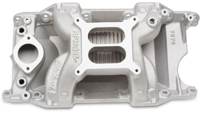

    I can’t tell which intake it is from your picture, but I included a few pictures of Edelbrock small block intakes (might not be a complete list) that might help you determine what you do have.
    Performer 2176 (3776 is similar except has EGR port provision)

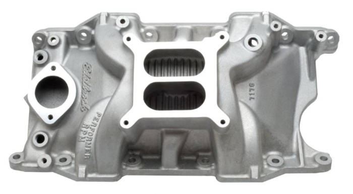

    Performer RPM (7176)
    Performer RPM Airgap (7576)

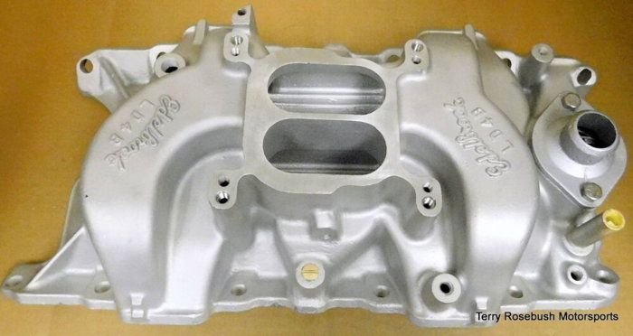

    LD4B
    At this point, I’m going to be very careful about what will be said for I fear I’m walking on a tightrope at this point.
    To begin with, what is your end plans on this vehicle?
    Will it be driving at the track (only), driven full time on the streets (and so forth)?
    Are you looking for a certain horsepower number or just a fun car to drive?
    The intake pictured (post # 8) does not have a divorced choke provision. That means you will need to either setup a manual choke (which can be a pain to operate, each and every time you start the car) or an electric choke attached to side of carburetor.
    The carburetor shown does not have choke mechanism attached to it. If car will be driven daily or mostly for in-down driven – I would highly recommend using an OE (Original Equipment) designed choke or an electric choke attached to carburetor. Even for a full-time race car, having a working automatic choke is well worthwhile.
    The intake pictured does not have a provision for EGR valve. If you reside in a non-emissions state (or city), then no worries. If you live in California, then this will not work. I don’t think Minnesota is an emissions state, but don’t take my word for that.
    The carburetor might need an adaptor to be attached for throttle to work correctly. I can’t see that side of carburetor to know for sure. If needed, throttle adaptors are not that expensive – but just another thing to acquire. If you were to take a picture of other side of intake/carburetor, I could tell you if you are good to go, or if an adaptor is needed.
    Most “street driven” cars need to produce most power down low (in RPM range), which makes the Edelbrock Performer (not the Performer RPM, which is different) a wonderful intake for street usage (or equivalent from other brands). It even works better than the heavy cast iron OE 4-bbl versions.
    In my opinion, any other design intake (designed for higher RPM’s than the Performer series) hurts “street use” drivability - which is generally from 750 to 3000 RPM range.
    I fear the intake you have might be rated from 3000 to 6000 RPM range (possibly) which might be a problem – for a 318, no matter which intake you use, just can’t turn more than 4000 to 4500 due to small cylinder head port size and camshaft usage.
    Again, if this intake is one that I think it is, I fear car might be worse for street drivability than you will be or might be expecting . . .

    The Toquer intake is a single plane open plenum manifold for high RPM power. Better suited for a built 340 or 360 that will turn some rpm but not a stock 318.

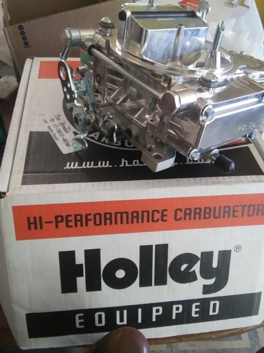

    Got my new Holley 600cfm in the mail today. Going to start putting everything together
