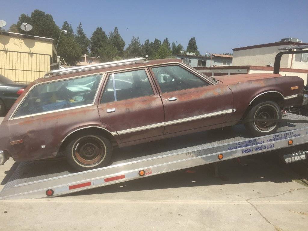

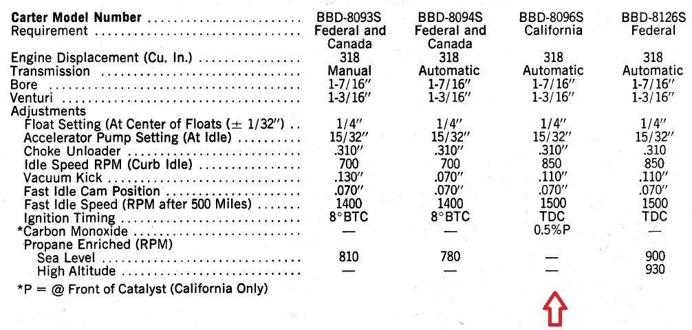

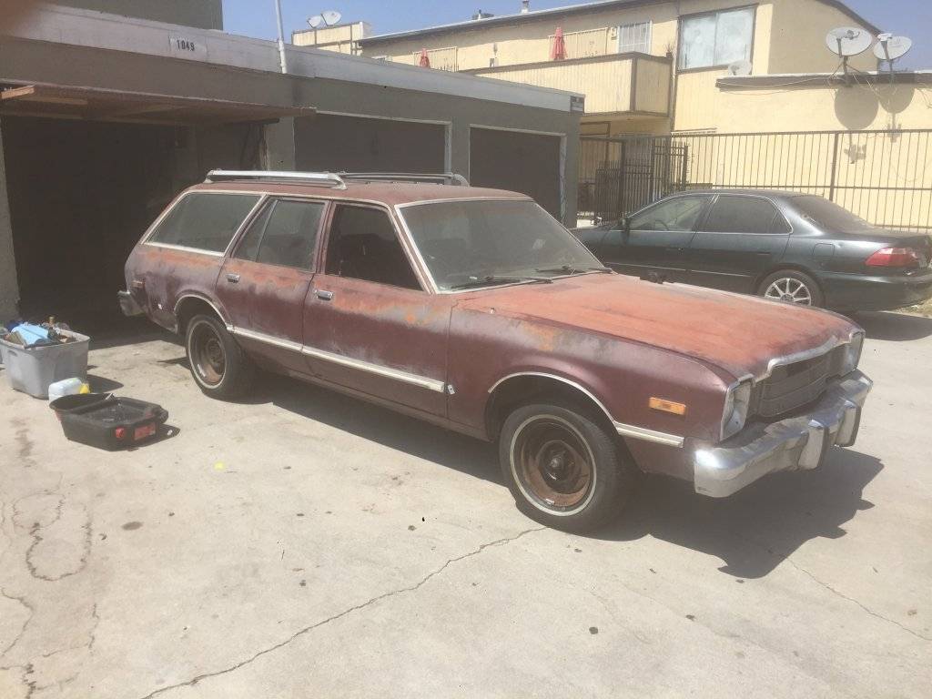

Okay, I just replaced the timing chain and all of the ignition components on my 1977 Plymouth Volare Wagon. It has an automatic transmission and is equipped with air conditioning. Now I want to set the ignition timing, can anyone tell me the proper specs? My emissions label is long gone and there seems to be allot of speculation out there on the web. Primarily need to know ignition timing setting and min idle rpm. Much appreciated.
