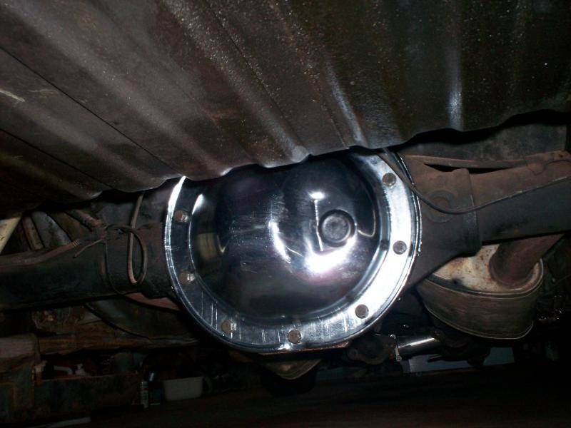

Trick is to use the correct type of RTV, I recommend gray or better yet, Chrysler sells a specific RTV for diff covers that's more or less red in color. Make sure both surfaces are PERFECTLY clean. A good brake cleaner or rubbing alcohol will do. There can't be any trace of oil or the RTV won't adhere. Then, you only need about a 1/8"-3/16" bead. Snug the bolts, wait a few minutes and then torque them. If time allows, let it cure 12-24 hours before refilling. Although at work, we refill right away or soon after installing the cover. Never had any come back leaking,,,,,,,,,,,,,,,,,,yet.
