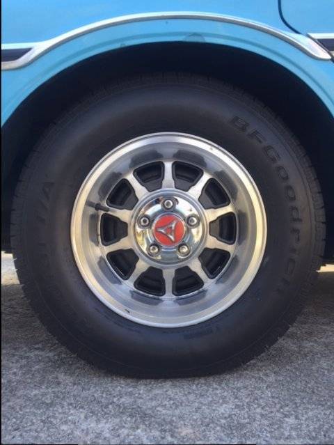

Thanks for all the positive replies. Wheels do change everything about the look of a car. These cleaned up rather well, still some more polishing to do.

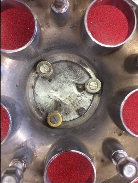

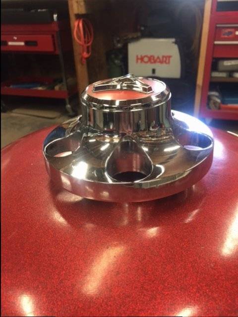

A close up of my wheel and center cap. My domes did not look as nice as I thought they would after the one I bought from 65 Dartman arrived. So I bought 3 new domes from Vintage Parts ( pricey ) but no center caps anywhere. I found some hubcaps in the salvage yard for 68-69 Charger 14" wheel and removed the medallion then figured a way to attach to the dome. Here is a picture. I had to put 3 small notches with a round file in the dome so the post on the medallion would fit, then a 3/8 nut on the post, flat washer and screw. The front was this way because of the grease cap fit. On the rear I cut a disc from sheet metal that fits inside the dome that the medallion attaches to.
