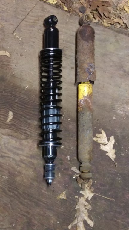

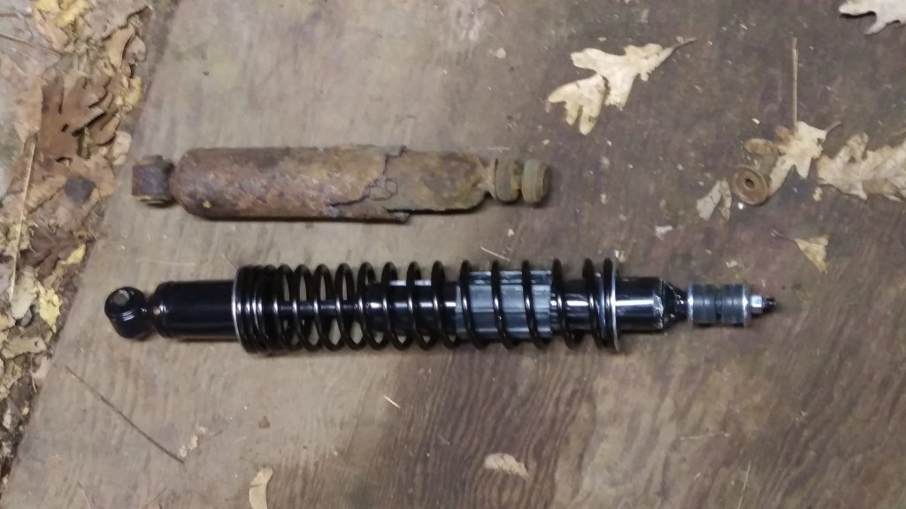

Ok, aside from the obvious differences of the big spring and notable lack of rust the original shock had some major internal valving failure.
It should return to the fully extended state by itself, but as you can see, does not. The other side was just as rusty, but returned to position normally.

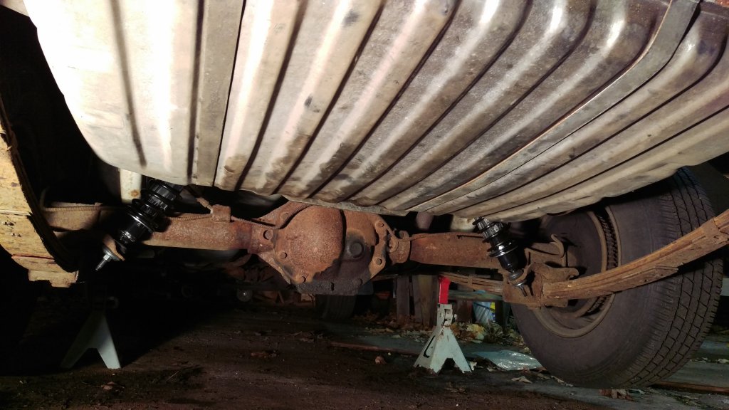

New shocks in place are looking good and working MUCH better. I have a video of the car wallowing around while I was driving it. I'll upload it later, and shoot another in the same place to show the after.
