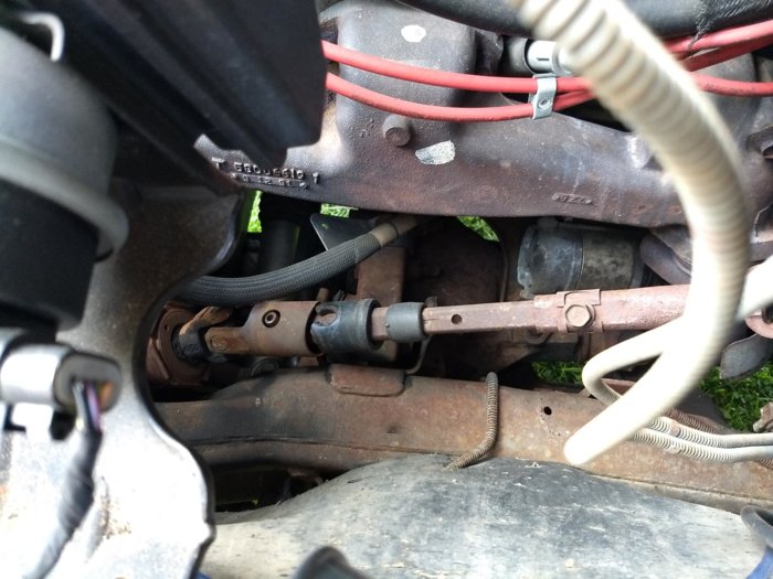

    1992 Dakota 4x4 with tilt.....the steering wheel felt loose the other day....looking at the joint on the steering shaft under the hood, I found that the rubber insert to to what would be in the old days the "rag joint" at the lower joint has backed out and when you turn the wheel, the roll pin moves in the big hole shown til it hits the side of the hole and moves the steering box shaft....no crazy wear in the holes yet but I am sure that will come.........
    I am not sure how this is built so I am not sure what exactly is coming apart in that area.....
    Is this a "replace the whole shaft " thing like in the 98s and up or can this joint be rebuilt like the 80s and below Mopars?
    I cant seem to find parts for either scenario????? I saw ONE reference for a 93 Ram pickup that looks to be the same shaft (at least the part I can see) and the guy said he had to pull the master cylinder to get to the top half....UGH!!!! And then he had to buy custom parts from Borgeson and build a shaft! DOUBLE UGHHHH!!!!

    Do not drive the truck until this is resolved.
    IDK what's going on there I have never needed to take that apart, but
    as much play as you say you have on such a critical part is very scary to me.
    I think that junk is all supposed to be bonded together and used as a feed-back insulator. Ima guessing you could just weld it all together, but your parts alignment would need to be fairly straight, and the floorplate might need to be re-aligned. After that, any vibration coming up to the steering box, is also gonna find it's way up the shaft. Hopefully the tilt mechanism will survive.
    Like I said; IDK.
    Ima thinking the rubber stuff was the principal driver and the roll-pin was the safety back-up system.... so if the roll-pin snaps......

    Part no. 4470093, discontinued, not finding through nos or dealer stock. Borgeson could probably supply a joint to fix it, or you will have to find a good used one.

    Thanks. Is that the part number for the entire shaft or parts?

    That is the number for the lower coupling

    I love this truck....have had it since it was a year old in 93. Its been uber-reliable so having to deal with this isnt a surprise....SOMETHING is gonna break eventually....about 125k miles.....she only sees a couple hundred miles a year now at most.....
    I am gonna check and see if "that junk" will all push back in and confirm that that it is the main driver as you say....thats my theory too....or maybe its pressed in originally.....cant figure how it would have worked its way out like that.....
    I cant believe that NO ONE makes a replacement.....its not like it was a rare truck back in the day......there are tons of replacement parts for the 98 and up.....entire shafts.....
    So I sent an email to Borgeson to see what they suggest....

    Thinking about this more, I dont understand how the rubber insulator sleeve (assuming that is what it is) does anything BUT insulate.....what is actually making the CONNECTION besides the roll pin in there???
    If the rubber is just an insulator and all that is making the connection is the roll pin, why is there slop? There must be something else to it......right???

    Go back to your picture; it looks like close to 1/8 clearance on each side of the pin, totaling 1/4 inch movement.
    The coupler looks to be about 1.75 in diameter , making the waistline to be 2.4 inches. So 1/4" play would be ~ 10 degrees.
    On a 14" steering wheel this would be 1.22 inches on the rim,
    but
    the power-steering box, with the engine off, is gonna double or triple that, as the reaction springs have a ton of play in them, all by themselves.... which is normal..
    I'm thinking when new, that whole assembly mightabin bonded together and acted as one piece with the roll-pin just acting as the safety in case the bonding failed.... as yours seems to have done.

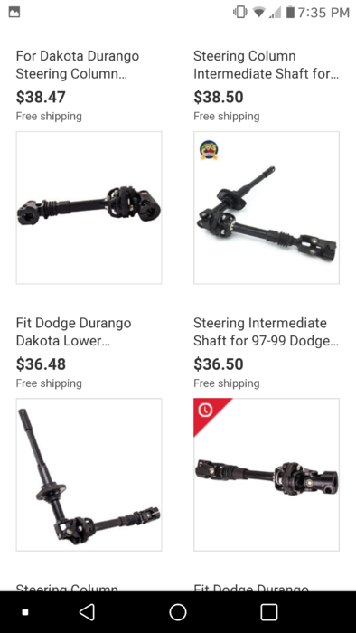

  16. Opticon77
    Opticon77 Well-Known Member
    281
    142
    Apr 15, 2018
    SE PA

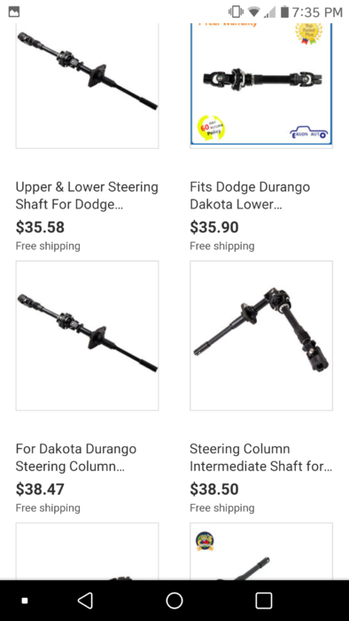

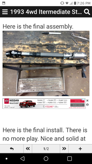

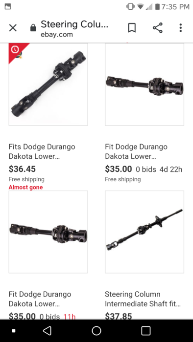

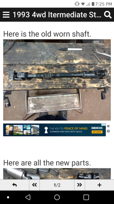

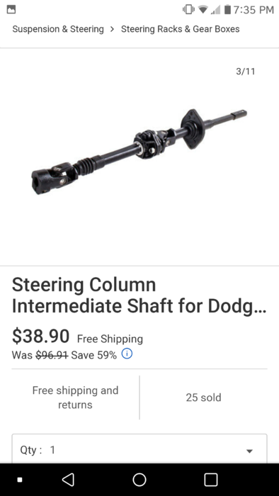

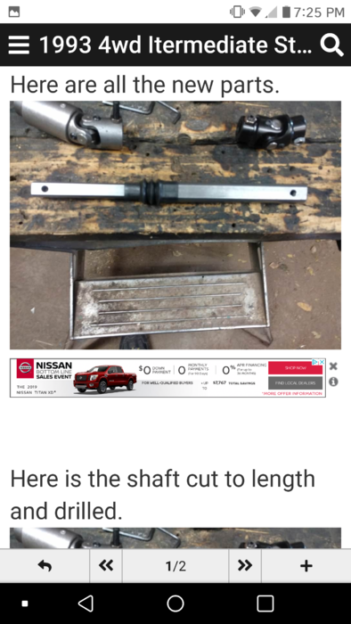

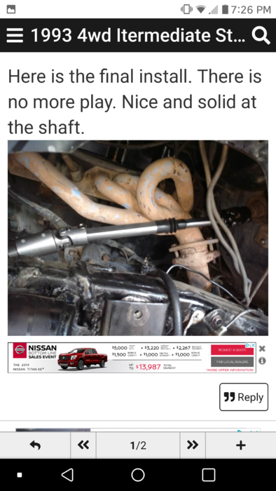

    Here are some possible solutions some require fab work and these other might work or pic pieces and make it work..

    Or something from these would have to work since Mopar used same basic junk on everything..
