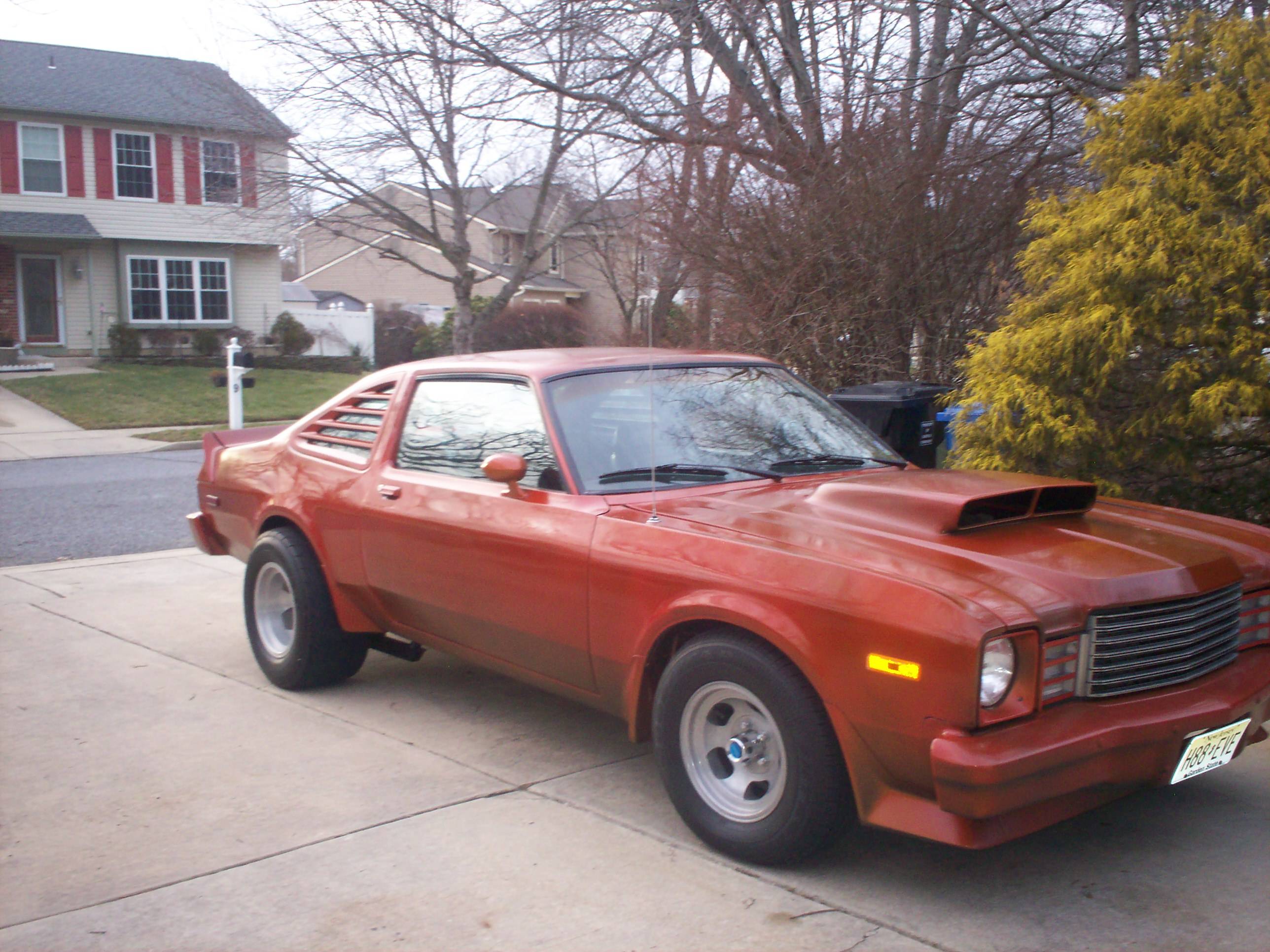

Part 1 Wet sanding Part 2 Polishing

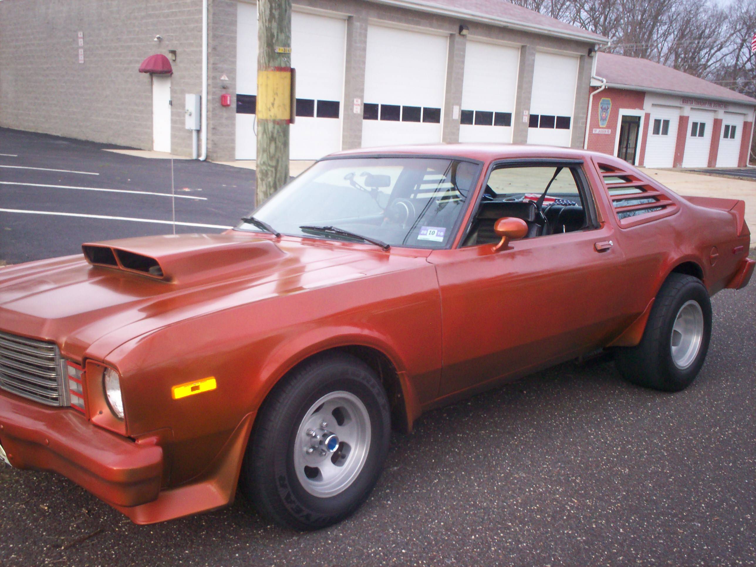

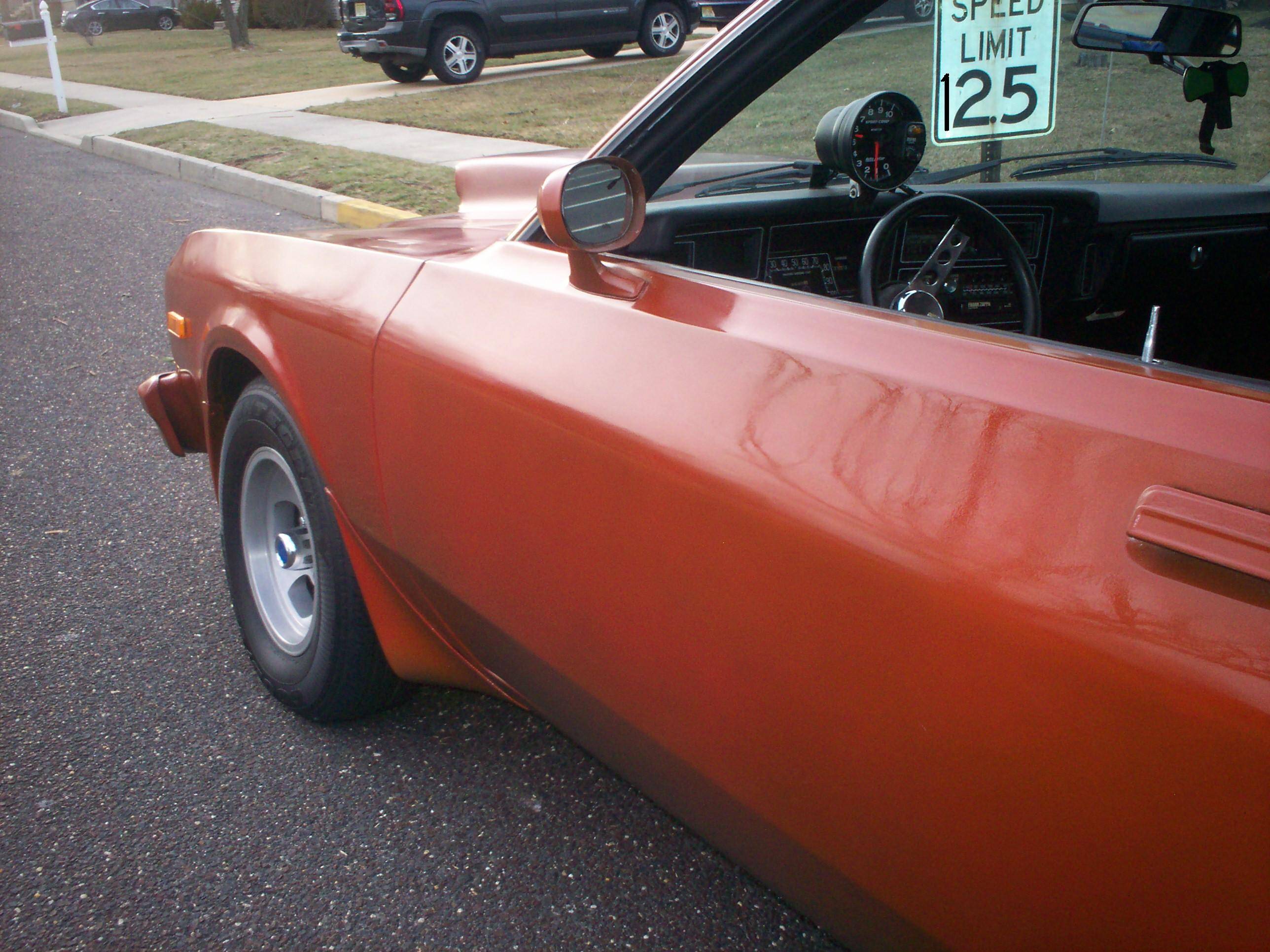

Wet sanded again and then compounded and then POLISH. First polish is done. I can see a reflection

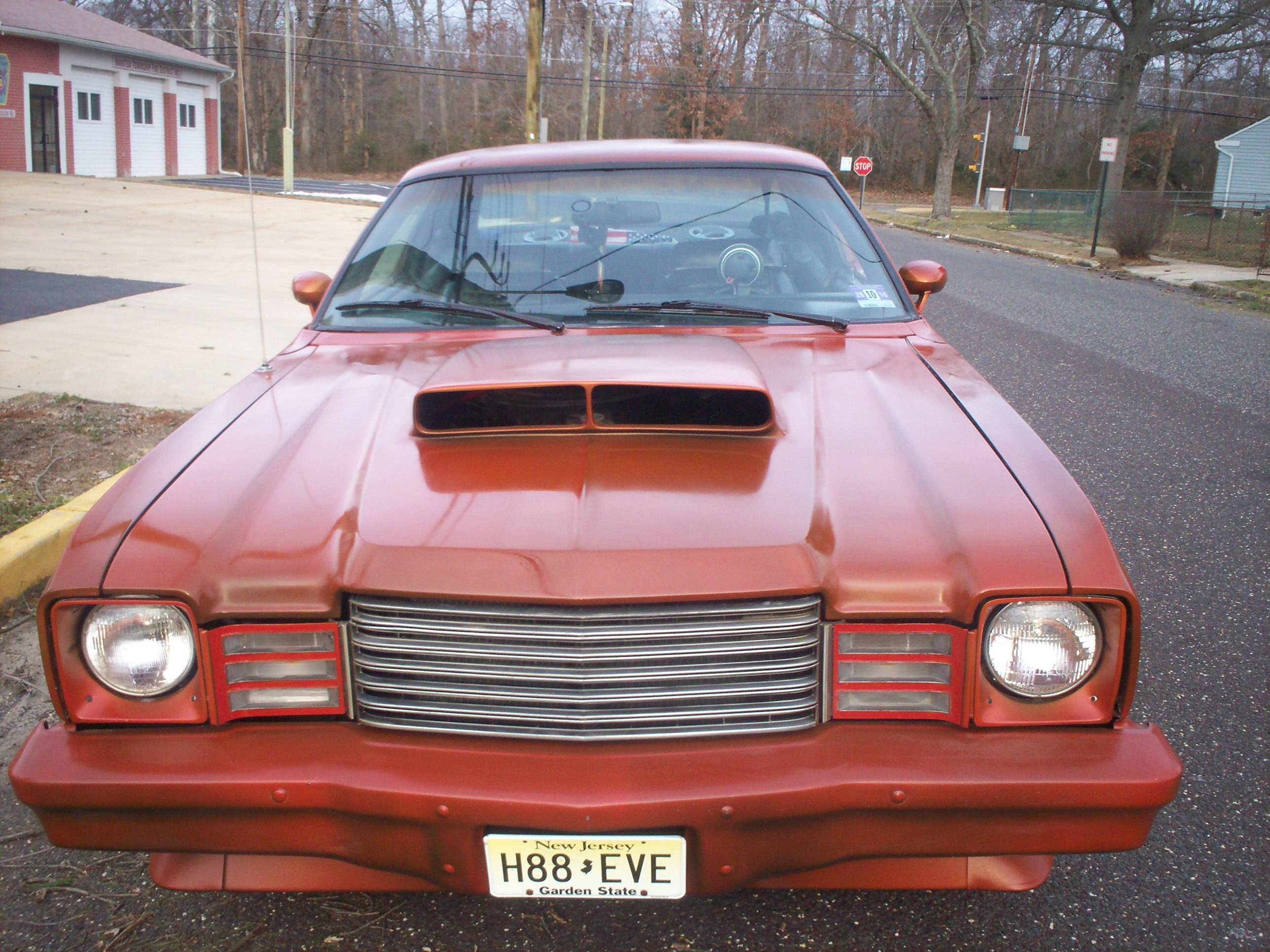

Very Nice. What brand and types of paint did you use?
Dupli-color. 3 quarts of sealer primer, 3 quarts of etching primer, 3qts black base (metal carbon), copper mid coat, 11 quarts of Candy orange, 13 quarts of clear. Sounds overboard , it is. I'm not a painter. I used that much to redo my screw ups as I went along.
Dupli-color is meant for DIY weekend warriors and limited skills like me.

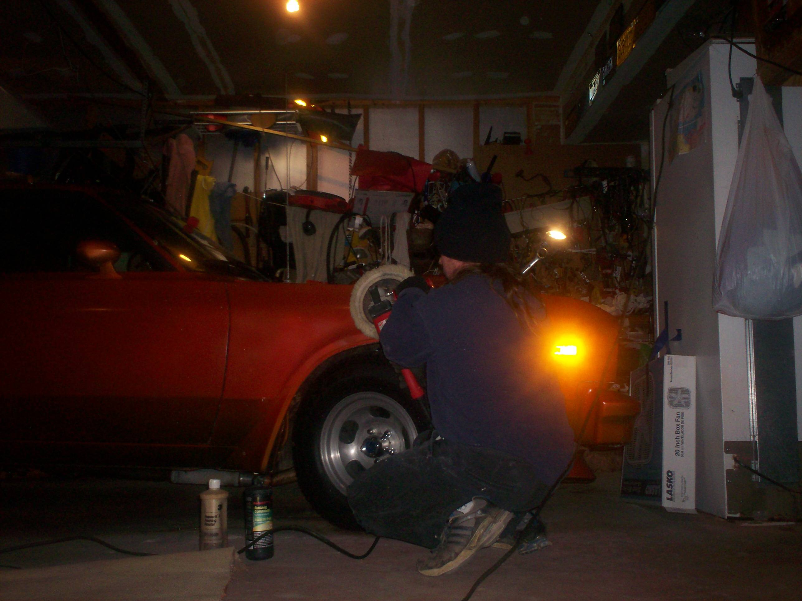

The wetsanding didn't kill my arms. That Milwaukee buffer did. After a few panels I couldn't keep it from walking out of my hands. I had it on 2 to 3, but on open areas with no edge I put it to 4 and that sombich wanted to take off. Just put another wax coat on last night. Tried a Barret Jackson wax. Less white streaks and swirls. Still had to go back with the Ebony shine where I have light haze. I think if I had the paint gun I have now, the quantity would had been more conservative. The Harbor Freight gun was a fight for consistency.

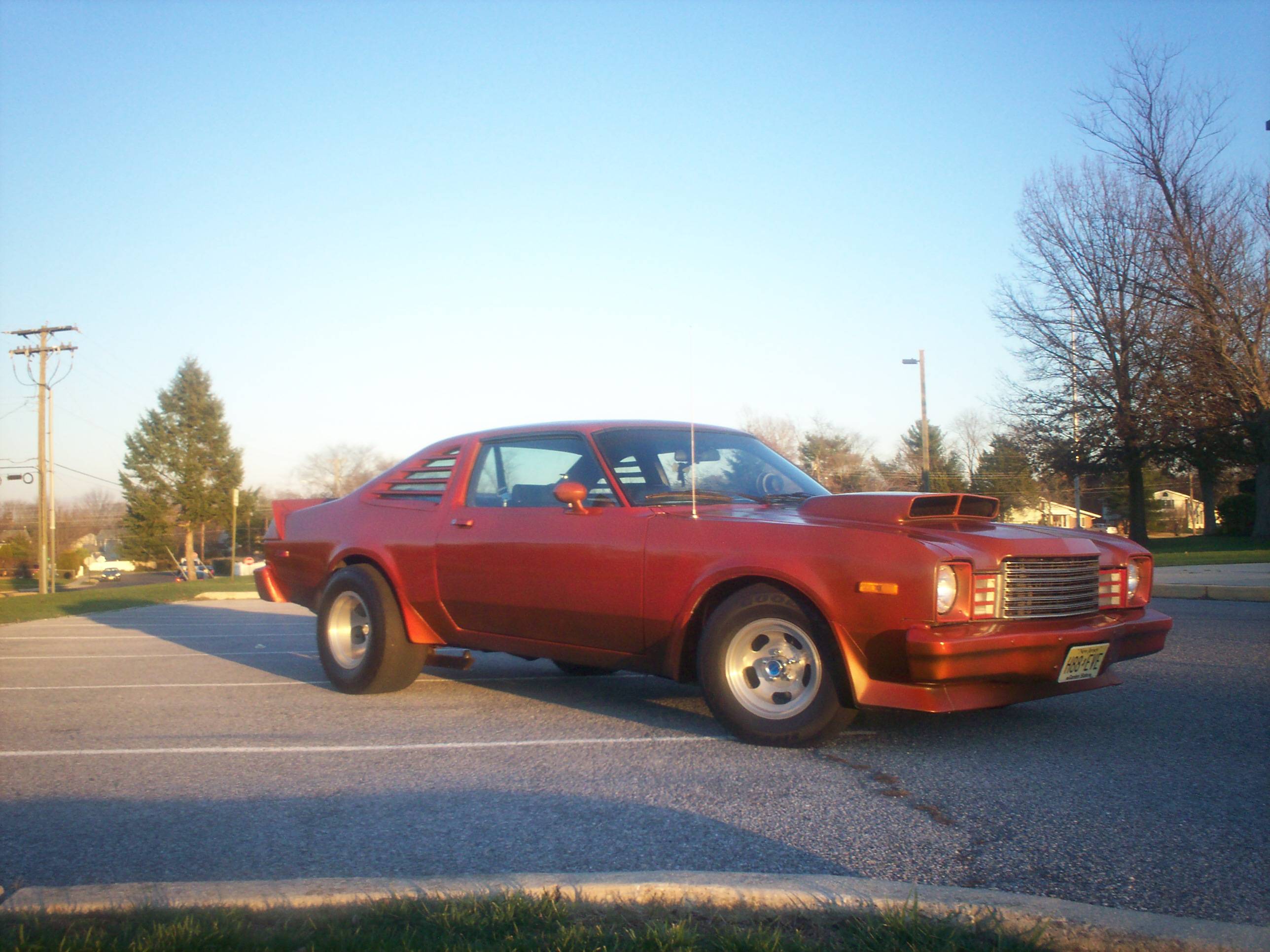

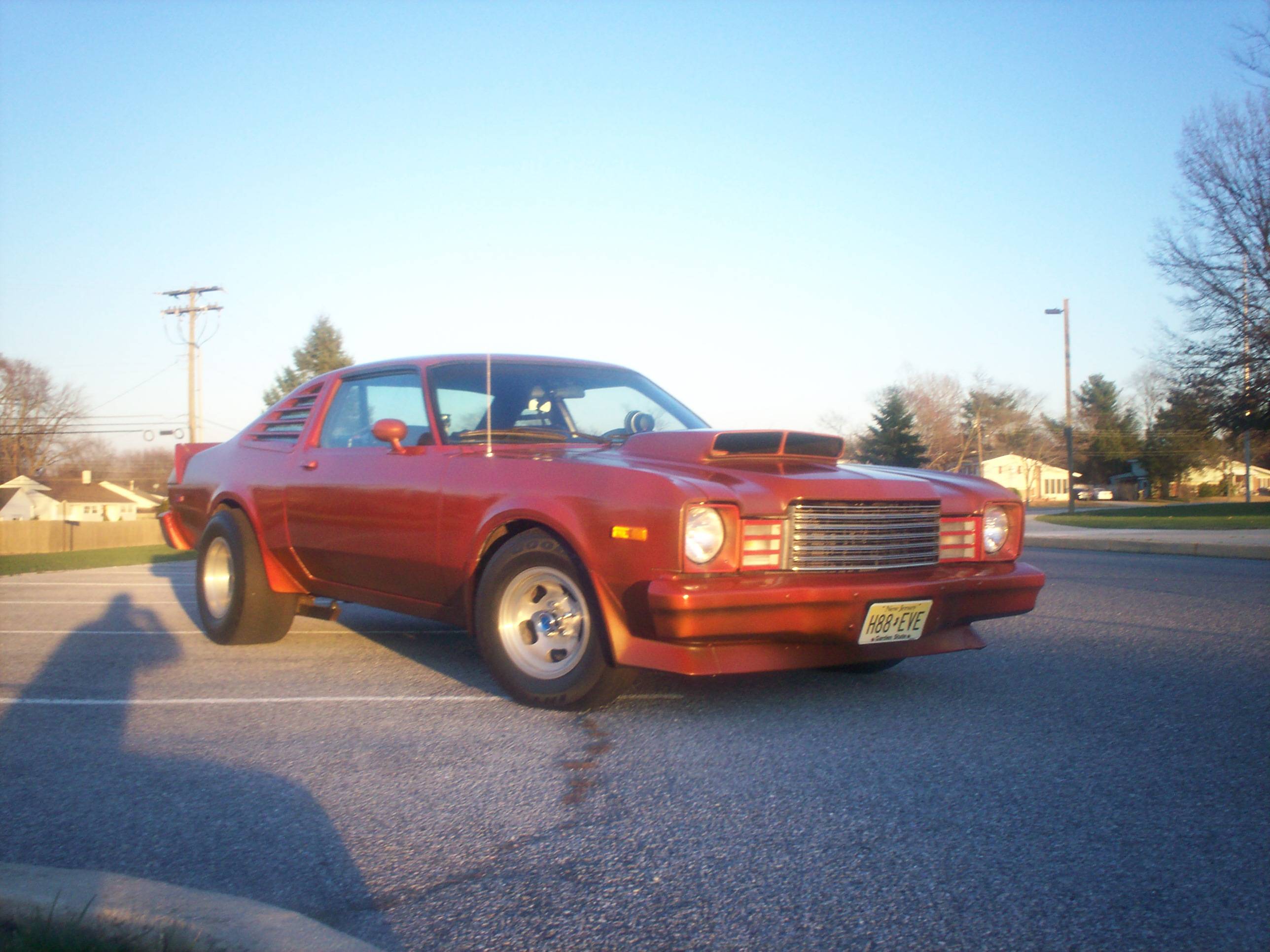

Not the best shot as the sun had dropped already. I'll give Griot's as try. I figure I've plugged Duplicolor, 3M, Turtle wax, Maguires, Mothers and so I will keep plugging them all
