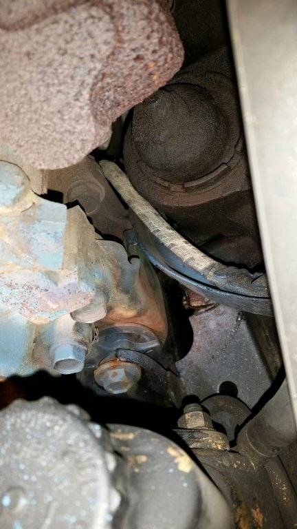

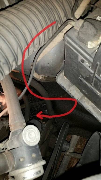

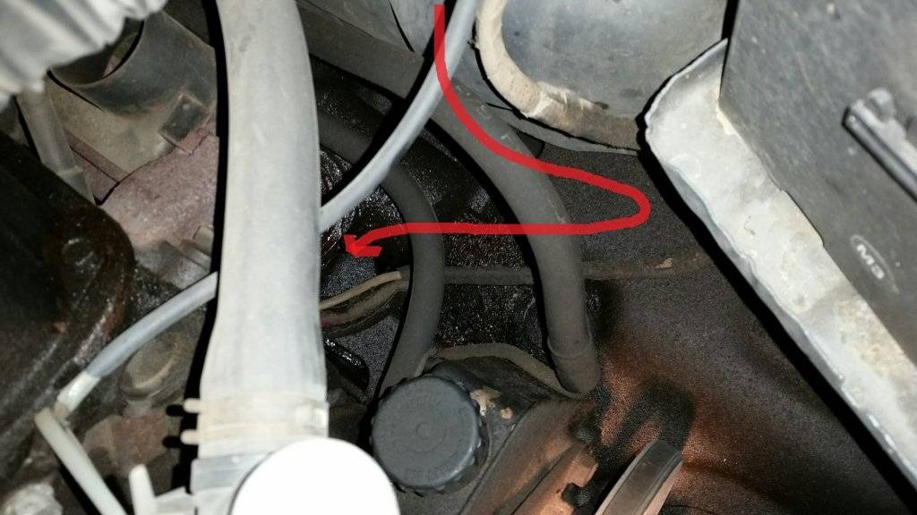

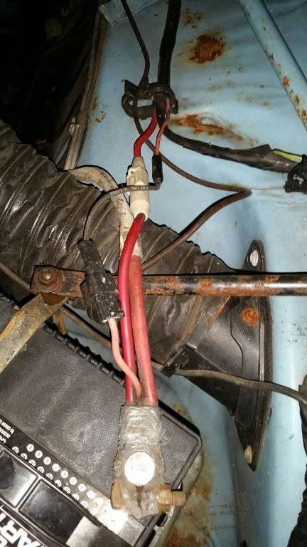

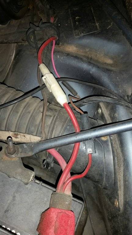

    I took pictures of my ‘77 and ‘86 (318's).
    The positive battery cable P/N on my ‘86 is 4274218 (the same P/N until ‘89 (end of M body production)).
    The first three pictures are from my ‘77 Volare 318 2 bbl.
    These are from my ‘86 5th Ave 318 2 bbl.
    I would say they are the same cable. I would also assume the ‘82 cable (mentioned in above posts) would also be the same - but can’t verify.

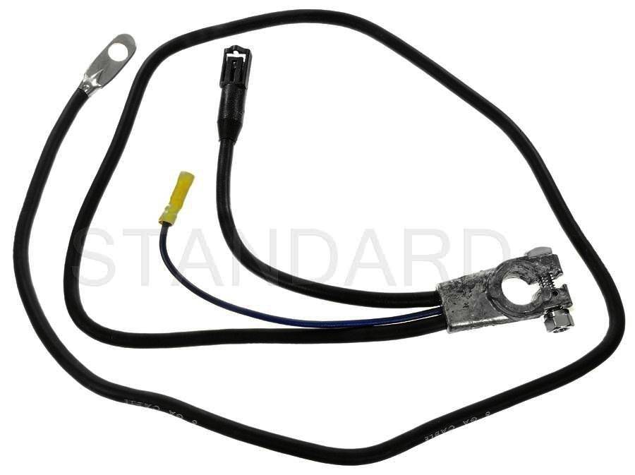

    I found this picture on eBay. Without knowing how long your original cable is and how long this replacement cable is, I think you can make this one work,
    You would need to cut the tape and cut off the solenoid wire off from of the starter connector. Then tape it onto the new cable.
    One would also need to cut off the electrical plug-in, by the battery and solder in place of the already half crimped on connector on replacement wire.

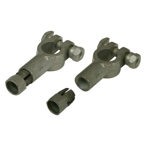

    If replacing the terminal end is the only option, at least use a style such as the one in the pic and never those crappy ones with the strap and 2 bolts.
    There are also ones similar to the pic but come with a solder slug. You strip the end of the wire, put the slug over it and then into the tin plated copper terminal. Heat with a torch to melt the solder and it's 90% as good as a factory molded in place terminal. They work very well.

    Amen brother.
    Those will keep a person busy for years, just working on those replacement terminals.
    They work OK, if you are only trying to pawn the vehicle onto the next person.
