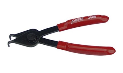

I highly recommend to either get the official antenna nut tool (can be obtained on eBay or other places – and looks like tool used below)
OR what I use is a larger set of 90 degree snap ring pliers.
You “can” use a screwdriver or channel-lock priers – but either will tear things up (especially a screwdriver vs. your paint job).
