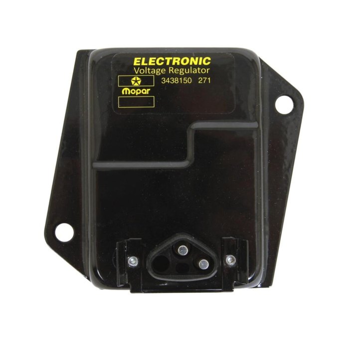

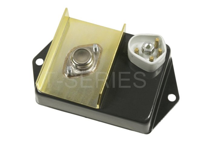

    If you do not have Lean Burn or do not have a computer hanging off the air cleaner, I would always carry a minor tool bog, a spare Ignition Module, ballast resistor and voltage regulator (get a soft bag and put it by your spare tire full time).
    Ignition Module
    Voltage Regulator

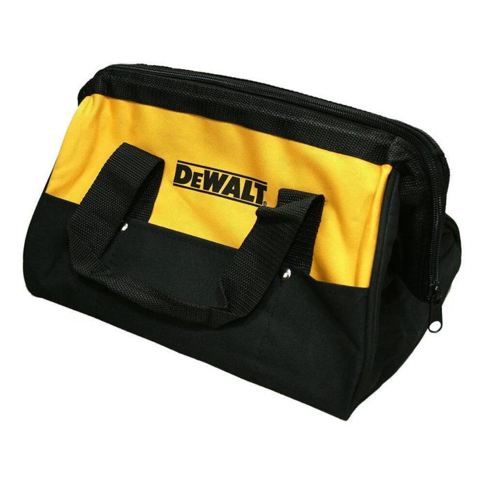

    The (soft) tool bag needs to contain a few common end wrenches, sockets and screwdrivers, to replace any of the above-mentioned parts - or drive belts, hoses or other repairs of that nature on side of road.

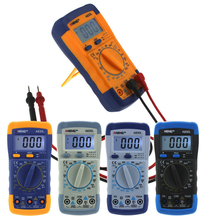

    Also, in your tool bag, get a CHEAP volt gauge (like this one or one similar, https://www.ebay.com/itm/ANENE-A830L-Digital-Voltmeter-Ammeter-Ohmmeter-Multimeter-Volt-AC-DC-Tester-Mete/173287487566?hash=item2858bd384e:m:mLXIgQNpy9zkPzDUhFANJ6w . This one is only 1 dollar (plus tax)).
    Harbor Freight also has cheap meters as well as others. This tool is one you hope you never need – but when you do, its there. I have a few quality multimeters in my garage, but in car, I use the cheap ones.
    Note: make sure battery is kept outside of meter until needed, then removed afterwards).
    Tool bag example. They come in many sizes and shapes.
    I have one in each - car plus when I go on long trips I also take my big tool box, but that is just me.
