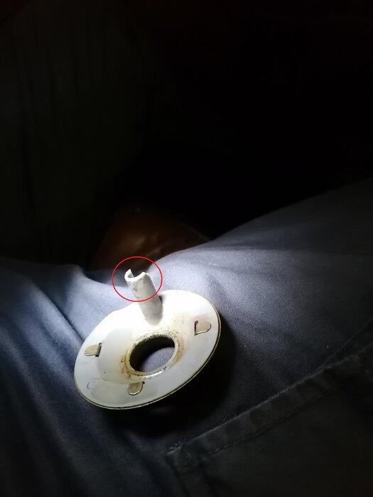

Now I have a new question: I replaced my turn-signal switch because it did not turn itself off. (I think it is a common problem with the broken springs inside the switch...)
However, the replacement did work pretty well. BUT I broke the turn switch cancelling cam (the round thingy with the Horn contact). The black spring-cable won't hold up because I broke the small "nose" (on german that would be the name for it..) which holds the black plastic of the horn-contact (see the attached picture).

Is it for a tilt column? Do you have the part number? Or is there a part number on it?

Yep, it's tilt column. Unfortunately there was no part number on it and I can't look at it at the moment because its built in the car right now.
But Auto Parts Obsolete said the number was 4019314. But I am NOT sure if it's the correct number of mopar or just of their page.

The (F/M-body) Tilt steering column, from 1976-1979 is much different from 1980-1989 F/M-body Tilt steering columns.
Also, Chrysler changed the electrical plug-ins every couple of years or so.
The '80 and newer steering columns are Saginaw made.
I "suspect" the steering columns made before then are Chrysler design - but maybe made by Saginaw (or by Chrysler).
The correct turn signal switch will be 3747203.
The cam part number is 4019314
