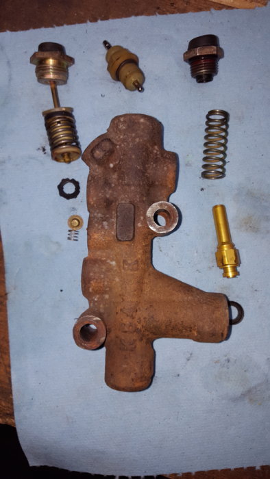

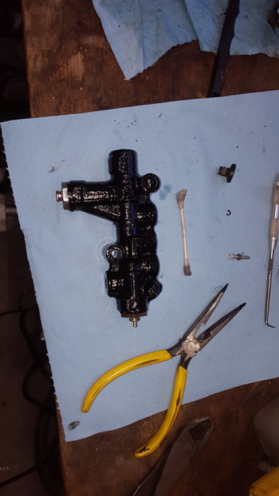

My proportioning valve is sticking under hard braking (i.e. idiots pulling in front of me, me locking up all four wheels to keep to t-boning a dummy). It's happened twice in the past six months, the pedal immediately gets hard, and the front brakes (seem to) drag and become pretty poorly responsive. I have to let everything cool down and with a combination of tapping the proportioning valve with a hammer and stomping the brake pedal it usually pops back into it's normal position and works properly. I've figured it's time to replace it and with a quick search of the autoparts stores' websites shows no one carries it. Does anyone have any recommendations on any aftermarket unit or any stock-type replacement before I start to dig into any shopping?
