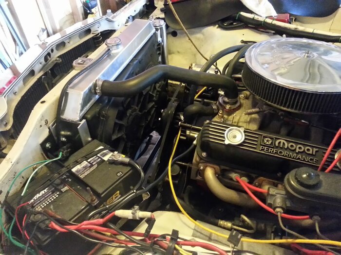

You probably want something like this then. It's a Champion radiator part number CH374. Three row 26" that cost me $250. Cooling fans are duals pulled out of V6 Ford Contour for $35. To give you an idea I'm using this same setup on my stroked big block now and it keeps the motor right at 180. Works great.
I think Champion discontinued the part number, but you should be able to find something that fits in their catalog. The CH374 was a universal fit.
No reason to buy some expensive aftermarket fans. Junkyard stuff cleans up just fine and pulls more air.
