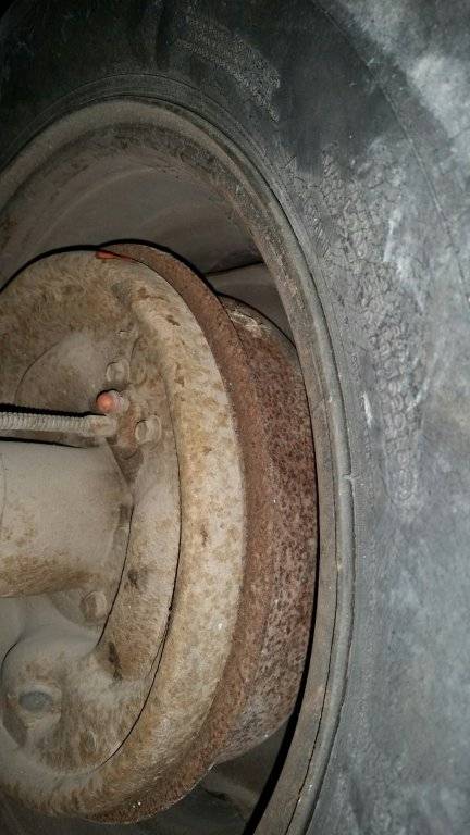

My 37k mile ’77 Volare wagon has non-finned drums and an 8¼” differential I removed from a ’80 Aspen wagon yesterday has 10” non-finned drums.
I wonder if it was a year of manufacture thing or an option (trailer towing), maybe?
It might also be that both above mentioned wagons has had their drums replaced.
It might be what the factory had (or didn’t have) on the shelf at time of manufacture. Me shrugs.
Correction: the '77 Wagon does have 10" fined drums.

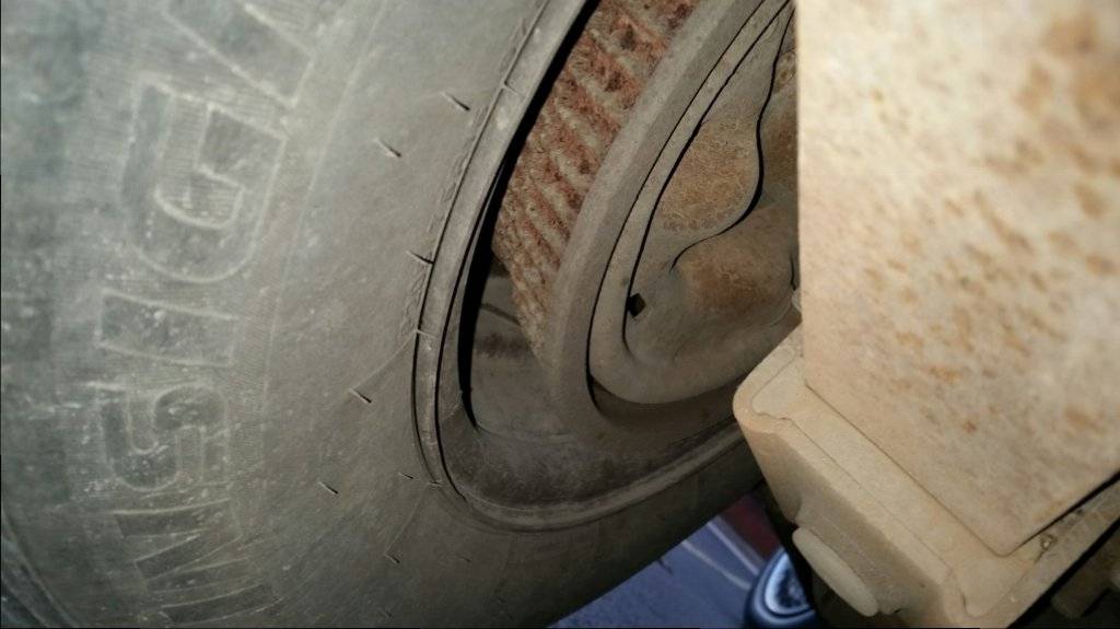

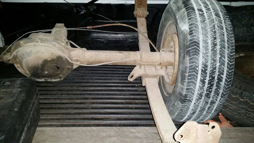

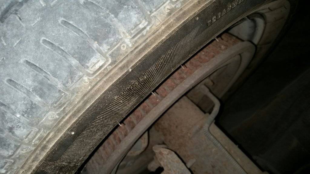

Jim, I went looked. I made a mistake, my ‘77 Volare wagon does have 10" fined drums, as well as my ‘86 5th Ave.
'77 wagon (with 14" wheels)
'86 5th Ave (with 15" wheels)
'80 Aspen Wagen (with 15" wheels added to move it)
Now it could have been the drums were changed on the ‘80 Aspen wagon, maybe.
Still in bed of my pickup.
