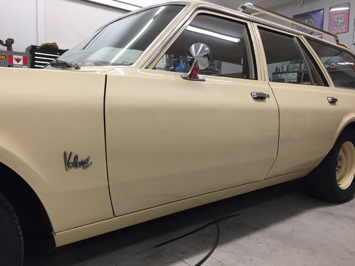

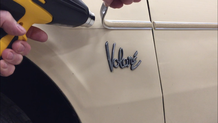

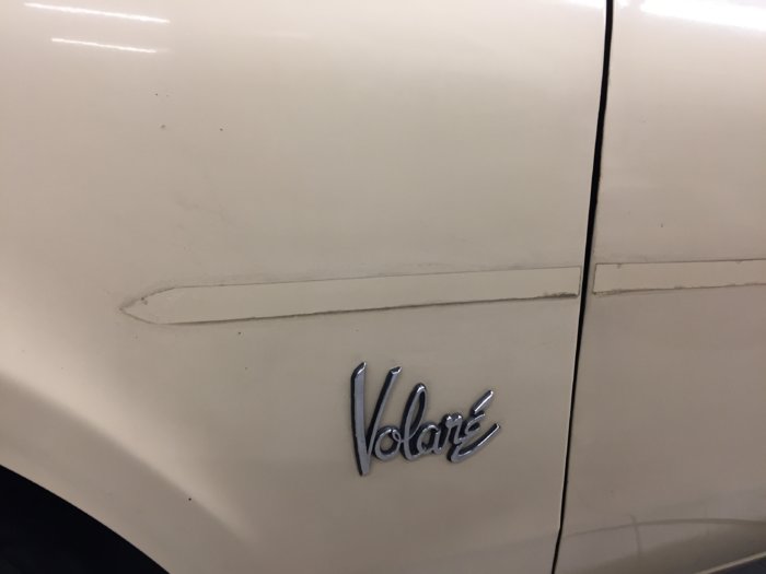

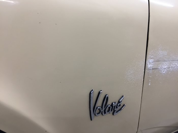

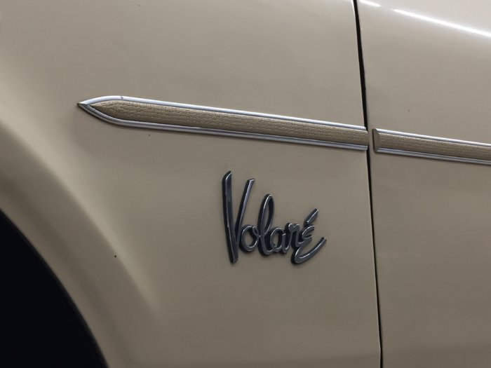

    89C2EC91-33C0-412B-859E-8B1C6B8095CA.jpeg E3A20E42-6769-4052-B755-C59D588CE1CC.png 464E45C1-FF47-49D7-A14E-4B12D49FBDE5.jpeg 30BDFD18-9D87-43DF-A5FD-0BEFC3C9BC25.jpeg 59721A96-61F5-435B-867D-D2D7252D601A.jpeg I disliked the factory body side moulding on the wagon so I decided to take a run at removing it. I used a heat gun set on low (approx 200 degrees Fahrenheit) and a plastic scraper. I heated up the trim and used the plastic scraper to get under both the moulding and the black adhesive. Once I got the end lifted I ditched the scraper and just pullled on the trim while heating the exposed back side of the trim. I was stunned how easily it peeled right off. Done in 15 minutes with only a 40 year old dirt outline of where the trim used to be. I took some Turtle Wax bug and tar remover, sprayed it on the outline, let it sit for 5 minutes and wiped it off with a rag. You’d have to look very closely to see that the trim was ever there at all.

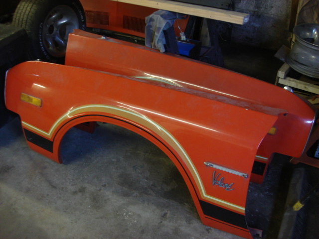

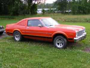

    You guys are harsh on the side molding topic. This on pic is of when I found the car on CL in NJ, second pic is the front fenders off it.
    So how did my FT get coded?
    I thought some came that way factory and some were added because the few cars coded I know of its placed in the same, others seem all over + - 3-4 inches.
