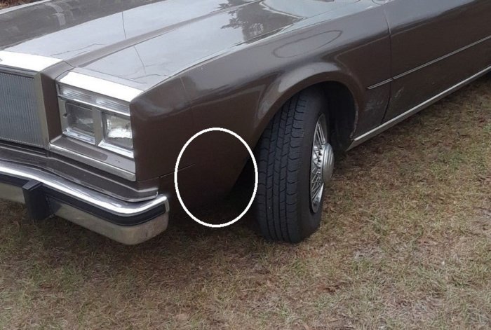

    According to a picture you took, you do not have cornering lamps (would be in the white circle, below, if you did).
    You also do not have a front side marker lamp either (because of the header panel replacement.
    Some states require cornering lamps – most states do not.
    A cornering lamp is basically a fender mounted flashlight that shines in the direction you are turning – while the turn signals are on.

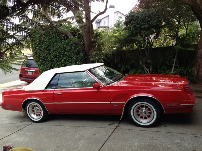

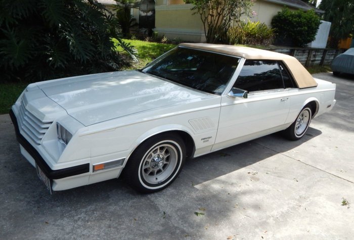

    I found a couple of examples on a Mirada (J-body):
    Without cornering lamps (which is the type an M-body would have if your car came with/built with current style header panel on it).
    With cornering lamps. Note: the fender hole is made larger.
    Pictures swiped from the internet.
