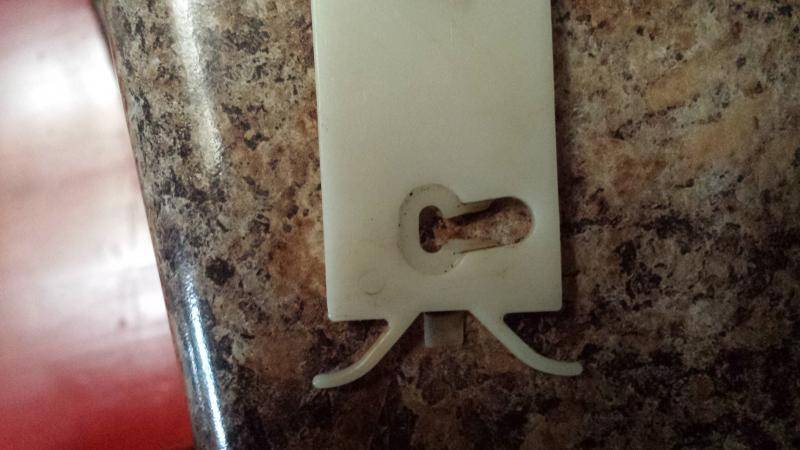

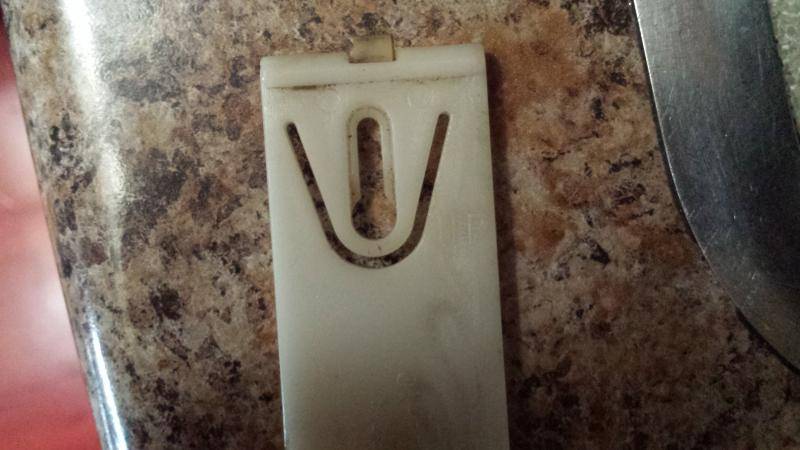

They look pretty much like this.
The little plastic pieces that look like antennae act like a spring.....you put the trim on bottom first.....those "springs" go in the bottom of the trim then you gently push up and snap the trim over the top of the clip.
They're notorious for breaking and are very brittle.

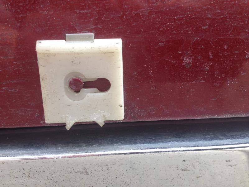

Here is your clip.
It's mounted to two pins that are welded to the rocker.
You'll notice the clips have a slot in them that allow you to slide them to the other side of the slot that's cut into them.
One side of each of the slots has a hole big enough to clear the pins.
Start with the bottom.
Tap the clip on the bottom right so you're pushing it to the left which will allow you to pull it over the pin.
Then just push the clip up and the hole at the bottom of that slot will clear that pin....and you're done.

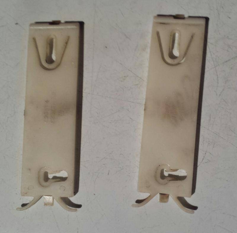

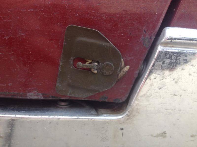

Thanks for the lead, Lowbie. But who is Marty? Do you have a link or number? BTW, my trim clips look somewhat different. They have the attennae but are shorter than what you guys have pictured.
Near as I can figure, the parts number is 600 3633. Second number appears to 96322-6. Arizona parts lists moulding clips with number 600 3663. I'll try calling them, but dunno where this will go. Sure would like my moulding back up. The LeBaron looks grubby with a piece missing. And my gas cap door is also currently off. Grrr!

View attachment 9656View attachment 9657
If Marty has them listed then you should be good to go.
