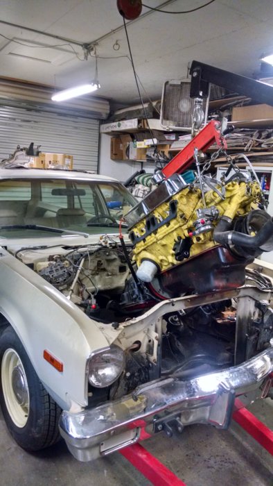

    I have a Dakota to get around now. The slant is out of the car, 360 is built and ready to go. It's just a matter of gathering parts, and then doing it. I just bought a house amd the garage needs a ton of work before I can begin

    take your time and get your workspace ready.
    collect the pieces and be ready when the time comes up.
    did the /6 to 360 into the wagon in about 2 days.
