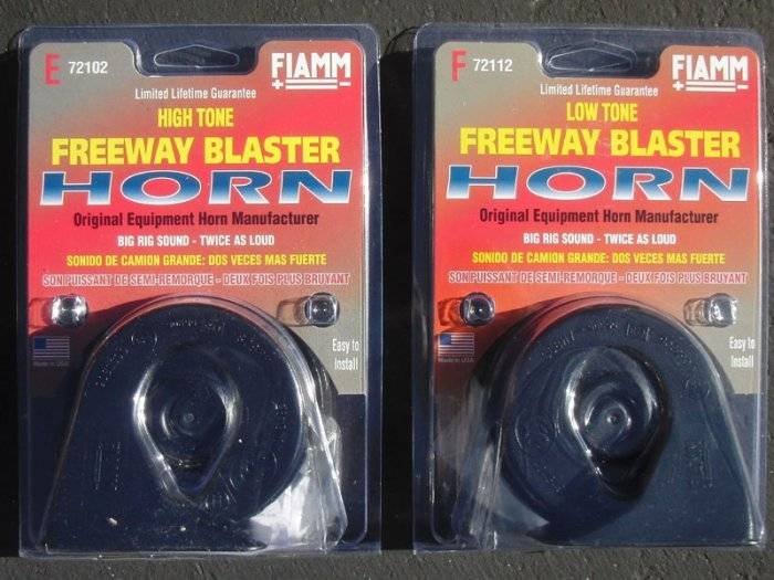

  17. Dr Lebaron
    Dr Lebaron Well-Known Member
    2,772
    583
    Aug 17, 2011
    Islamic State In Canada
    Always wanted to have a air pig in the trunk hooked up to some air horns to get attention.
    These are louder than stock.
    shadango likes this.

    Thanks...checking them out on line....also looking at the Wolo Big Badmax and the Wolo Bog Boy air horns....

    Some cities do not allow for air horns – so you might want to check on that before ordering.
