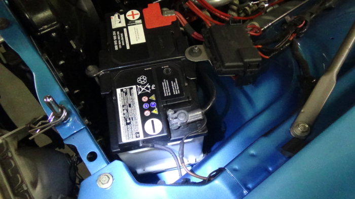

    Ideally you can install a battery with a external vent, where you run a vent tube down to under the car. That style wont corrode the terminals and added bonus, won't corrode underhood parts that are near the battery. A battery made to be inside (trunk, under the back seat, etc) the car will always have external vent provisions. This is what I mean for the vent tube (the one on my Aspen).

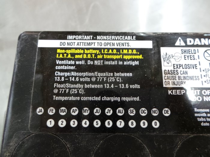

    There are indicators on how old a battery is. In most cases there is a sticker on the side of it when battery was made (not necessarily the “sell date” – but it might be close) or first shipped. I bought a battery this morning for wife’s minivan (Town and Country) and it had a sticker that says 5-18 (production or ship date of 5-2018). I have another battery that has sticker with “H16”. H is month (H = 8th Month (August) and 16 = 2016). These are two most common methods of battery age, but there might be others.
    Most batteries have punch-out numbers on top of battery, for sell date – but I don’t see that method used much.

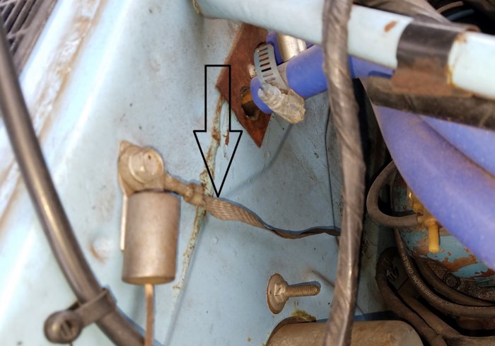

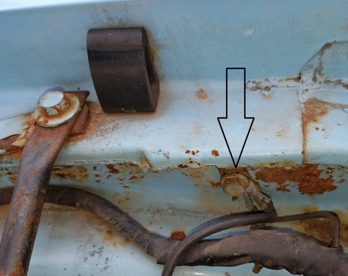

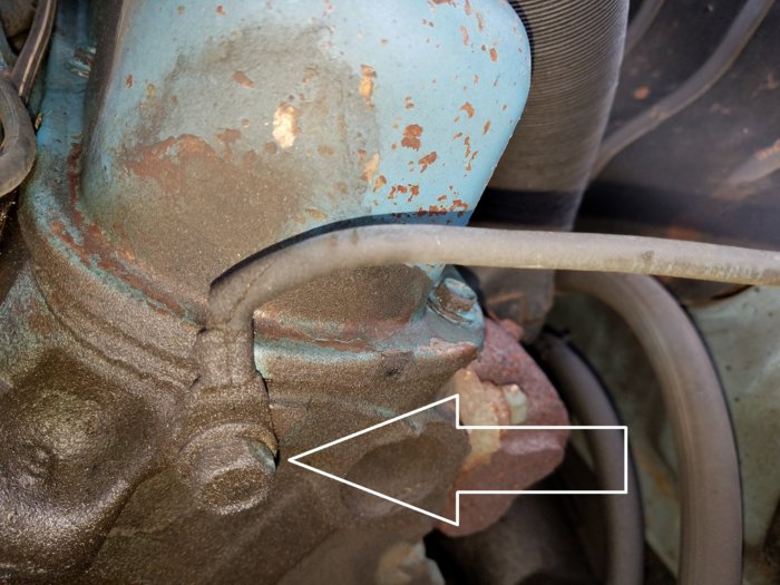

    Before performing the tests below, the battery cable ends need to be clean and tight. Also, all ground connections also need to be clean and tight. A person might need to check the negative cable connection at cylinder head, the fender connections on both fenders as well as the ground strap from passenger rear cylinder head to firewall (not easily seen or accessible).
