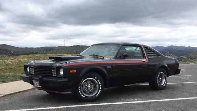

    I started with a solid Super Coupe out Redding, CA. It didn't have T-tops or the Sunroof I wanted but I didn't want a solid Super Coupe to slip away. I bought Chris and Dave's car from the following thread.
    http://www.aspenandvolare.com/showth...per-Coupbought
    Chris said it needed some TLC and it did. Tires, shocks and the battery on the 3,000 mile drive home. Although it didn't appear to use oil during the cross country trip I had leaking fluids in the garage, engine seals and a rebuilt transmission fix that.
    First mod was ditching the single exhaust and cat. I have true dual exhaust but I'm not satisfied yet. It was supposed to have T/A or AAR style mufflers so the mufflers aren't under the front seats. That will need addressing. The side exhaust tips are nice.

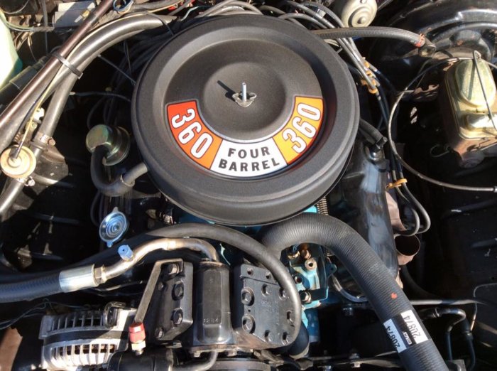

    Next was ditching the trusty Thermoquad for Holley Sniper EFI. During the install all the "smog" was removed. 1968 pre-emissions air cleaner. The engine seems to really breathe better.
    Fresh air hood scoop. The twin A-Body scoops look great but all they did was catch air. I have a nice clean hole in the hood so the trapped air has somewhere to go and maybe provides some extra cooling.
    I should have an A-Body style hood tach installed this week. I'm painting it tomorrow.

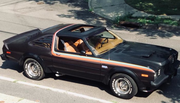

    I wanted T-tops or a sunroof. Today I got my "moonroof" and will enjoy open air cruising.

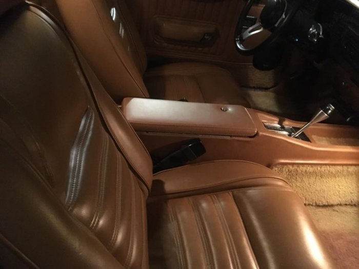

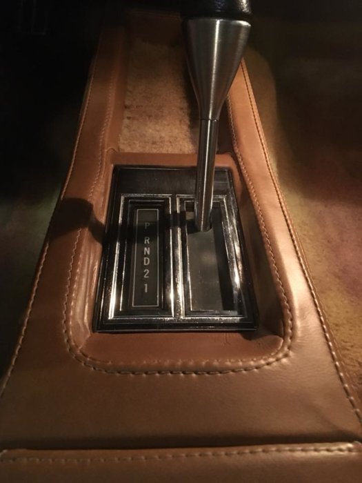

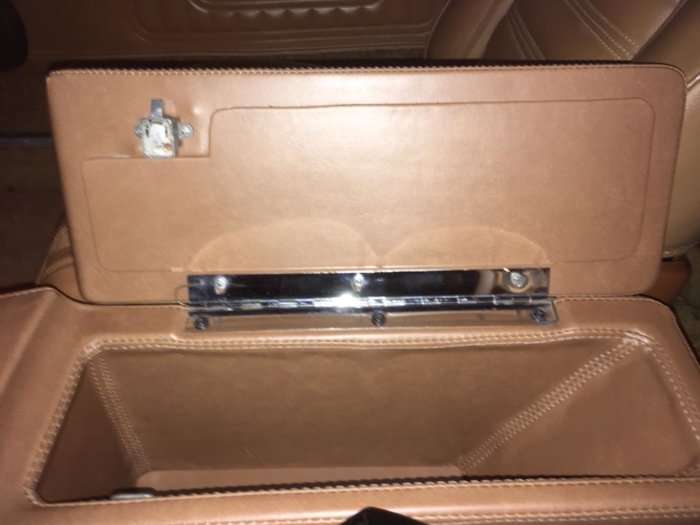

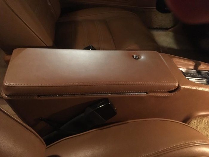

    Got the car back today from the interior shop. My console was all cracked plastic, faded faux wood, peeling faux chrome and a mismatching black lid. I had the seats rebolstered and replaced the 40 year old weather seals some of which was missing.

  10. Opticon77
    Opticon77 Well-Known Member
    84
    38
    Apr 15, 2018
    SE PA
    Oh I very much like these kinda "factory should have done it" builds.
    Stitched leather over the plastic just makes sense now that I see it. Who did that work for you?
  11. XfbodyX
    XfbodyX Well-Known Member
    283
    61
    Sep 9, 2015
    That is very nice, like something a higher end mopar would have back then.

  13. AJ/FormS
    AJ/FormS Well-Known Member
    900
    194
    Apr 26, 2016
  14. BudW
    BudW Moderator Staff Member
    3,356
    906
    I like the work they performed. The problem we have is the console lids haven’t been available for decades – nor are they being re-popped by anyone. To have a decent console – you must do something and in this case, I approve.
    It looks nice, not out of place and looks tons better than the normal (ie: cracked/split) ones.
    I think if a company would re-pop these – the would sell quite a few of ‘em (. . . but what do I know).

    I had asked ABC moparts about making the dash pad and console door for the F body. He said he was working on it but finding a good used sample part is hard to find.

    ABC said they may be doing the f body dash pad later next year. They said they were going to do the console door but they couldn`t find a good example. Anybody have a real nice one? I`m not sure any of mine are good enough.
