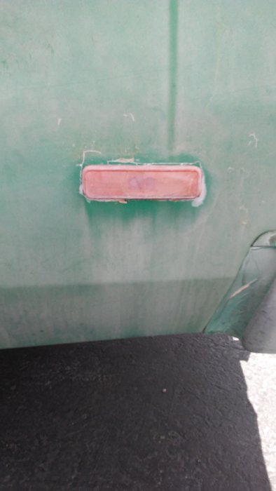

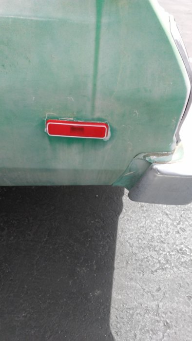

    I hope so, night driving is scary with the current pink/non reflecting lenses. Definitely not something I thought of when picking the aspen for a daily driver! I figured out the side markers: 20180317_132006.jpg 20180317_140352.jpg

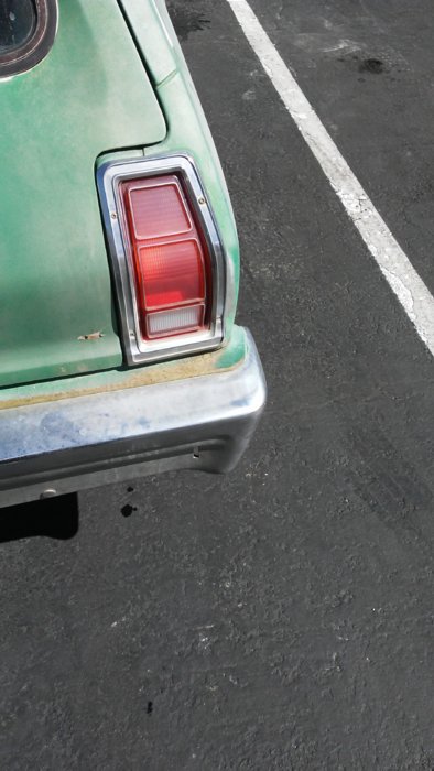

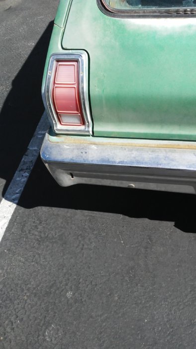

    Purposely switched to the Volare lenses, I think the look cleaner. Not too bad of a job, just heat the lenses up in the oven to about 150 degrees for about 15 minutes. Then I stuck a screwdriver in both holes where the lights go, and then carefully pushed. Cleaned with hot soap and water, dried really well, added adhesive and installed lenses. Took about an hour and a half all said and done.

    Thoroughly scuff the lenses with either a scotch brite or 1000 grit sandpaper. Then clear coat with your favorite clear, lacquer, urethane whatever. The tail lights will look like new.
