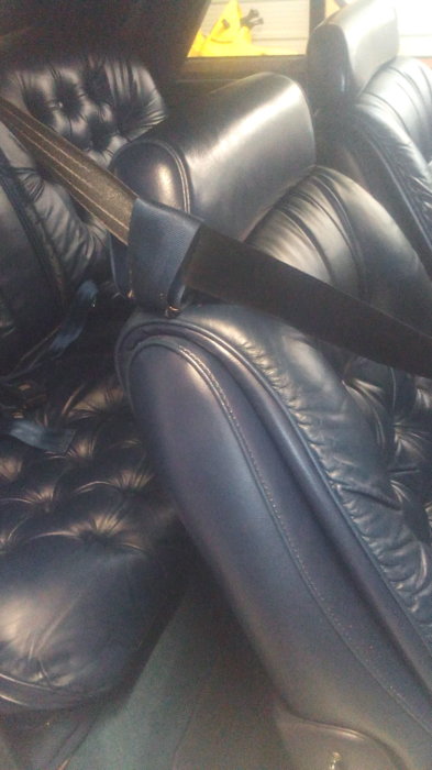

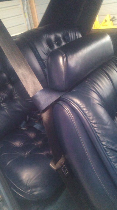

For those who are interested Mr Volare Imperial and I came up with an ingenious way to get rid of them, I had some old seat belt webbing, I made it into a loop and connected under the head rests. Its works very nicely and slides smoothly. It lowers the belt to go across your shoulder rather than cut into your neck, its an easy mod and looks nicer I think.

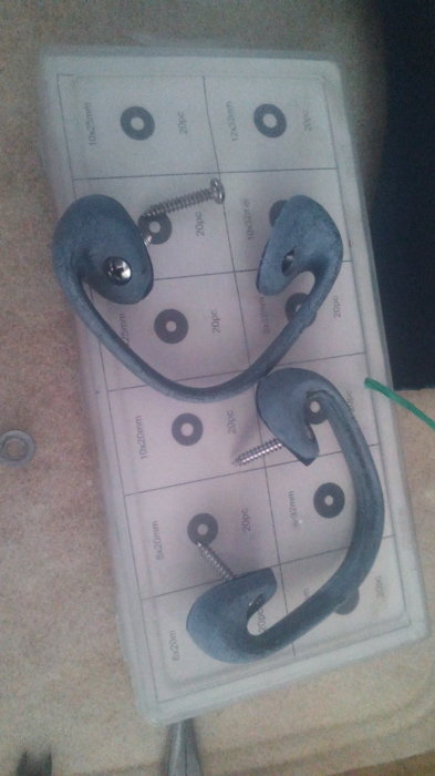

yucky and faded!
Retracted
Belt locked into place.
