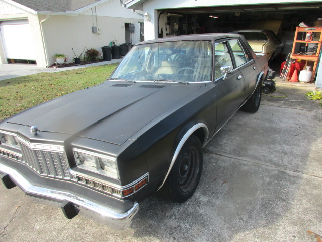

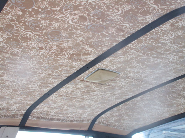

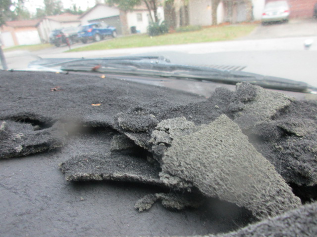

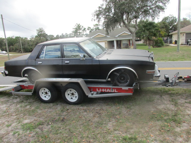

    New here. Today I rescued a 1984 Fury that had been sitting for at least 3 years. Car has a Bed sheet for a Headliner. An old Carpet Dash cover. When I rescued the Car it had 3 flat Tires. Pictures of the Car in the Driveway were taken when I got the Car home.

    Welcome Coronet 14! Your Fury looks like a nice find. Is is black or dark blue? What's under the hood? /6,318,360? What are your plans for it? Appreciate the pics - we like pics! I also like that Coronet lurking in the garage in the background. What's going on with that one?

    It appears that the Fury was rattle canned Black on most of it. It appears that the original color is dark Brown. I was able to get it running and drove it onto the trailer. Drove it off the Trailer at my House. Car is a 318 with front brakes only and no Radio. I'm going to do some work to it and drive it. The Coronet I've been working on it for a few years now. Still not even close to being done but I drive it. Trying to find some upper quarter panel sheet metal for the Coronet. I rescued the Coronet from North Carolina.

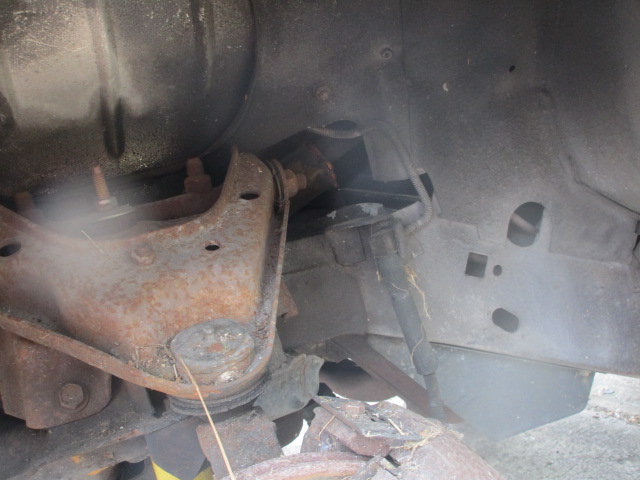

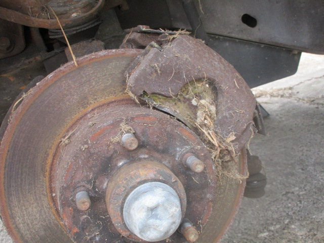

    This car appears to have two front sway bars

    I think you are looking at the torsion bars, they're transverse just behind the radiator. The sway bar runs through the center of the k-frame.

    That would make sense. I didnt see the torsion bars going to the trans crossmember. The underside of the car is covered in spider webs and eggs. What Shocks are you all running on these cars

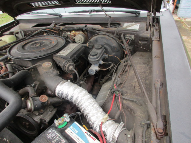

    What are those two ? contraptions ? under the air cleaner snorkel ?

    I like the drier vent hose it has bling.

    Heater core inlet/outlet are plugged. I bet the core is bad and the previous owner just plugged it rather than fix. It's a big job and you won't find new ones that fit. They're advertised, but the dimensions are wrong. I had my factory one re-cored at a local radiator shop.
