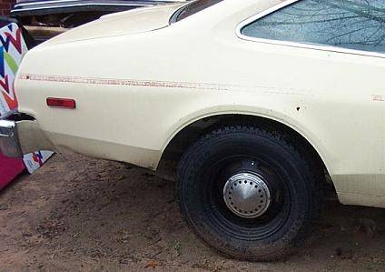

I went out and looked at the sticker on my 80 Volare,
and its says Minimum tire size is 195/75/R14
Which is too small IMO.
I just put 225/70/15s on it,they fit nice and raised it up.

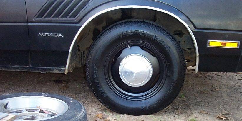

Look at CL for tire deals, I bought 2 215/70/15s for 20.00
There now on the front of the Mirada and look good.
I usually run 225s on the front, but for 10.00 ea, I'll run the tread off of them.
--- Post updated ---
I think he said he wanted to keep the 14's.
Any ideas a good size to go with for those?
Capt.what did your Volare have on it before you switched to 15s?
