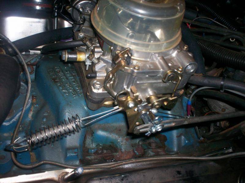

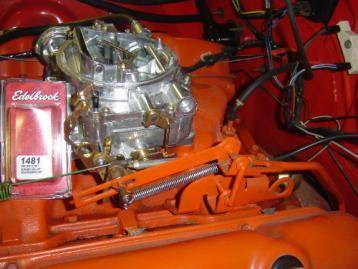

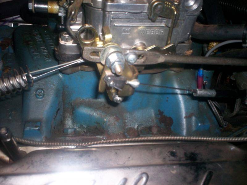

I saw a video tonight of the trans throttle arm movement that looked opposite of mine. My trans throttle arm moves in the same direction as the throttle cable. For instance I hit the gas and the throttle moves towards the firewall. I release my foot and the throttle goes towards the radiator. All the time the trans throttle arm moves in the same direction. the video I saw has the trans throttle arm connected at the bottom of the pivot, so it goes in the opposite direction of the cable. I've tried to move my trans throttle arm to the bottom of the adapter for the Edlebrock and it hits the adapter on either side I try to mount it. Anyone else running an Edlebrock Performer and have interference issues like this or am I over thinking this?
