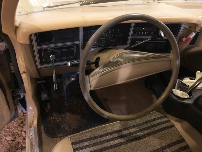

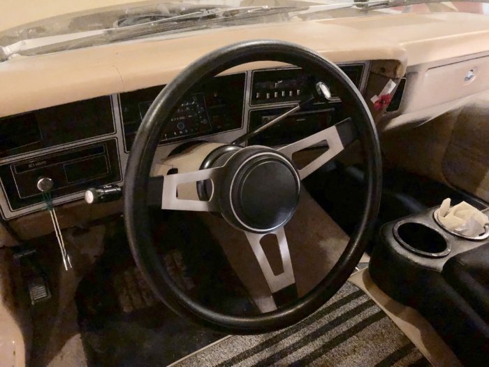

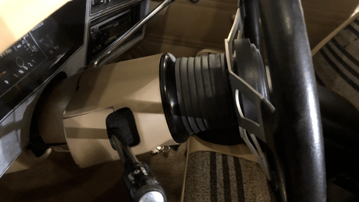

pretty straight forward, you have to buy horn kit plus spacer to make fit first time, and had to stretch spring for horn for a bit more tension. but everything went easy . facory wheel hasnotch that lines up on column ,Grant does not have notch, so it will line up anywhere , make sure you center shaft and mark it .
