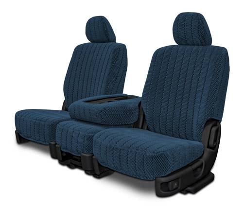

    My Cordoba has a nice blue interior and I have been looking at ways to get it looking tidy, the material has gone hard and every time I sit on it splits appear, its starting to look like someone has taking to it with a knife at the moment. Asking around here I was shocked when the quotes come in at $2000, this left me with a couple options, do it myself (which I have never done before) leave it alone, get some seat covers which to me always look not as good as they never seem to fit right. Then while surfing the net looking for material that would suit my car I came across a place that make custom made seat covers to suit our cars! These are not a cheap option but still come in at a 3rd the price of getting the upholstery redone, I plan to take all my upholstery off and fit these covers on as if it was upholstered.
    I have ordered some Scottsdale Navy Blue front and back seat covers. When done I will post pics, if it doesn't work out I have some pretty expensive material :)
    Scottsdale Seat Covers | Seat Covers Unlimited

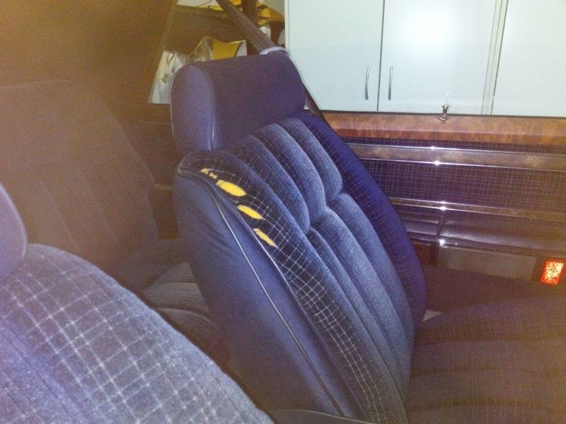

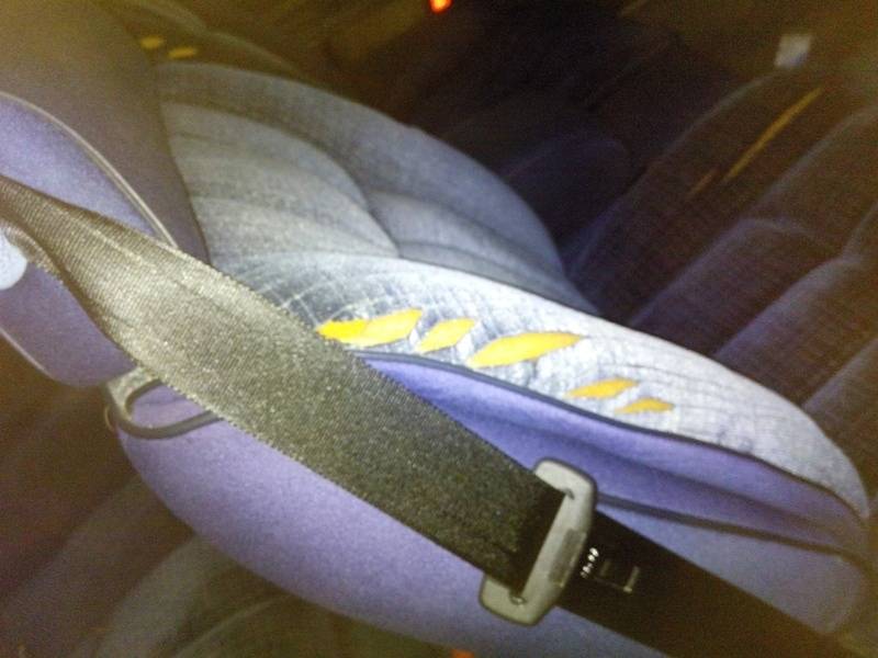

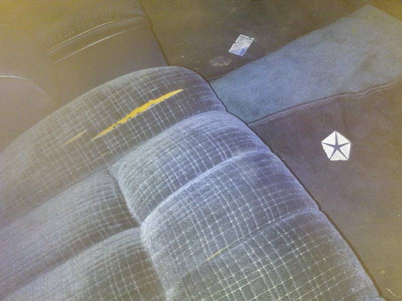

    Well I will try these seat covers out, they do look smart and made for a good fit! What ever way they have to look better than split and faded material.

    I believe you are going to be pleased. I have had great results with the custom fit units. I'm not a fan of putting covers on new seats, but I'd much rather look at un-torn seat covers over yellow stuffing oozing out of ripped originals! Post pics!

    Every time I look at the pictures of your seat in this thread it reminds me of something. Couldn't figure out what. But that fabric and print.
    Just out of reach in my brain.
    Til just now.
    I would swear that in the 80's my dad had a recliner with that same fabric.

    Those are sharp looking covers. Best of luck.
    I've done it once before. Here comes the free advice.
    Used muslin over the seat foam so the new covers would slide around easier than foam against foam. Others use the thin plastic from the dry cleaners.
    The new covers did not include new listing rods so 10 gauge solid THHN wire was used and locked in onto each end of the listing rod pocket.
    There was alot of moving the new covers around, adjusting here and there, trim some foam, add some foam, etc., so ty wraps were used to achieve the correct postion of the seat cover, gradually tightening the ty wraps before the hog rings were installed. It was a learning experience.
    I'll be looking for your photos of the new covers.
