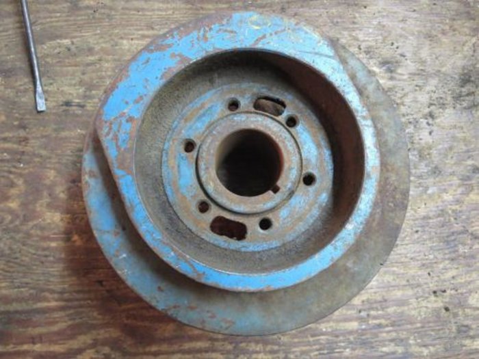

    I can tell a (original) 360 just by looking at the harmonic balancer. A lot quicker than looking at the other two locations (cast marks on side of block or engine number stamped in front Left side of block) mentioned above.
    Now the other 2 areas are needed information, especially before a rebuild or repair (or purchase), etc.
    Now days, with the small block stroker kits (which are internally balanced) – you have no clue as to its displacement.
    Stock 360 harmonic balancers:
    Most common version

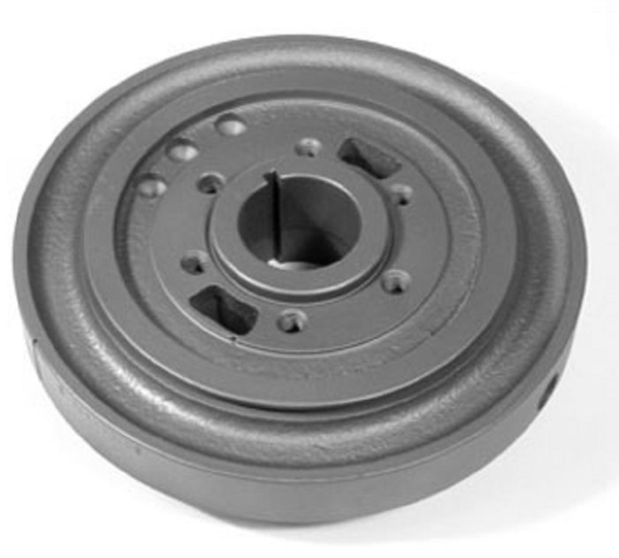

    Less common version

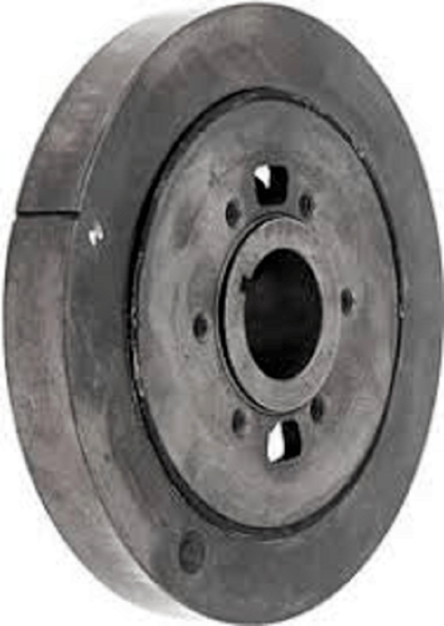

    318 (can come both ways)

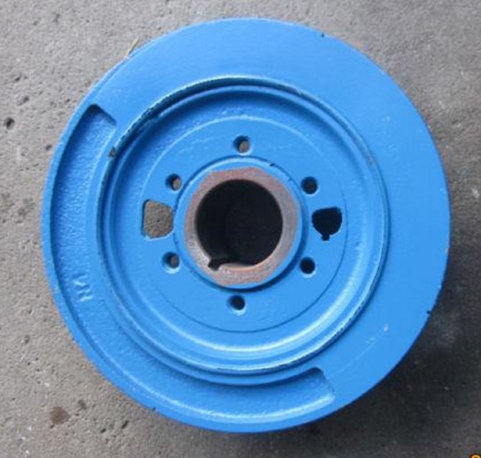

    This one is for a 440 but it looks almost the same. For some reason, the outer ring is placed with cupped side rearward (top picture) or frontward (lower picture) – but is basically the same exact part.

    External balance 340 uses a balance that looks like the early 360 balance (Buds first pic above) it is also not uncommon to find internal balance 360s among the high performance rebuilds in the market. There are also aftermarket dampers that have the weight on the backside of the damper
