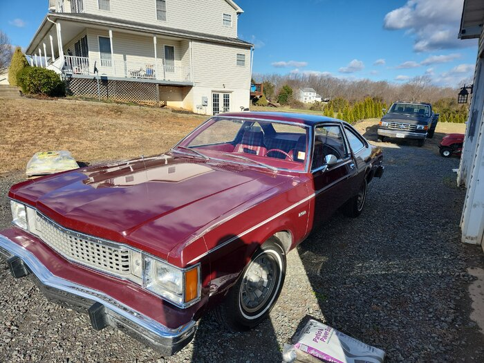

Well the Duster arrived in one piece and is in decent shape considering it is a 42 year old car. It's paint is in excellent shape for the age and will remain. After going front to back on it. Some things that need to be addressed. The horn did not work and the windshield washer pump did not work as well. The horn was an easy fix, the relay was bad. The washer pump seems to be the switch. I will double check the connections and ground as they were pretty oxidized. However, after replacing the pump and giving the connections a quick cleaning and having no power at the connector I am leaning towards a bad switch. As it sits right now, the car needs rear springs (they are S shaped), tailpipes, maybe proper head pipes. The decklid needs to be refinished, and it needs a new Plymouth emblem for the decklid. Once the exhaust and washer pump are working I can get the car inspected. After that I can address some of the little things like ISO delete and rear springs, cosmetics and paint, front seat foam and upholstery and upgrades.
