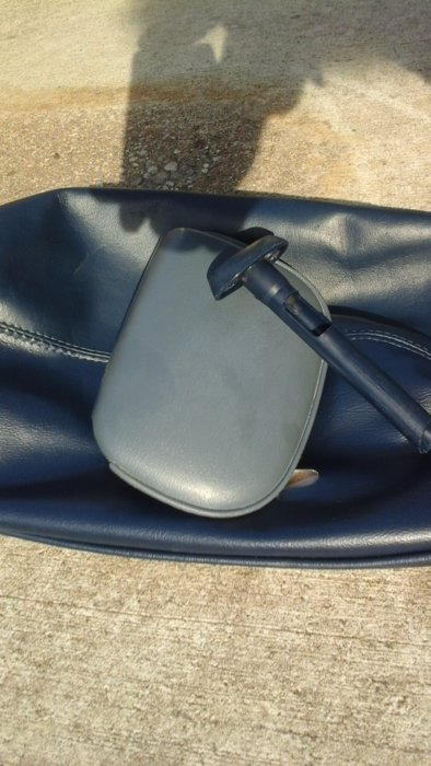

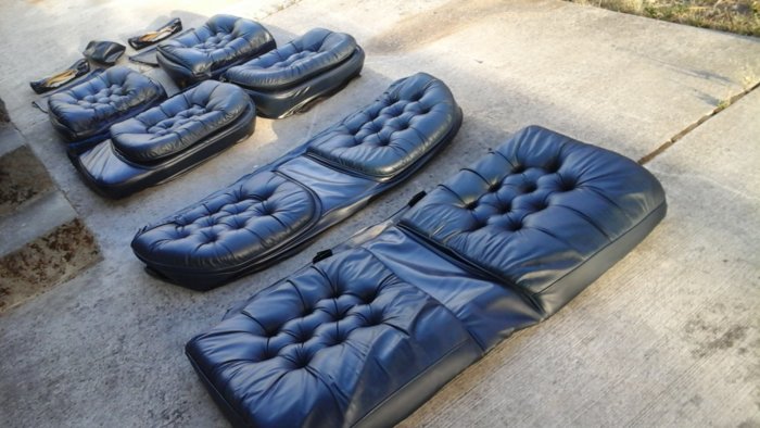

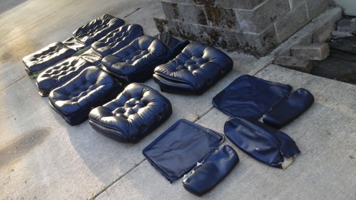

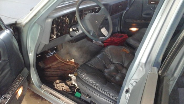

    I just pulled these leather 5th Ave cover assemblies out of a nice 86 in California. They're really high quality covers, and they were easy to remove off the seat frames for the shipping I'll need to do. More of these should get saved.

    I'm wondering on how to get those installed into my wagon (with fold down seats).
    It might require a new vehicle paint job - so my current B5 (French Racing Blue) paint might have to go.
    Sigh, French and racing are two words that don’t go together, often. Where is Chrysler come up with that paint color name?
  11. Mr Volare Imperial
    Mr Volare Imperial Well-Known Member
    224
    22
    Jan 15, 2016
    oregon

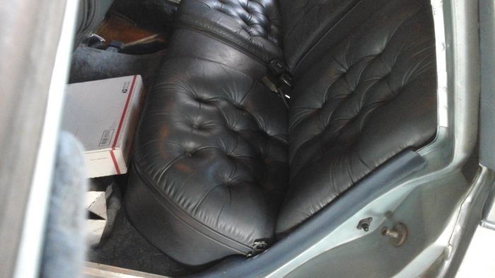

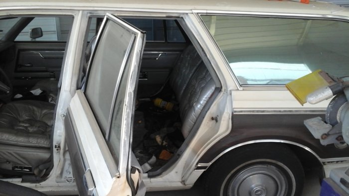

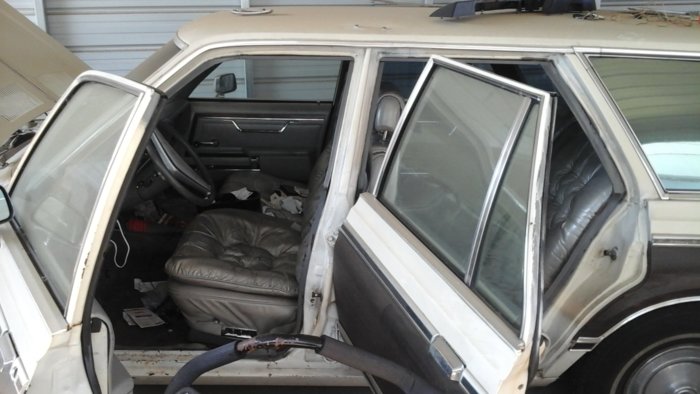

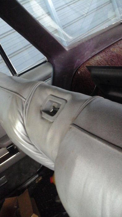

    Easy, I did it with my '77 Volare Premier wagon's fold down rear seatback. It just hog-rings on the same but you have to do a specific tuck-under at the sides where it wraps over at the top. Then you have to cut a hole for the release button and it's plastic nacelle. Not difficult.
    Its highly recommended to keep you leather skins treated with conditioner products, I like Leatherique's pH balanced products, they have a good leather restoration tutorial on their website and how their products naturally work together.
    There was one area of the leather on these blue seats that was especially broken down, right along the area your backside first slides across getting into the driver's seat. The little bit of Leatherique's "Rejuvinator" conditioner that I had left, with some of their cleaner and a light going over with some 1000 grit sandpaper made that area look and feel like new again and they should give a long life ahead of their already being 30 years old.
    Thats a big benefit of leather, it can be restored over and over, and holes/tears are pretty easy to remedy. A little dye over it and topcoat it with some gloss, its hard to tell it from new. Kerry Pinkerton on the Imperial site gave a good write-up of the process he used on his '64 and '73 Imperials
    Refinishing (Chrysler) Imperial Leather Seats by Kerry Pinkerton

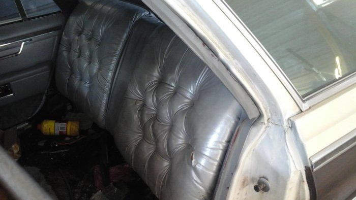

    FYI, those are normally a satin finished leather, but I lathered on the pearlescent topcoat Leatherique sells to the light gray. It was something luxury cars used to use back in the '60s. Over the gray, it makes it silver.

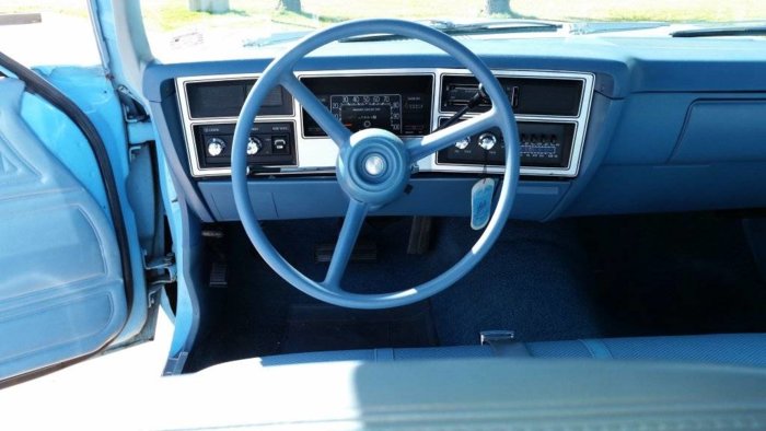

    My problem is light blue car, light blue interior and (sigh) vinyl seats.
    I don’t recall seeing light blue Leather seats in an FMJ before.
    I have seen, what I would call medium blue cloth seats and the dark blue ones (as pictured).
    Being my interior is “light blue” – it would be a lot of work to change color of all interior and trunk items to medium or dark blue.

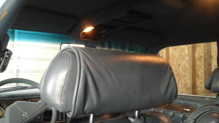

    I went from dark maroon to light silver...
    I would use the new stretchable vinyl over the hard plastic pieces instead of painting them, if I were to do this again. The spray dye works great on the soft vinyl fabrics though.
    For the 1988 model year, new interior colors were specified. The gray and red stayed the same, to my perception, but the former harvest gold yellow got really muted down to a fairly tolerable tan, and the dark blue got lightened up to a medium gray-blue, for both the cloth and leather interiors.
    I changed over the dashboard and 1/2 rewired my cluster connector, was a pain and still only 1/2 done, but that got me the gray dashboard. The door panels are a straight across trade, note my power roll-up windows!

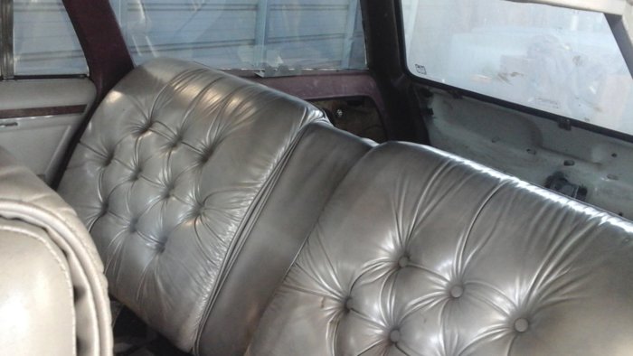

    my '88 5A's medium blue leather against the earlier dark blue.
