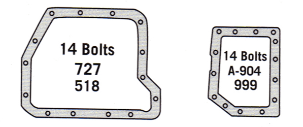

What does your transmission pan look like?

The A904 (A998/A999/A500, etc.) pan gaskets are almost the same as the A727 pan gaskets are – all except for one corner – the Right Front corner.
This is to help elaborate on @Camtron post a tad.
A727
A904 (or variations).
Both pictures are looking from underneath the transmission and the bottom edge of both pictures facing forward.
