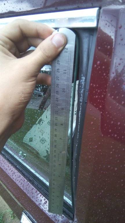

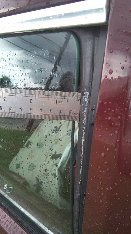

    1470423815616236165957.jpg 1470423855053377802541.jpg here's the gap. Think it got worse

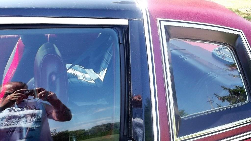

    Yup ... that's exactly like mine was .. I just rolled up some foam packing in behind to push the rubber out .. and you can't tell I cheated .. but then again mine is far from perfect ... just perfect for me ... lol

    Yeah. If you look on the seal, you will see duct tape residue from the several times it taped the door shut. I had at one point got someone to drive it home before more rain came. I was @ work and didn't want to risk anything, though what could I possibly risk.....

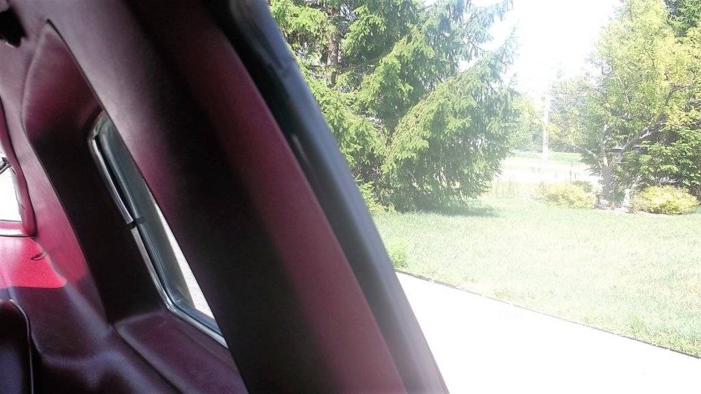

    I have to agree with the manufacturing defect .. you'll see a slit where the soft rubber meets the hard corner rubber, I'm just gonna put some glue or goop on it .. and in the 2nd I pulled the foam stuff a bit so it shows.
    Oh and I purchased it from the SuperSoft place advertised here ... on the other car they came from a different supplier(forget who, but have seen the name somewhere in this forum) but their quality wasn't much better .. no separation but poor fit. I didn't have much wind noise before but the outer rubber was crumbling away .. now if I have wind noise at speed I just re-roll the window back up and all is quiet (sorta) lol
    Took these on the hottest day at the hottest time of the day ... sry. for the poor quality I can't take this heat .. lol
