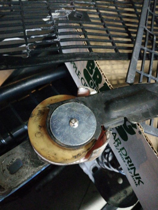

    Hi everyone,
    My wipers stopped yesterday, the nylon thing on the end of the wiper motor broke, does anyone know where I can get a replacement?
    A quick search on eBay didn't reveal one but not quite sure what it's called.

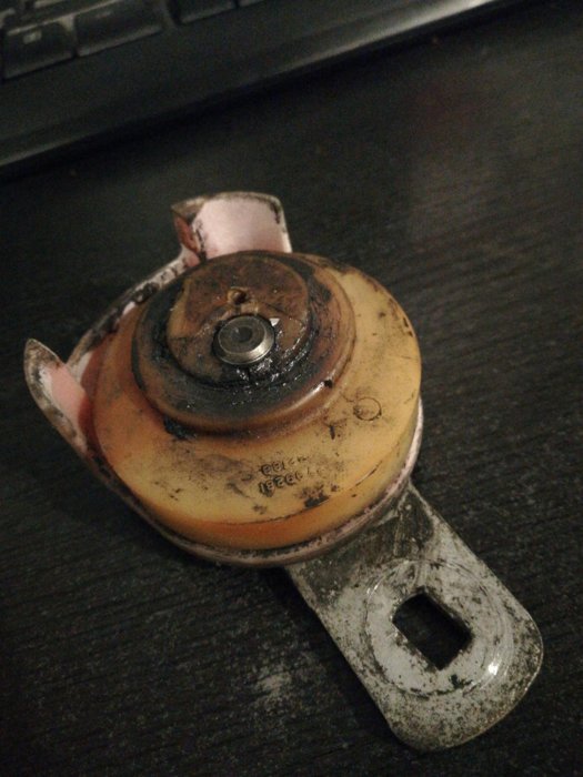

    Nope that didn't work, the nylon just old and rotten, screw pulled out!:confused:

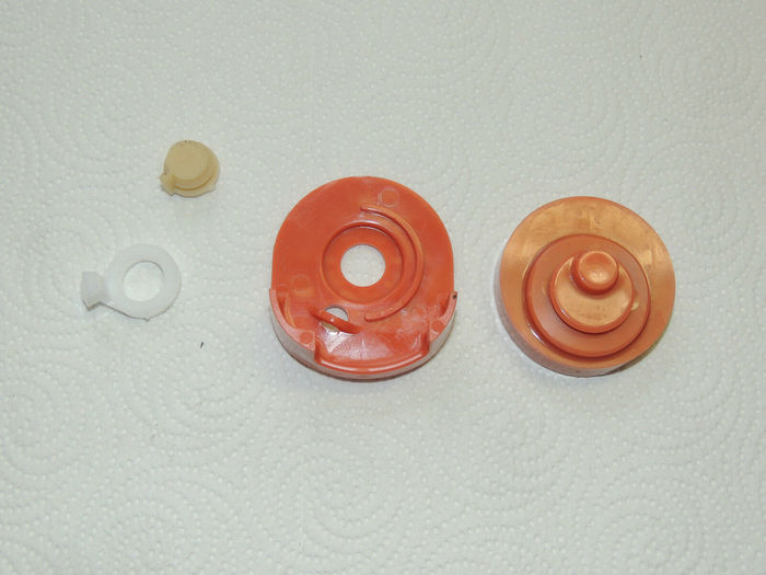

    Can't help you with a diagram or photo. My car doesn't have the big nylon piece, only the small ones, same as used where the links hook to the wiper pivots.
    The links get pressed onto the wiper pivot "pegs". Chances are you may need new bushings there also, and they are available. If at all possible, get them from a Chrysler dealer. The Dorman aftermarket ones are pretty much crap (Made in China), but will work if it's all you can get.
    It's easier to remove the pivots from the car and assemble it all on the bench and then thread it back in the opening. Trying to reattach the links inside the cowl is about impossible unless you have fingers of steel and bionic tendons.:p

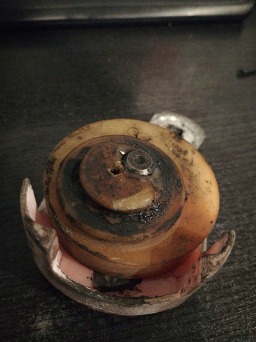

    Everything is stripped out

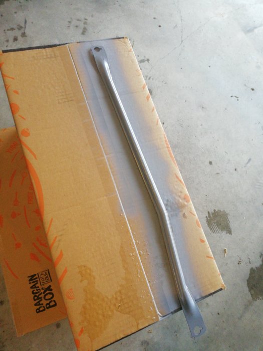

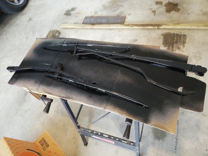

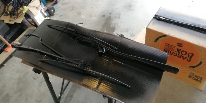

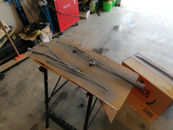

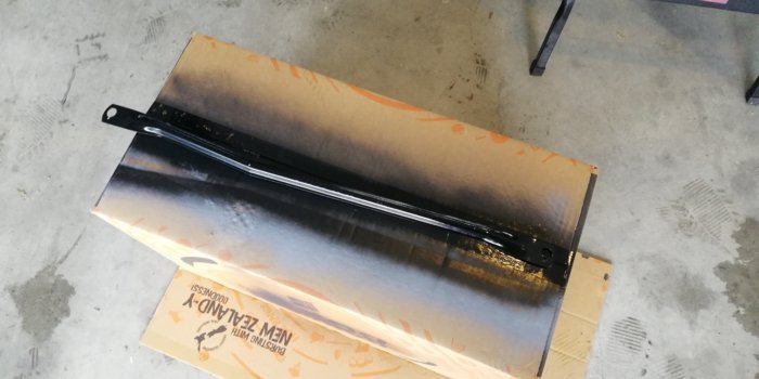

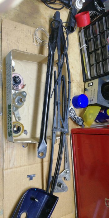

    Ok the window wiper restoration has started, all new parts ordered and already have a rebuilt wiper motor, painting wipers today, they are in primer. For good measure took a photo of my garage wall :D 15635727076921336941630.jpg 15635727280921972942143.jpg 15635727453331523829157.jpg

    First coat of paint on. Let that dry for a bit and put another on.
    I think I just proved I am a true moparian down under!!! :D
