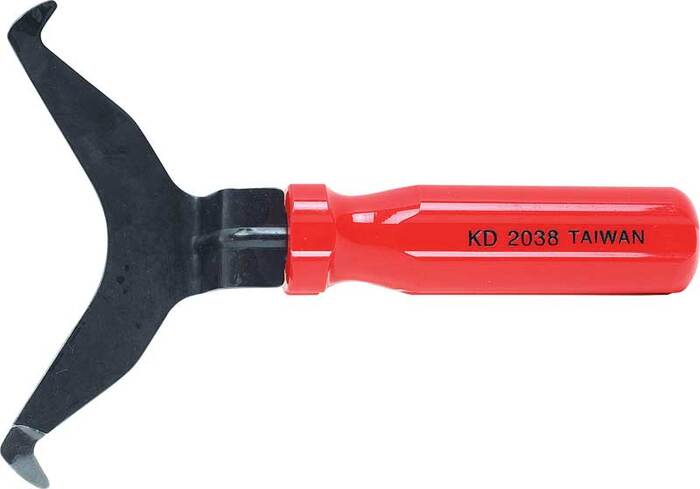

I found a Fifth Ave in a junkyard a few towns away, I'd like to replace the windshield trim they bent and warped all the old trim (and broke most of the clips) when they put the windshield in and claimed they'd pay to replace it this was 2017...never happened I bent the pieces back together as best I could but some of it sticks out and I don't need sand getting in and rusting the windshield frame...how hard is it to remove the trim? Is there a special way to take them off or a special tool needed?

You need a special trim tool and then it's fairly easy to release the clips and NOT bend the trim. It slides under the trim piece and then you slide it along until you find a clip. Then use the tool to gently pull the clip away and the trim piece will come loose. Then just move the tool to find the next clip, lather rinse repeat.
https://www.napaonline.com/en/p/SER...g+Tool&keywordInput=windshield+trim+clip+tool
New clips are readily available also.

For the price of new clips, it doesn't make sense to reuse old ones, even if they look OK.
There's a small learning curve with the trim tool but once you get the first clip released, it becomes obvious.
