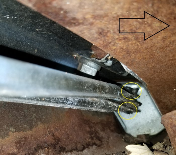

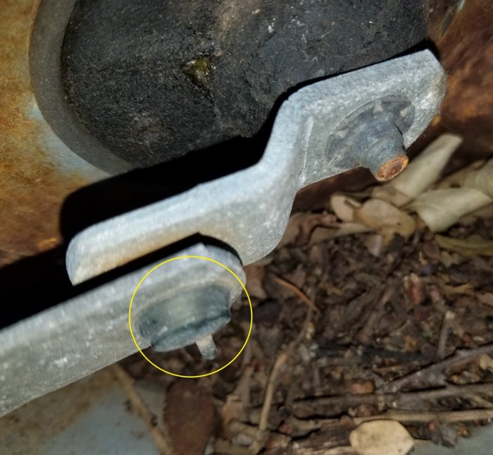

    I pulled the black cowl cover off my ’77 wagon yesterday, and it uses 4 of the plastic wiper bushings (like what Aspen500 posted). Beforehand, I would have bet $ it had a metal clip on it, at the wiper motor (but good thing I didn’t bet).
    The last picture is with cell phone stuck down onto the cowl, looking towards the L/F upper door hinge. The arrow is pointing towards the front of car. Pay no attention to leaves/sticks/crud that I've been saving . . .
    It has been a long-time sense I’ve seen a non-white/yellow plastic wiper bushing (see yellow circles, above).
