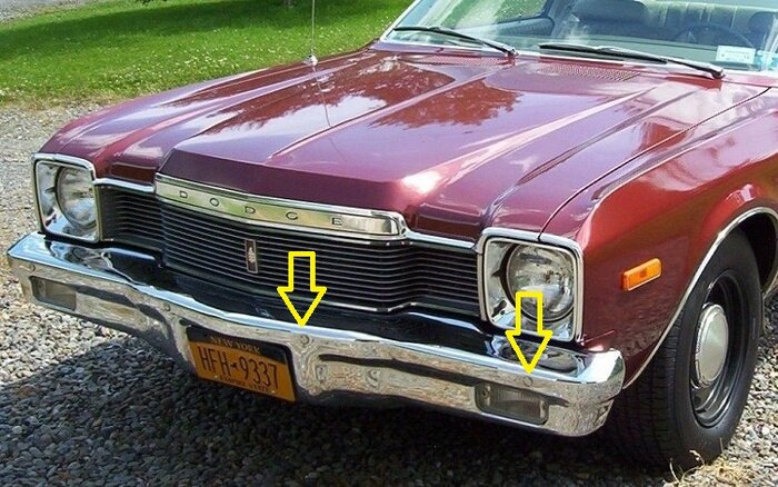

'76-77 Volare front bumper is different from '76-77 Aspen (Aspen marker lights are in bumper/Volare are in grill).
Also, the bumper reinforcement is different between '77 and '78's. That said, I "believe" '78-79 bumpers are the same.
Attached is copies of my part manuals (in PDF form) to show part numbers and such.
Also "H" is for Volare and "N" is for Aspen.
1977 Aspen

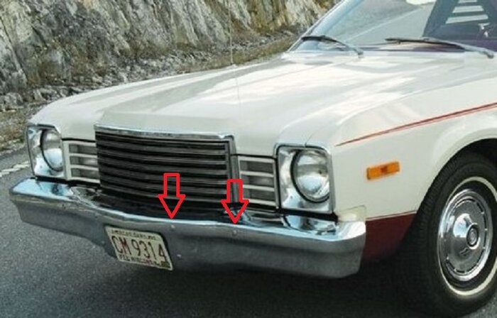

Yellow arrows (above) and red arrows (below) is bumper bolt locations.
1978 Aspen
To do a better comparison, I used bumpers without guards or nerf strips.

You are correct. I am restoring my 1978 Aspen Super Coupe and am trying to find all the parts. I found items 11, 13 and 20. Missing all other parts. All I really need is the missing brackets and absorbers. Had to dig up my old Hollanders (1984-1974) this morning. 1978 and 1979 are interchangeable.
