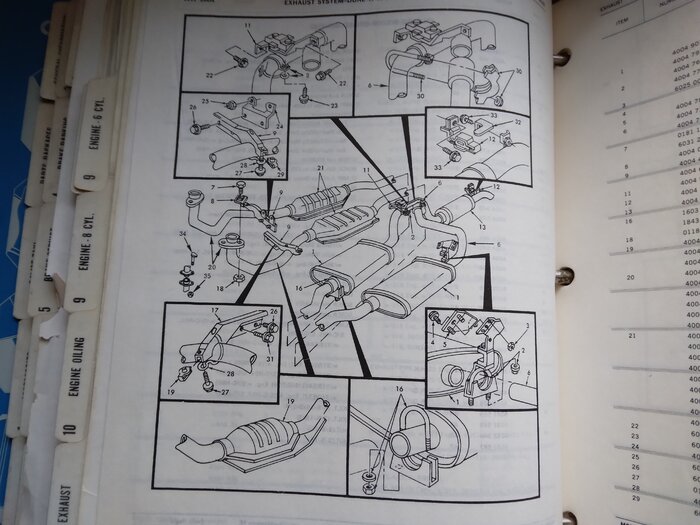

I need to do some digging but they never came with a true dual exhaust. They ran 2 bigger pipes that connected just before the gas tank and then joined together into a single 2.50 pipe with muffler. I had pictures I took at a junkyard of one that had fallen on it's side and the exhaust was obvious. I didn't pull it because it was not true duels.
7,076
2,793

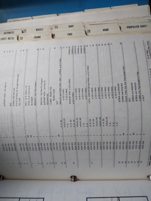

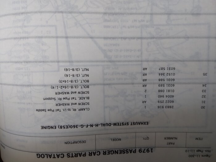

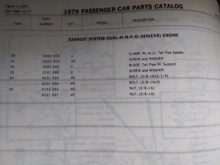

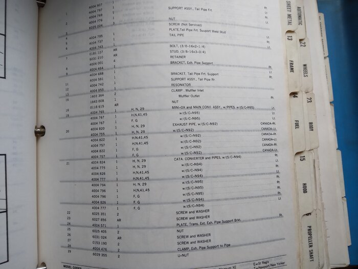

This is a photo from the 79 parts catalog for the dual system.
Seams like 3.5 inch pipe would more than cover the needs of a warmed up small block but the idea of single exhaust sucks.
