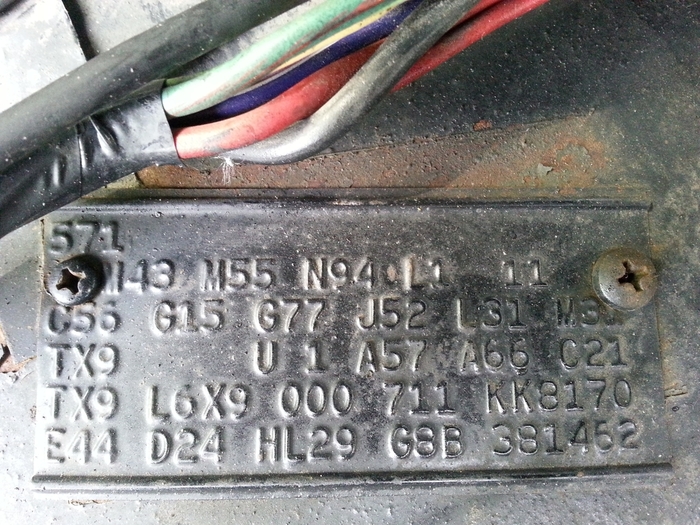

The fender tag is mostly decoded there are a whole bunch of codes that are not showing up though. but what does decode matches the car less the mirrors. tag says enamel but the car has chrome.

If you can get the fender tag codes (photo of the tag, a pencil rubbing, etc) I MAY be able to help decode it more.
You do mean the metal tag under the hood? Wondering because you mention a code for mirrors and that's not on the fender tag.

here ya go.

ETA: fender codex moved up to fender tag pic.
C 21 Center front cushion with armrest (captain Caravelle)
C 56 Bucket seats non recliner (captain Caravelle)
D 24 4 spd O/D transmission (captain caravelle/root)
E 44 318 2bbl ( captain Caravelle/root)
G 15 Tinted windshield only (captain caravelle/root)
G 77 Dual O/S mirrors REM/PNT/RAC (captain caravelle/root)
M 43 Grille trim moldings (captain caravelle)
M 55 T bar roof (root)
N 94 ESA with catalyst (captian caravelle/root)
J 52 Instrument panel mounted hood release (captain caravelle/root)
L 31 Turn signal lite hood/fender (captain caravelle/root)
TX9 Black paint (captain caravelle/root)
000 non full door panels (root)
n94 esa w/cat/con/75/up lean burn unleaded only( aspen500)
N94 fresh air hood fiber (root)
M55 T bar roof (root)
t31 head/fnd mount turn signals (root)
381452 VIN ( dodger roger) partial vin
L6x9 trim (dodger roger)
711 July 11th ( dodger roger)
KK8170 Order number ( dodger roger)

Might have misspoke on what's on the tag (like mirrors). Give me a little time, I have absolutely no idea what I did with my decode book. It has to be here somewhere, I hope!
All I got right now is probably what you've already decoded (engine, trans, plant, etc).
As we all know, what's on the fender tag and/or broadcast sheet isn't necessarily how the car ended up being built. Mistakes happen.

Yup those are the ones I have plus I found
Missing
W30
L1
HL29
68B
A47
A66
021
056
Rich
ETA:
The ones I found that you didn't mention were on a B body site. and some of the codes I don't have match 68 paint schemes. so I am lead to believe that fender tag codes were reused and redesignated over the years for different body styles.
The ones that matched though made sense since I was able to physically fine those options on my car.
like the fresh air and Tee top codes.
ETA: to update found tag codex

381452 is part of the vin number the first line on the bottom of the fender tag reads as follows : engine e44 ; transmission d24 : the vin number HL volare low price 29 2 dr special coupe G 318 2 barrel 8 1978 B built at hamtrmack 381452 her sequence number

Fender tag is original to the car. evidence that supports that is:
All the matching numbers like paint, tee top, tranny, motor.
He said the dent was there 20 years ago. The paint/decal match the age to the rest of the car. Spare fender has been with the car since he looked at it 20 years ago so the dent is at least 21 years old.
And the screws on the tag don't appear to be messed with ( evident in the pic)
