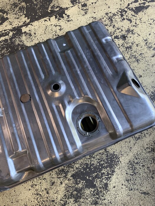

Jul 29, 2020 #1 Dylan Bobek Active Member Joined Jun 5, 2020 Messages 40 Reaction score 0 Location New Jersey Why is there an extra hole on the new fuel tank does any one know what it’s for
Jul 29, 2020 #2 80mirada Well-Known Member Joined Sep 3, 2012 Messages 1,580 Reaction score 627 Location Wisconsin, Fort Atkinson vent valve goes there on 80 and up cars.
Jul 29, 2020 #3 Aspen500 Well-Known Member Joined Feb 14, 2015 Messages 7,066 Reaction score 2,792 Location Rib Mountain, WI Yes, it is for the rollover vent valve. Also used on '79 built after May something (like my '79). Not sure how you would block the hole off for use on earlier cars.
