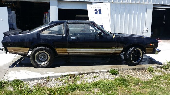

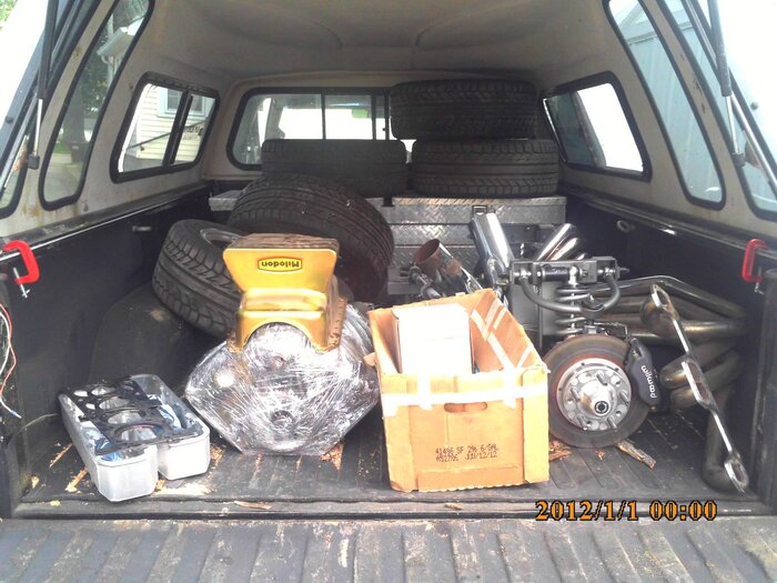

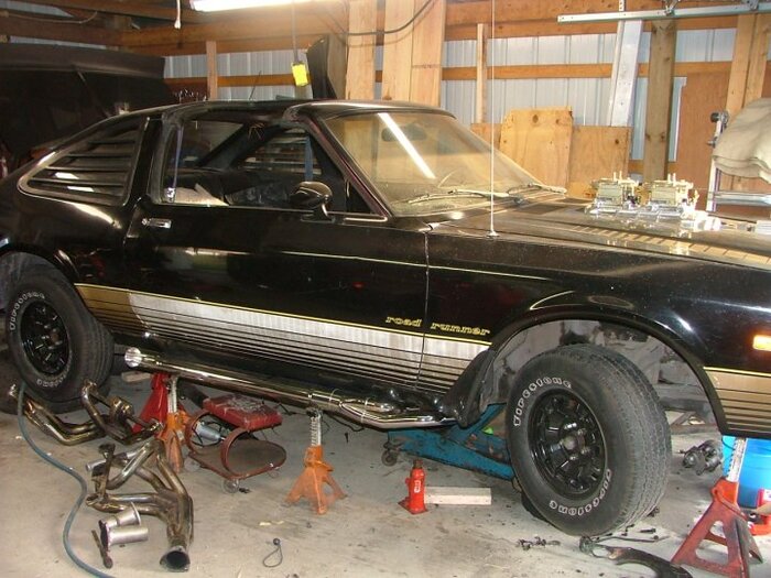

ok finally making some time to start a build thread,
Goal for this car is fun driver able to keep up with the newer cars on a parking lot auto cross course, and drive cross country if wanted.

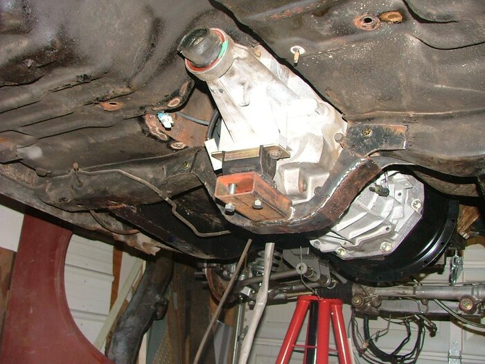

Drive train
Transmission 1996 T56 out of dodge viper with .50 to 1 6th gear.
Rear end Ford 9 inch 3.91 with truetrac. and caltracs.
360LA based 410 cubic inch
Edelbrock 60779 ported heads
Eagle crank and rods
SRP pistons
6 pack will go back on when I have time to tune the idle issue

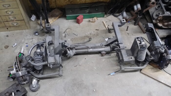

RMS alterkation front suspension

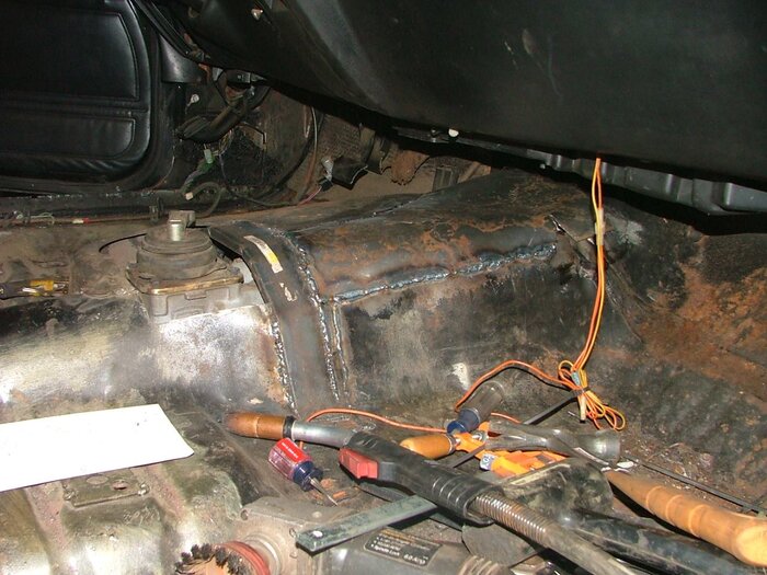

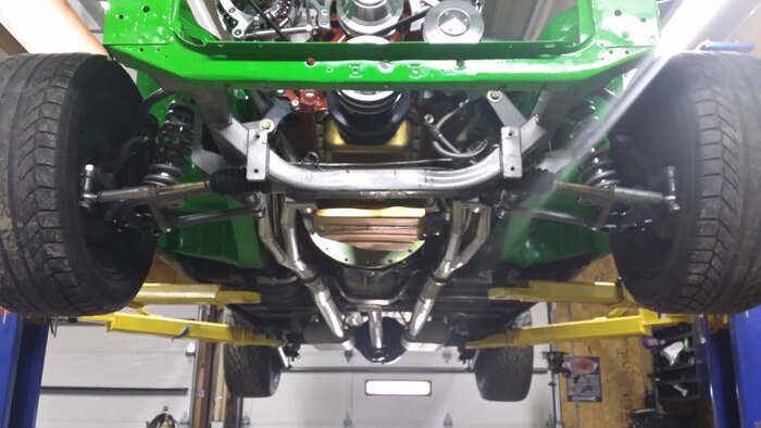

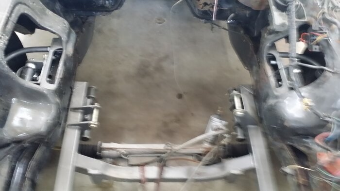

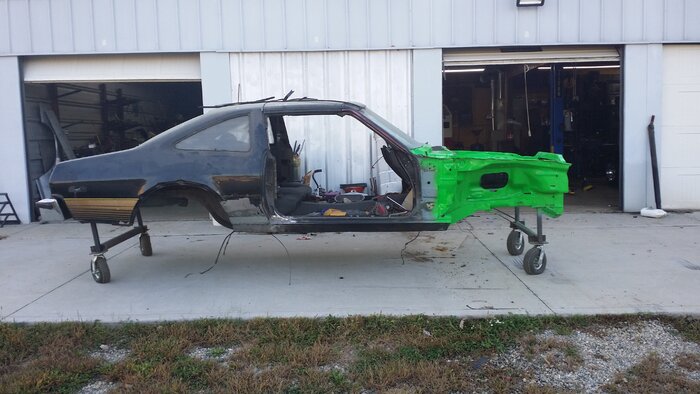

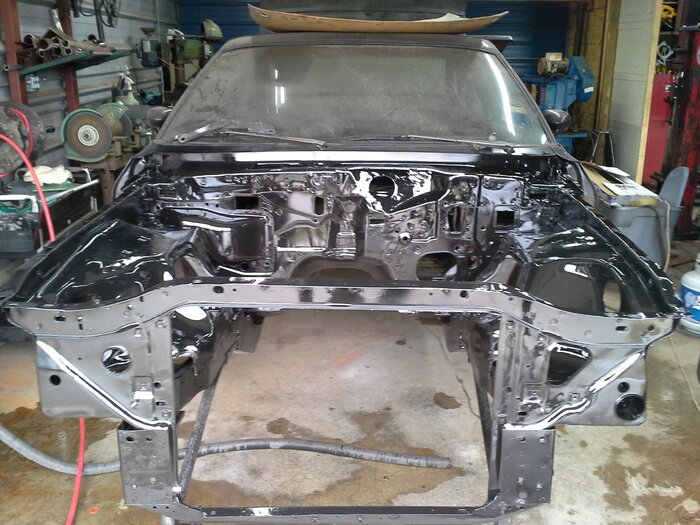

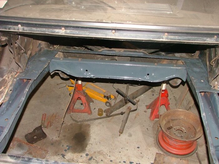

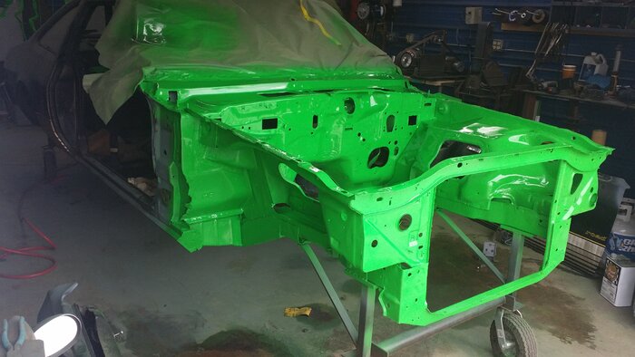

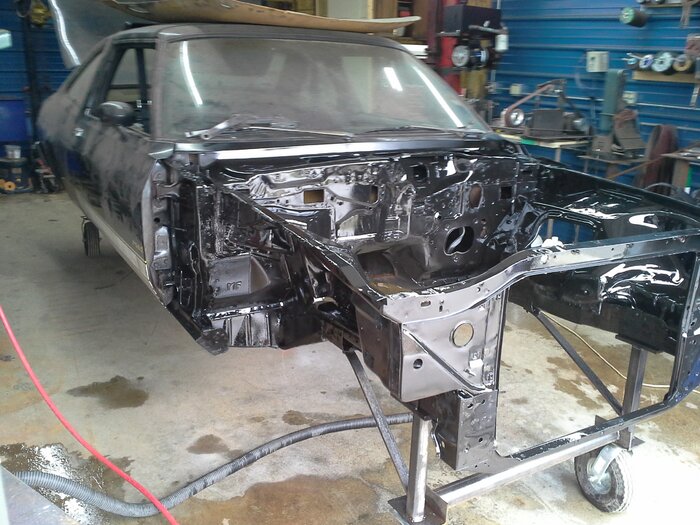

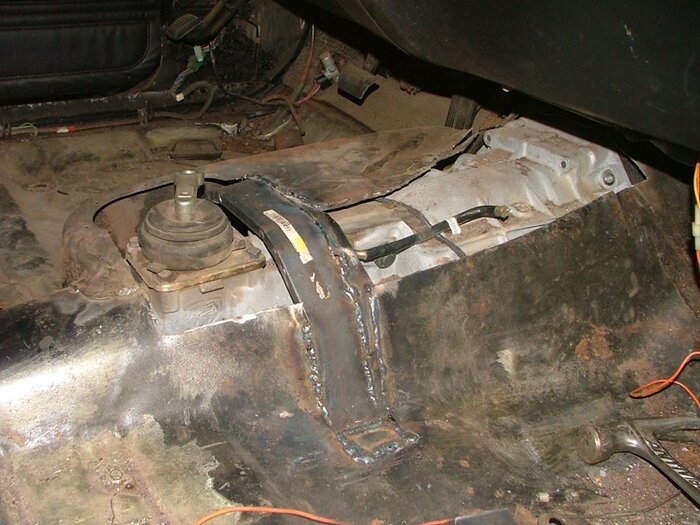

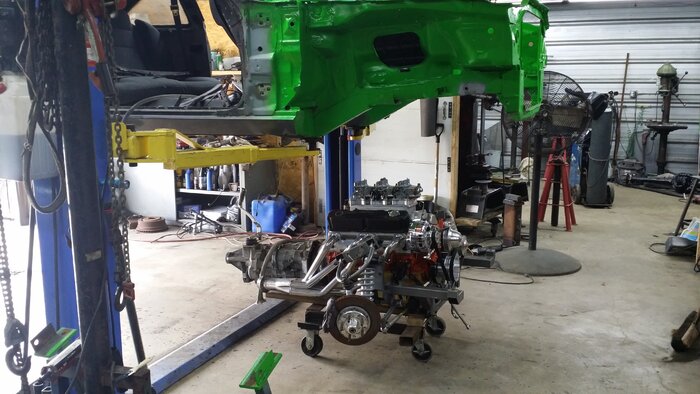

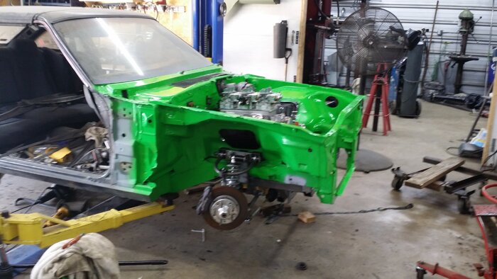

test fitting the new front end, if you look close you can see the frame rail repairs if i can find the pictures I will post them also

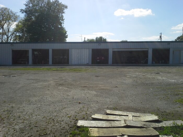

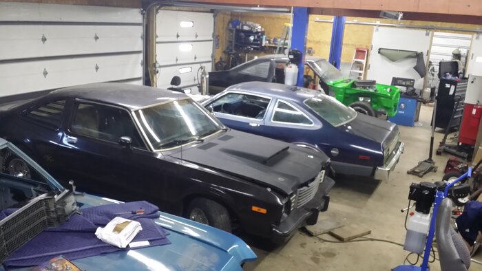

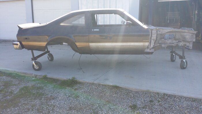

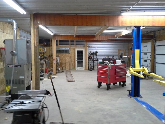

jump 4 years forward as I got tired of working in a 2 car garage set the roadrunner in the inclosed trailer no 2016. Roadrunner was not still main project as we had to convert a store and lock into a shop, still along way to go but much easier
to work at.

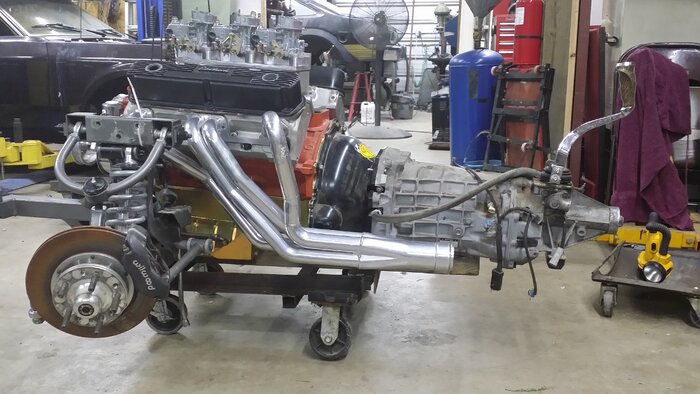

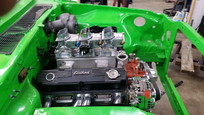

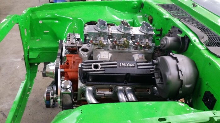

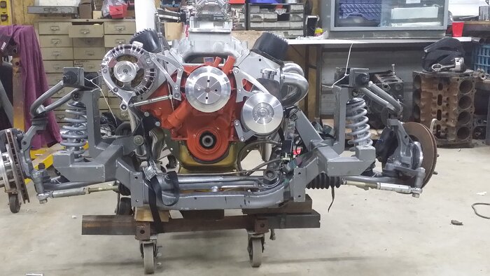

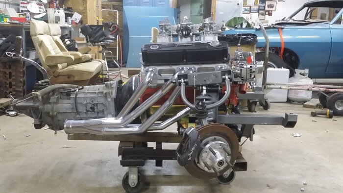

engine, transmission and alterkation ready for install[
ATTACH=full]43363[/ATTACH]

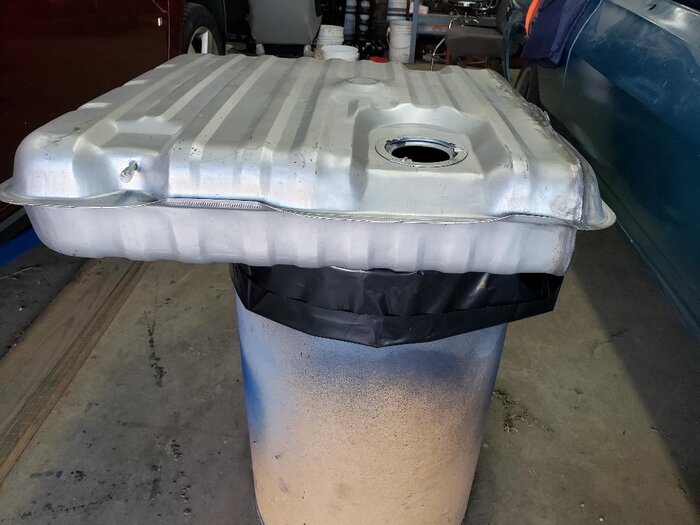

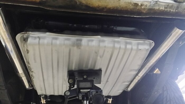

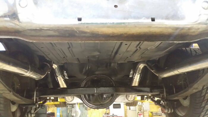

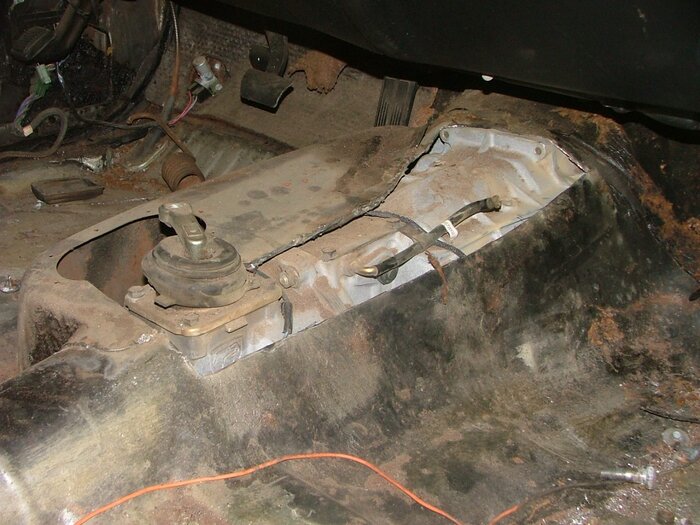

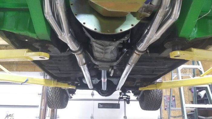

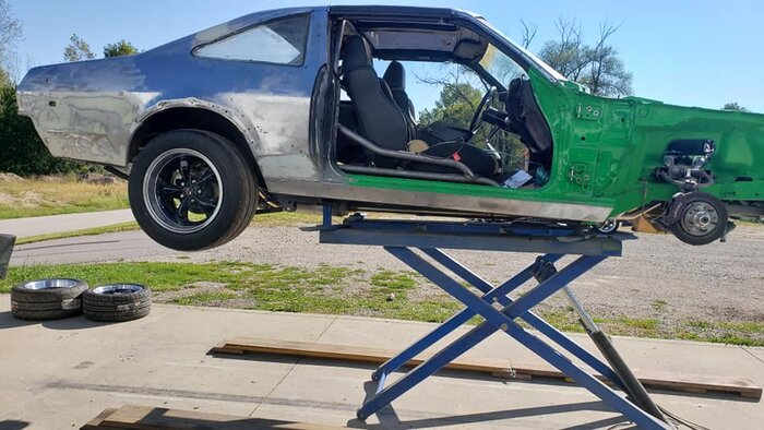

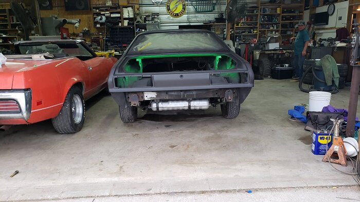

new full 3 inch exhaust out the back. had to cut 6 inches out of the fuel tank, and planning on notching the rear bumper and have 1971 roadrunner tips
george cobb
Mar 28, 2020
42
97
ohio

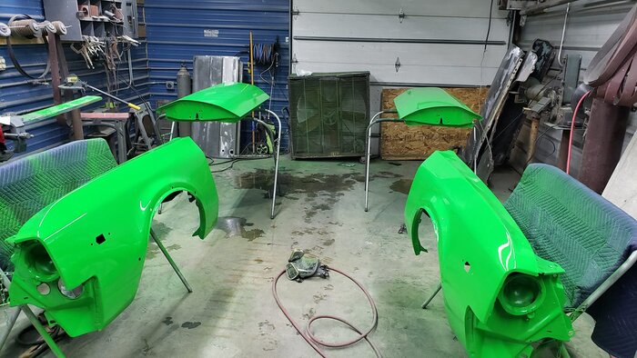

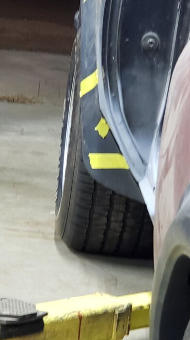

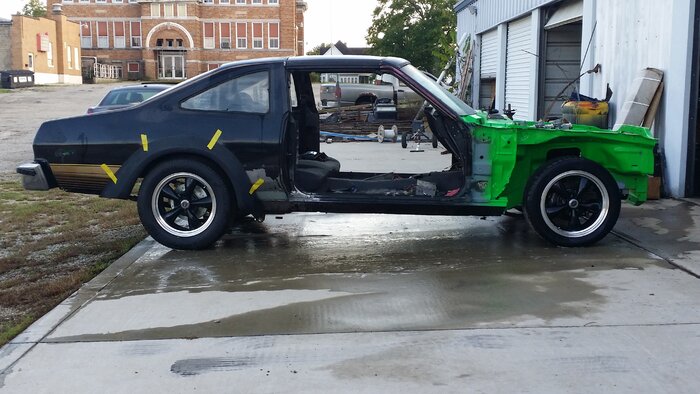

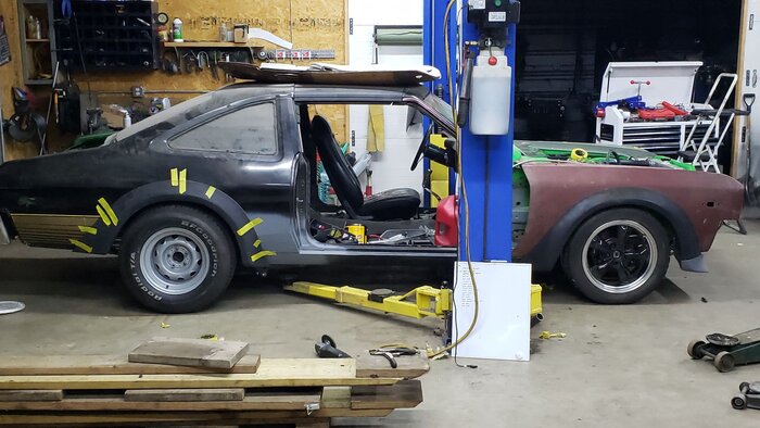

decided to go the with the super coupe flairs nothing like bending up 2 NOS fenders

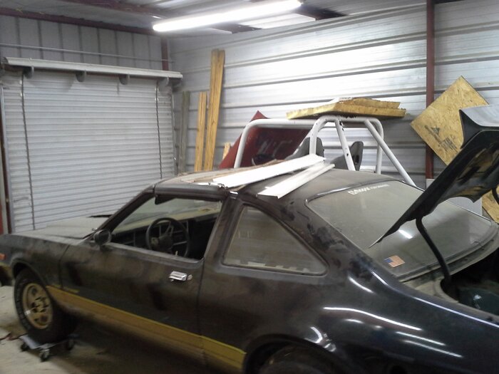

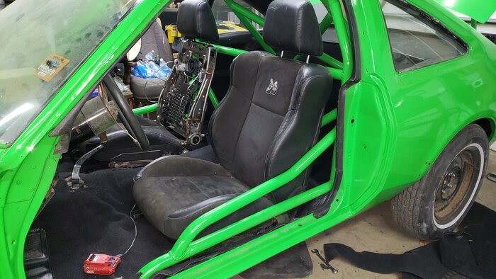

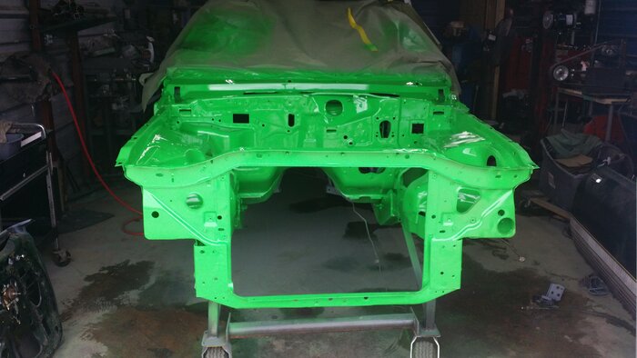

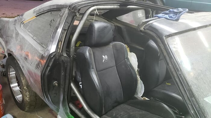

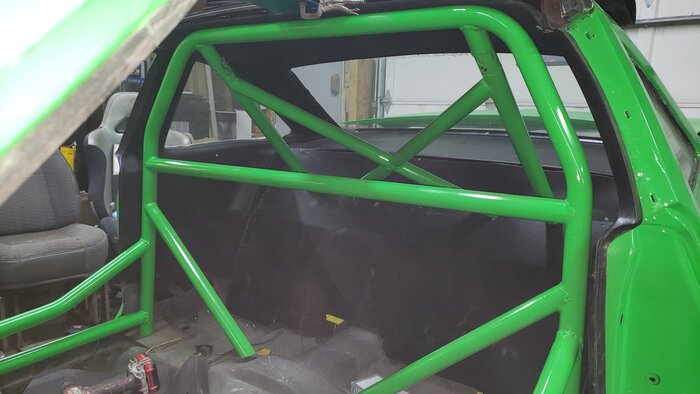

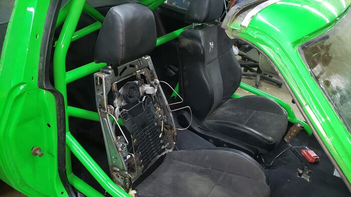

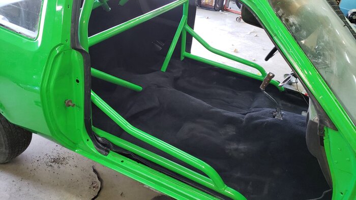

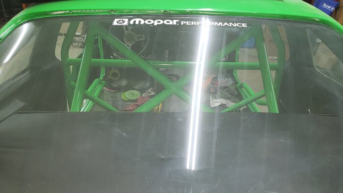

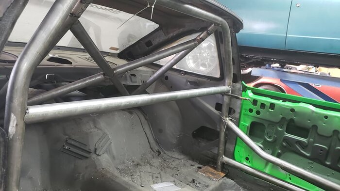

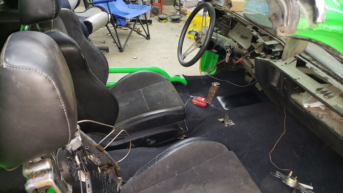

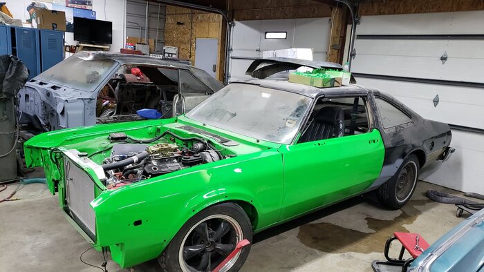

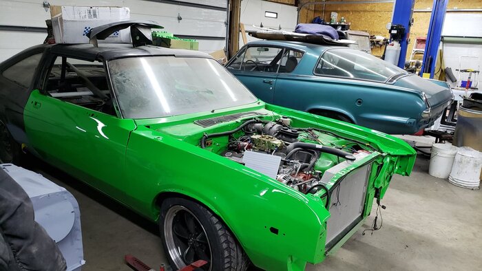

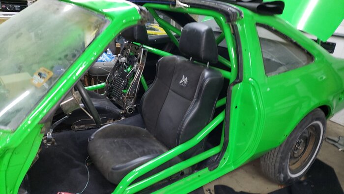

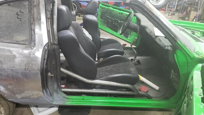

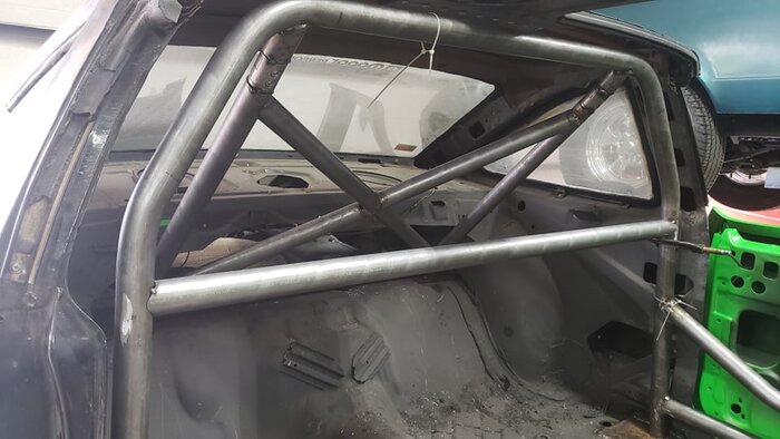

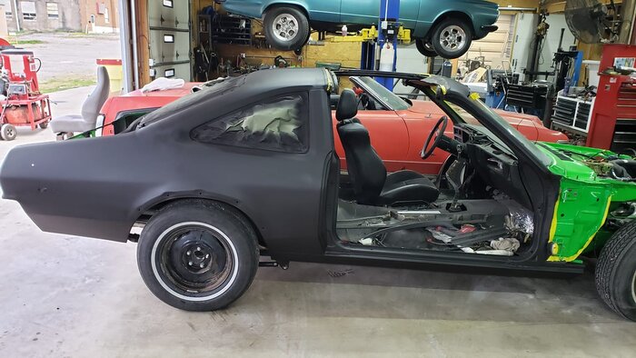

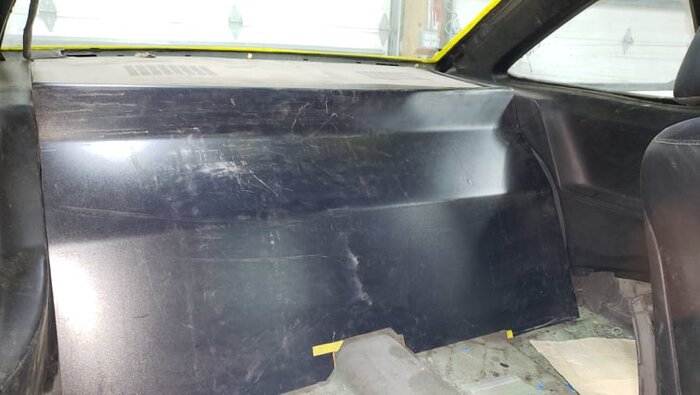

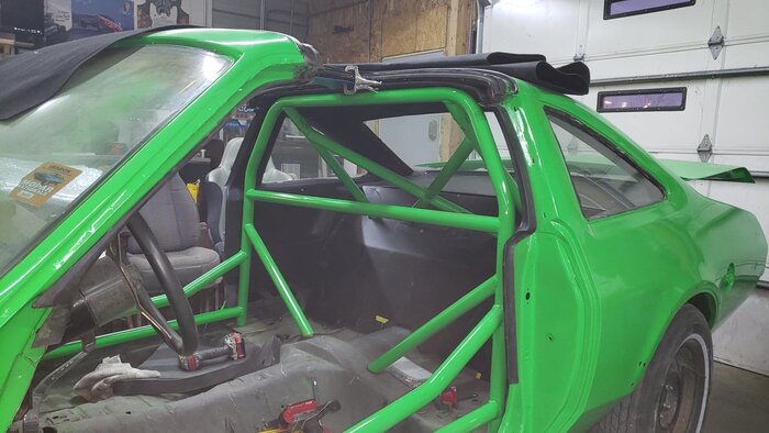

got some more work done. SRT seats are went in really easier than I had expected, Roll bar is fabed up should help the body flex. and got the body in its first coat of primer a little more to finish but not much
