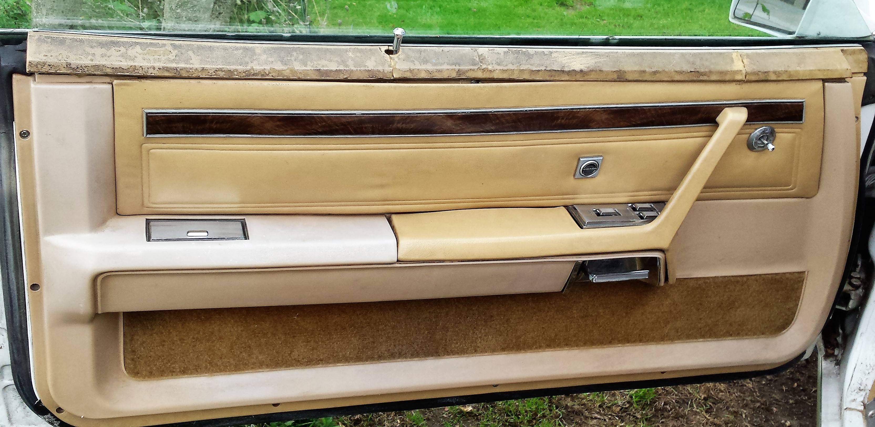

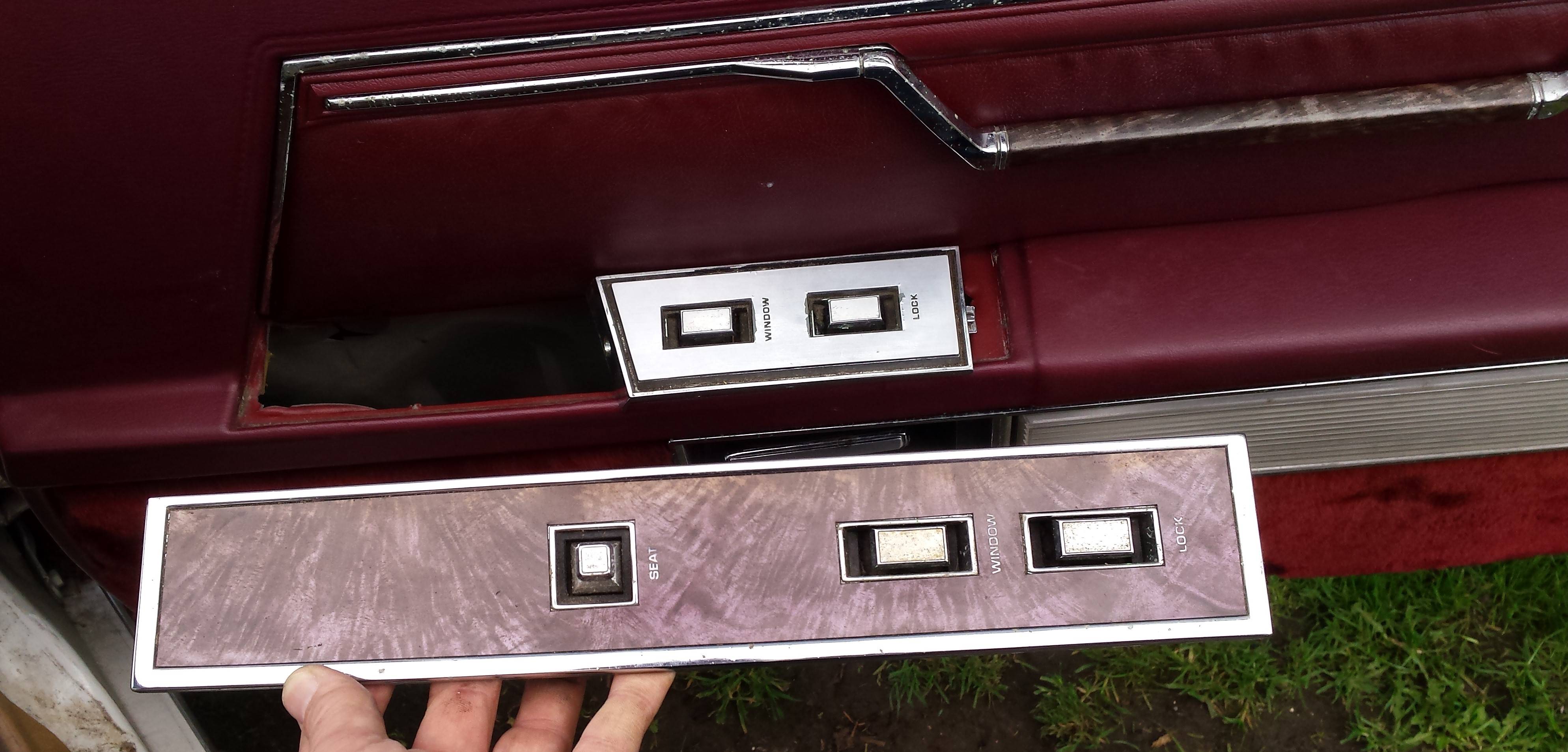

heres what im doing with my interior colour change.
the imperial door panels are a much higher quality and are 1 piece.
ive never seen any that split or crack, but the door pull handle trim is weak where they attach.
im going to have to trim the ends of the rear seat side window molding where it meets the door.
i also will have to decide what to do with the pw switches and figure out how to make the door lock knob pulls work - you can see they at the outer end of the door panel.
mark

in your pictures, the yellow door panels, picture 20141018_170355.jpg, the wood grained plastic at the top of the door panle is what I am talking about. My 1982 Mirada has that (colour of the wood grain is different, I don't know if it is due to sun fade, different wood grain pattern that is on imperials only, etc.). The UV damage is very much the same, and is the same type of damage that is seen in all J bodies (I can't say if it occurs on M bodies or F bodies, as I don't have any of those cars)/ Also note, that the same door panel has a Mirada emblem on it, which shows that the Miradas did indeed have the wood grain trim.
The color change that you are doing is close to what I am going to be doing with my base Mirada (the one with the wood grain). In my case, the door tops are going from the cracked woodgrain plastic to the solid colour yinyl tops. I won't have the door lock knob position issues, as the solid colour door tops are also from a Mirada.

thats not woodgrained plastic on the door top, its nasty discoloured yellow tan plastic the same nasty colour as the rest of the interior !
i will prob start a post about the imperial door panel swap, but not until the car is out of winter storage......

Yes, it IS faded wood grained plastic. It is so faded that it may look yellow, but that is exactly what the faded wood grain door tops end up looking like. The vinyl or door panel colored tops don't crack like that (actually, from the two examples that I have, they don't crack at all), and they don't have that splotchy colour thing going on either. Above all of that, the door panel coloured door tops also don't have the flat 45 degree bevel that is seen here (dead give away). As verification, check the Mirada sales brochures that you have with pictures of the door tops, and then, if you have a Cordoba sales brochure, check the the pictures for what the Cordoba's wood grained door tops look like. You will see that the Mirada sales brochure has door tops that are smoothly rounded over, and the Cordoba brochure will show a bevel (like your picture does).
